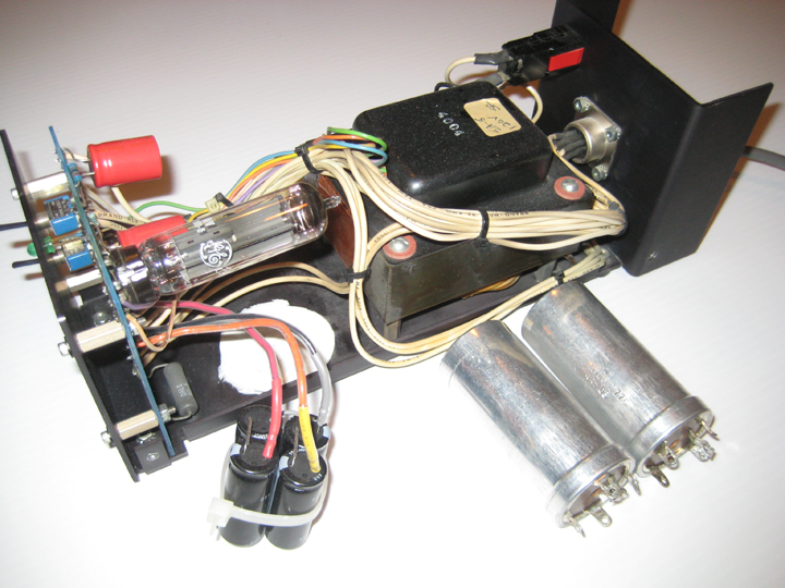

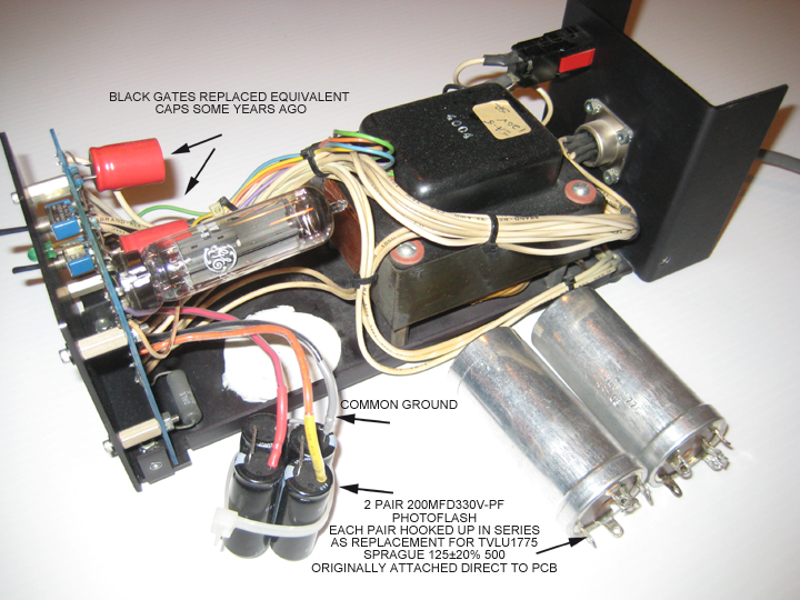

Hi Chris,
I thought I would send you pics of where I am using the Photoflash caps as I believe at some point I may have misinformed you where they were going.
The original caps in the PS were the "can style" as shown.
It was within a few years of my purchase of the preamp that the cans were replaced with Photoflash caps. You can see where they were siliconed to the bottom of the PS. (A group of 4 caps in a plastic cup!) As mentioned before the Photoflash caps lasted a good 15 or more years.
As mentioned before, once I started having problems with the preamp I figured those Photoflash caps should be replaced with a new set. Realizing now that is a "no no" I will replace them with caps recommended in previous posts.
Now knowing which caps I am replacing I believe it is "radial" that I need, correct?
I have retested the 6JC6A currently in the preamp and it is strong as ever. I don't see any arcing in the dark when I turn the preamp on, but will keep a close watch on it. I don't think I have had the cover back on since this whole affair started. Sheesh.
Of the 5 that I put through torture, 2 read outright short and the other 3 in the replace/reject zone on my tester. I did try looking at them all in the dark while testing them to see if I could spot something. Nothing that I could identify unfortunately.
Might I be able to use a DVM between different pins while they are out to give me short results?
Check out the pic with the submarine and barge size resistors. I laugh each time I see them!
Thanks again for your help!
Ed

Hi Ed,
That poor, defenseless preamplifier! It seems to be in good hands now as you represent a restoring force. I can only assume that the previous work was done with the intentions of improving it in some way. BTW, the leads that run from the PCB to the group of radial capacitors would have reduced any possible improvement to zero or below.
I don't see any "photo-flash" capacitors in either of your pictures. I do see a pair of orange coloured capacitors that I don't like the looks of. Put those on the list as well. The aluminum cans are called "can capacitors", or "multi-section can capacitors". The others there are "radia"l types, the leads attach off axis on one end, or radially. The picture of the audio chassis show what are called "axial capacitors", the leads attach along the axis of the part.
I have some medical stuff to do, but when I get back I'll have a look at a stock SA-5 to refresh my memory. I'm hoping to give you some direction. Remember, the best parts for the job are the ones that fit. Tell me, why was the resistor replaced on the main PCB? I'm going to strongly recommend that be returned to normal as well. This type of service you don't need in anything you're going to keep.
The situation with the 6JC6A needs clarification I think. It appears as though someone was having problems figuring out a power supply issue in the past. It's at that time that the 6JC6As may have been abused. Just a thought.
See the rectifier tube in the power supply? I think there may be issues with PCB tracking and shorting in that area. Since you will be replacing parts on that board, at the same time you should do this work. Pull the tube socket and locate the traces for the heater. Cut those traces at both ends so they are not connected to anything, then run wires from the heater attachment locations (from the transformer) directly to the pins on the socket, or the traces directly at that location. This will eliminate that problem. If you should see any evident that tacking may have occurred, remove the tracks with a dremel tool or knife. If you remove a lot of material, replace it with epoxy (not the conductive type!!). I have had to cut away right through the PCB to remove the carbonized areas of circuit board. Then the hole was filled with epoxy. I used oiled plastic panels (old CD case) sections to support the epoxy and give it a flat finish. Once the plastic was removed, the patch only required a little detail work. This is the same method used on Bryston 4B PCBs and a few others that decided to burn right through.
When you are done, the board and components should look close to factory condition with components seated properly on the PCBs. There are reasons for this, and reliability is one of them.

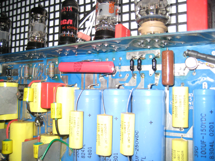

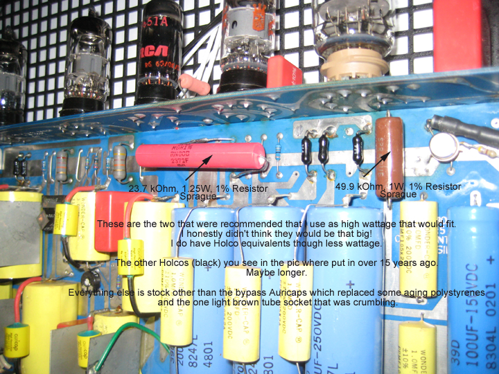

Hi Chris,
(Preamp part)
I replaced the 49k9 resistor (big brown one) as it was definitely showing signs of deterioration. Recommended in the threads was to also replace the 23k7 as well. Advice was to use as high wattage as possible for heat dissipation. Geeze I didn't realize how big the resistors were until I received them. Guess I went overboard. But they did fit. I do have Holco equivalents though not that high wattage. Perhaps I should look for something midway...
(Power supply)
I'm not sure if the orange pair of resistors you see in the power supply are the blackgates I put in when the original resistors burned out. They are equivalent in value to what was in there before. Hope okay?
The quad of caps you see attached by wires and currently sitting outside the power supply are Rubicon Photoflash. Guess these are the ones I should start with replacing pronto!
Hope all goes well with your medical treatment.
Thanks again for all your help.
Will try not to blow things up before you return. No promises though!
Take Care,
Ed

Hi Ed,
Yes, the parts in the power supply. Those are capacitors, aren't they?
Once a part becomes too large for the space, it also becomes a liability. What they should have told you about resistors is that you should only ever need to go up one wattage size. You can easily find out what your actual dissipation is. Measure the voltage across the part, then figure out the current flowing through the part. Multiply the current by the voltage and you have your dissipation. Oversizing by a factor of three or a little more should be just fine. Certainly, make sure the parts do fit. If they don't, get one that does.
Those 1% parts are completely wrong. Use 5%, Metal Oxide resistors. They will be much, much smaller. What you have installed there is a complete waste, plus they don't fit. What you see there is a great example of what not to do. I have to say that those resistors were probably expensive, but inferior in that application to the Metal Oxide types.
Black Gate caps .... In my view, a total waste of money. Find something that fits the mounting location.
-Chris

Thanks Chris,
I ordered those resistors to match the needed values, without checking the size. Lesson learned! They weren't expensive. Shipping was more.
I had nothing else to put in there, other than doubling up of some low wattage smaller resistors temporarily to match required values.
Oh Boy. It's Screw-It-Up Yourself Asylum for me!
Will fix those up as recommended.
Again, thanks for all your help.
Ed

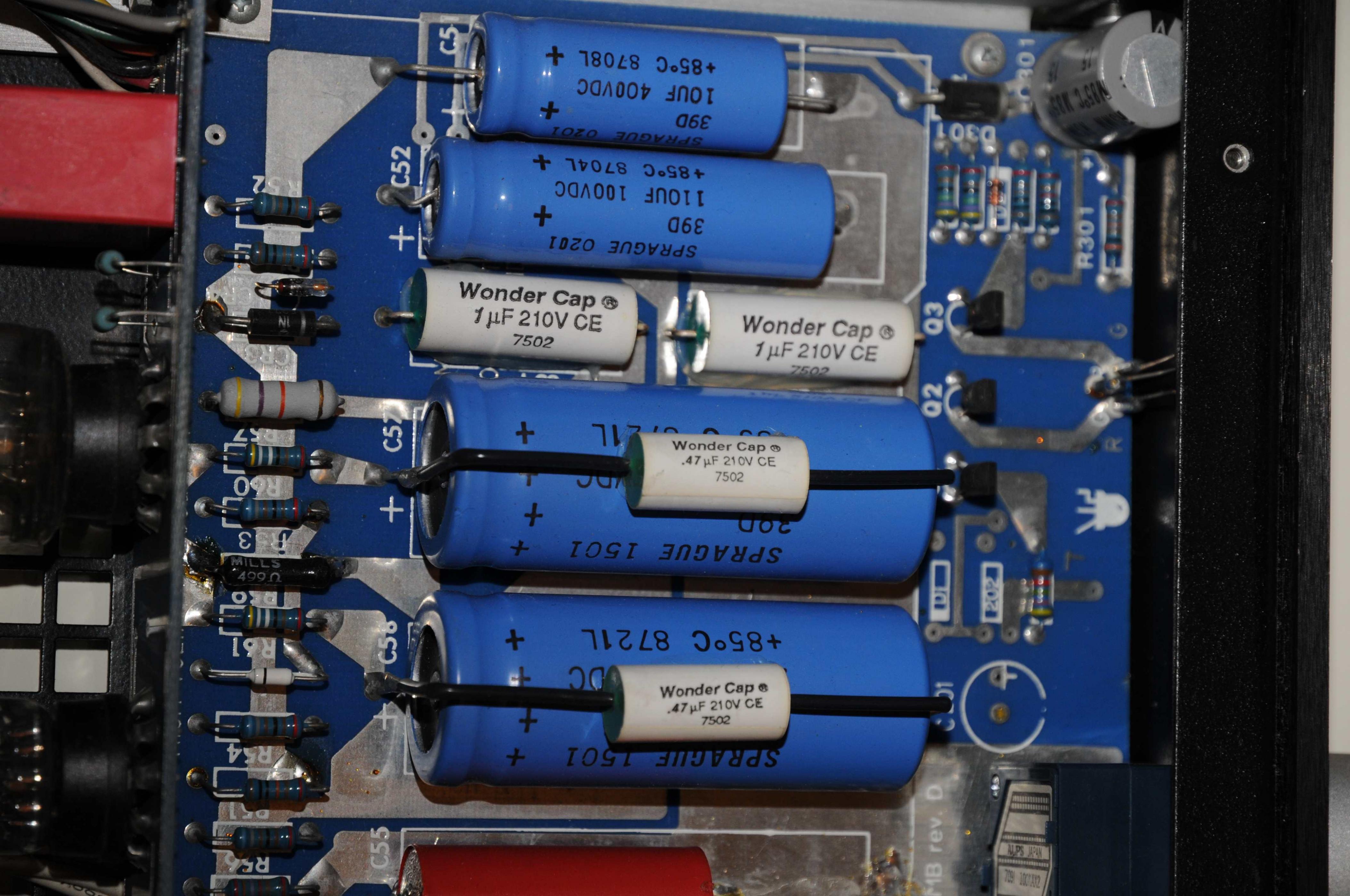

I have a Conterpoint SA-5.1 and i am looking at 2 resistors values: located between the 6GC5 tube and the big red capacitor ( 1 UF ) on the vertical pc board.
These resistors are connected on the filament heaters and i don't know where.
They are burned.
If you can tell me the values, it will be appreciated!
By the way, is your schematic available?

If you mean the heater supply for V7 (6GC5) & V8(6CA4) then these are both 10k 0.5W 1% resistors. They connect each 'side' of the 6.3VRMS filament supply to the +260V output voltage of the B+ regulator.I have a Conterpoint SA-5.1 and i am looking at 2 resistors values: located between the 6GC5 tube and the big red capacitor ( 1 UF ) on the vertical pc board.
C55/C57 and C58 are the axial leaded electrolytic caps that decouple the second stage phono, and line stage A & B, respectively. These are 200uF/250V and they have 250V across them. Good eh? Replace with the next available voltage rating - probably 385V/400V.
Hi, I want to replace these electrolytic caps with film caps. The bigger caps are 200uf - 250V and the smaller ones on their top are 0.47uf - 210V. Up to this thread I thought that 0.47uf's are what I need (to replace the whole). But I'm confused now, what caps should I buy?
The big blue Sprague 1501s are electrolytic capacitors.Hi, I want to replace these electrolytic caps with film caps. The bigger caps are 200uf - 250V and the smaller ones on their top are 0.47uf - 210V. Up to this thread I thought that 0.47uf's are what I need (to replace the whole). But I'm confused now, what caps should I buy?
The white Wondercaps are film caps.
If you replace any of the power supply capacitors, you need to choose capacitors with a voltage rating greater than 260V, preferably greater than 300V to give you a safety margin. The original capacitors in this unit run at or below their rated voltage which is not best practice
Thank you for your help, but l'm afraid l need more.
ln some photos of upgraded SA-5.1 units l see caps like 150uf - 350V and no 0.47uf's. What's the purpose of 0,47uf's?
AFAlK, in the original design C55, C57 and C58 are identical caps. But after upgrade my C55 cap is something like 8uf - 415 (not sure, since writing this message from mobile). Not 150uf, not 0.47uf. So l'm confused
No problem, I understand what you are looking for now.Thank you for your help, but l'm afraid l need more.
The 0.47uF are film caps which bypass the electrolytic caps. The aim is to improve the high frequency performance of the bypass. Depending on the actual choice of parts this may or may not be true in practice.ln some photos of upgraded SA-5.1 units l see caps like 150uf - 350V and no 0.47uf's. What's the purpose of 0,47uf's?
It is understandable that you are confused. Whoever 'upgraded' your preamplifier did not use the original value parts. This is usually done because the part fitted is all that was available at the time and it fits the chassis. If I was cynical, I would then say that the change in value is then justified by some nonsense about how it is an 'upgrade'.AFAlK, in the original design C55, C57 and C58 are identical caps. But after upgrade my C55 cap is something like 8uf - 415 (not sure, since writing this message from mobile). Not 150uf, not 0.47uf. So l'm confused
In the original C55, C57 & C58 are all Sprague 200uF/250V caps. The voltage rating was inadequate as the B+ rail sits at +260V and often higher at startup. Although under-rated, the caps are of good quality so they do take a while to die. If you are replacing them, then choose an axial leaded electrolytic, rated at 300V or higher, of a suitable size.
I do not have a SA5 anymore, so if you measure the cap size then I could make a suitable recommendation.
Each of the electrolytic caps (C55/57/58) were bypassed by 1uF/200V Wondercaps (C59/60/61 respectively). Again the voltage rating is too low, so if you are replacing these caps then choose something with a voltage rating > 300V.
