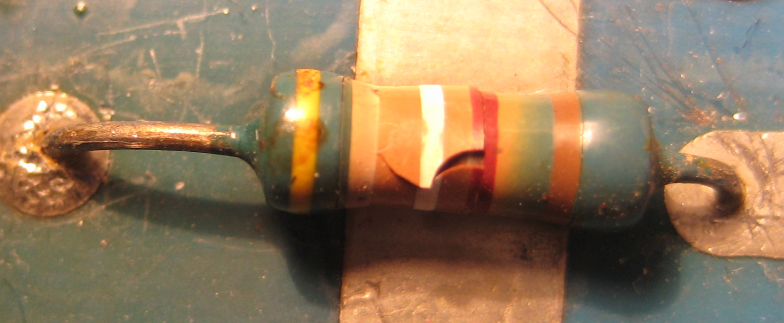

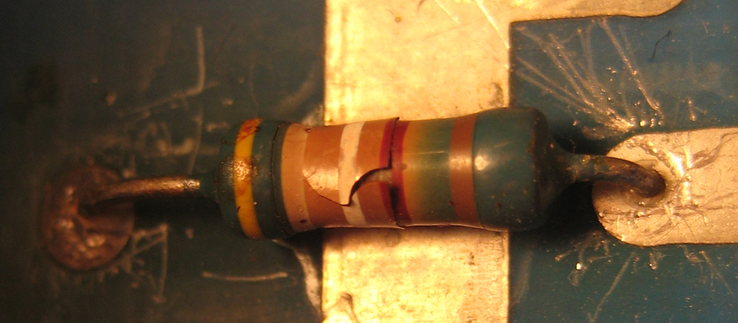

Culprit Resistor?
Well this fellow looks and reads nasty on my DVM. Unfortunately can't quite make out all the band colors? Yellow White White Red with Tolerance Brown? Or Yellow Brown White Red with Tolerance Brown? Or...??? Help!
Thanks in Advance!
Ed

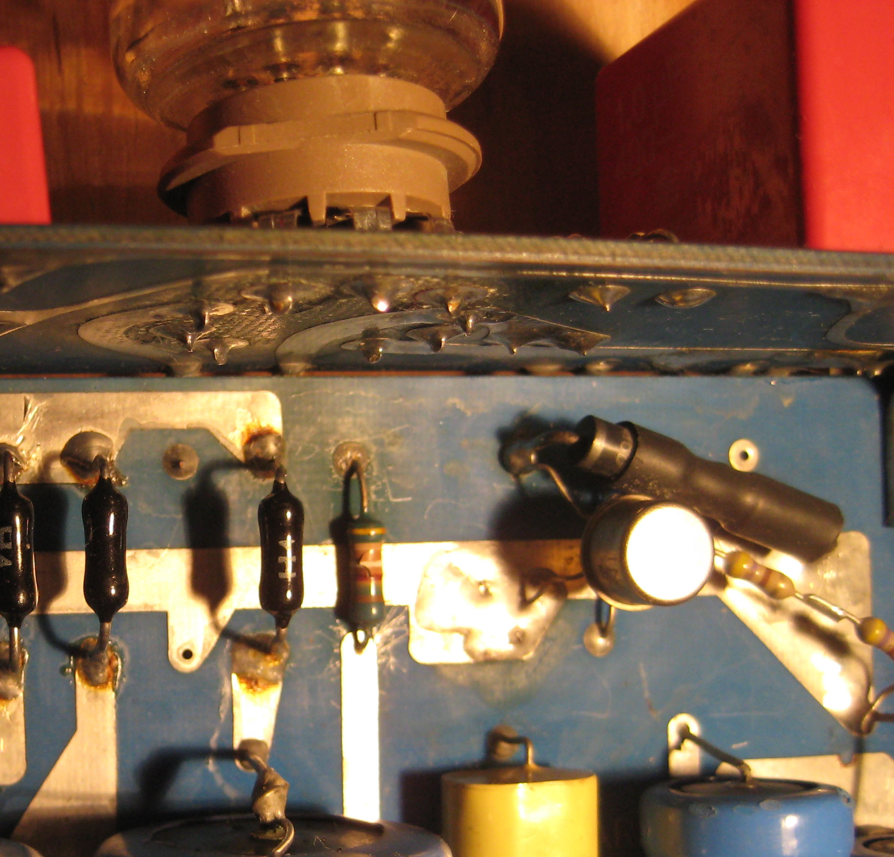

Things are looking up!
My best guess for the resistor was 49.9k 1%.
As a quick fix I put together 2 x 22k 5% (44K total). The 5651 tube didn't come on before the warm up LED completed it's cycle, but it did eventually come on (within a minute after). It wouldn't come on at all before.
The other things such as the zenor diode checked out okay. And no leakage between pcb traces detected in the dark. (Checking things in the dark were eerie and cool at the same time!)
Will keep my eye on things.
Thank you for input!

They didn't give us any PCB layout diagrams for these units. So, the best I can do for you is to attach a picture of one I had repaired. I have cropped the photo down to the area you are working in.
When working with high voltage on circuit boards, clean is what you need. That's one reason I keep my work clean. The other reason is that I can see if anyone else has been in there. :devilr:
Can you do me a favor and trace the resistor to where it connects there? One end will go to one or more components and the other end will do something similar. For example: one end goes to pin 5 on V5, pin 1 on V6, positive end of C52 and the bypass capacitor across it and the other end connects to pin 1 of V7 and many other parts, like 3 499 ohm resistors, the positive end of C56, and more. This would be the cathode of the pass tube, in other words, the output of the regulator. There are some decoupling resistors (499 ohms) between the gain stages and the regulated output. I can try to figure it out exactly from there.
As for the voltage reference tube, it will only light up (strike) once the DC output from the regulator has exceeded the breakdown voltage. So there is a delay there. Due to the high amount of capacitance across that tube (bad design example), and it's series resistor (182 K), there is an additional time delay before it strikes and glows. You should see between 82 and 92 volts across the voltage reference tube if it's operating okay. The regulated output voltage should be around 260 VDC. That will "bite" you if you contact any part of that circuit.
If you look at the component that appears to be a small can in parallel with a larger axial leaded diode, you should be able to measure a voltage drop around 45 VDC. It must be below 90 VDC by a comfortable margin, and above 10 VDC. The metal can device is a constant current diode (breakdown around 100 VDC), and the diode beneath it is a 91 VDC zener diode (1N5378). This measured voltage will rise and fall with the AC mains level, so you need to get a sense of what the average is. You can change this voltage by replacing the resistor in series with it. The nominal value will be 75 K ohm, but it may likely be a different value also. Increasing the value of that resistor (Say ... 82 K ohms) will lower the voltage across the current diode. You can figure out the drop easily enough. The CCS diode should be close to 1.6 mA. Ohm's law, figure out the drops in that circuit.
So, trace away please and I'll try to get you some answers. The continuity function on some meters make tracing easier.

The burnt resistor is R57. It is 49k9 so you were quite correct.
R57 and R58 (23k7) form the resistive divider that feeds back a portion of the output voltage of the regulator to the 'error amp' whihc is V6 (the 6JC6A).
The output voltage should be ~ 260V, so R57 has ~ 2/3 of 260 or 173V across it. It dissipates 0.6W steady state. The original part is a Roederstein MK3 rated at 0.6W so it was always going to fail ...
You want to replace this with a much higher power rated resistor. Personally I would be looking for a 5W part. And replace R58 before that dies too.

I think that 5 watt resistors are too large here. I'd really suggest something more in keeping with the space allotted on the PCB for these parts. As a major service center in Canada (near Toronto where tons of these were sold), we never did see this problem. Other issues - yes! These do run hot, but they seemed to last. Note that I agree that these are undersized. Holes drilled through the PCB under these resistors would have been a good plan, about 3/8" in two rows. Avoid hitting traces for obvious reasons.
Hi leviathon,
If Metal Oxide resistors were used, and stood off the PCB by about 1/4", R58 could be replaced with a 1 watt unit. If a 2 watt metal oxide resistor fits, use it. The dissipation will be around 0.3 watts, or 1 / 6.67 of the rated dissipation (assuming a 2 watt part). No problem there. R57 would work okay with a 2 watt metal oxide resistor, or you can go one step up to a 3 watt part.
I think Dale, or one of the US manufacturers make a 3 watt resistor sized as a 1 or 2 watt part if you are stuck for space. That will be a wire wound part - so slightly inductive. The common ceramic "bathtub" 5 watt resistors are too large for this application, and they are also wire wound.

On reflection I agree however the reason that these parts lasted so well is not because the part is adequately derated but that Counterpoint used high quality parts. Since the target value is basically 50k, I would use two 100k resistors in parallel.
Compared to the 44k already tried, that would raise the output voltage of the regulator and probably get the 5651 voltage reference tube to 'strike' a bit quicker.

The reason these lasted well is that it's amazing how badly you can abuse a part before it fails. Counterpoint power supplies are so badly designed that I was completely blown away once I first began investigating these problems. In fact, the act of properly repairing a Counterpoint power supply is actually a process of examining the design as it was produced, then back tracking through the errors until you get to the original design error. After that, you are in a position where you can fix the original issue and clean up the "band-aide fixes" that culminated in the production model. In every case I have looked into, the redesign is not only reliable, but also generally performs far better.
In one power supply, my redesign also resulted in a 3 watt decrease in power consumption! That's 3 watts less dissipation that would work towards accelerating parts aging and PC board damage. Oh, that was 3 watts per channel! It also reduced the ambient temperature inside the case, solving some other issues. These poor designs are actually a series of poor decisions that just happen to work for a while.
Actually, you are further ahead using a single resistor instead. You can easily get away with a 51 K resistor and 24 K for the other. This will shift the regulated voltage a little, but not enough to matter. Look at how variable the reference tube is for it's actual voltage. If you want to make it exactly 260 VDC, I'm sure you could tack a resistor across whichever resistor needed to correct the voltage. Of course, this will have to be redone if the 5651 is replaced, or through aging. The fact is that the actual voltage doesn't matter as much as any noise or drifting does. It's the short term stability that matters more than anything else. Also remember that the quality (or condition - leakage) of C52 and C53 will have an effect on how quickly the firing voltage is reached. R55 (182 K) may have drifted up in value as well, so check that. In any event, the 5651 will always take longer to strike as everything else has to warm up and be running before you will see enough voltage for it to work. It's really a voltage limiter if you want to look at it that way. So, don't worry about how long it takes to strike. Slow and gradual is better than the voltage shooting up, then over shooting a lot as it drops into regulation.

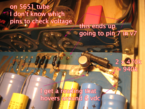

more pics and questions
Hi All,
Sorry for late return. Had to get some brownie points around the house first... :)
Thank you for the in-depth information. One of the most interesting things I am learning is as things age, an identical part swap may not be the best thing to do. Instead use parts as required to have the end result meet spec. Unless of course you do a total rebuild with all new parts from scratch!
Good to know that it is better for the 5651 tube to take longer than shorter to turn on. I may even try building the "relaxation oscillator".
I am going to replace the resistors as recommended and appreciate all the variations to consider for best results.
I must admit this is the first time I have ever measured anything while "on" and appreciate the heads-up regarding voltages. The only thing I do that comes close is biasing tubes in my power amp... and ooh boy... touching the wrong thing even with my DVM leads is an eye opener.
(Embarassed) I don't know how to measure the voltage of the 5651 tube to see if it is correct (pins?)

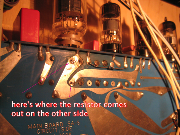

I have attached a couple pictures. One shows the "temporary" set up the 2 resistors replacing the burned one, including that it goes to pin 7 of v7. Also shown is where I measured around the "can" and am getting a reading of around 6 volts which if I am measuring correctly may be out of the recommended range? Also showing the 2 resistors paralled to the "can".
Am totally lost trying to trace? I need a GPS! I have attached a photo of the other side of the board showing where the replaced resistor leads come out. Now knowing the value of the resistor, maybe I don't need to do any more tracing? If not, I will take a few breaths and give if another whirl I necessary?

Administrator
Joined 2004
Hi Ed,
It's best to simply measure the output voltage. The voltage regulator tube is a higher impedance point and may be sensitive to added capacitance. The effect your meter will have would be a momentary drop in supply voltage as your meter charges up. You really don't want to do that, do you? :)
I'll have to look at one to figure out that resistor value for you. Anyone who knows off-hand is free to chime in here, I can't remember.

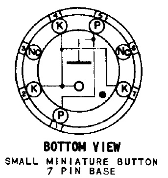

Don't be. It is always a good idea to ask before poking around a working high voltage circuit.
You can measure the 5651 valve plate to cathode voltage directly, provided that you have a high impedance voltmeter. A typical DVM will be 10M or more. If your DVM not auto ranging, select a setting that allows for 300V.
The base pinout is attached. Measure between P and K. The reading should be 85-86V

Administrator
Joined 2004
Hi Alan,
Thanks for posting the pinout.
If you have an auto-ranging DMM, you'll want to put it into manual and at the correct range. The loading can cause really large spikes in the output of the regulator in auto mode, repetitive spikes as the meter adjusts it's range. Also, it depends on the input capacitance and coupling of signals. Since this is the reference to an active amplifier, you want to take more care probing around. If you are unlucky, you can cause an oscillation that then causes other components to fail.
I strongly recommend that you measure the output of the regulator and go from there. If it's correct (in the right range), you don't have to poke around the reference.
There are 499 ohm resistors in series with the different sections, so if you lose B+, check those first. Also, don't run the unit with any tubes removed. There are some models where the plate coupling capacitors are not rated at a high enough voltage. No tube means no current draw. That impresses the full B+ voltage across the coupling capacitor. Not good.

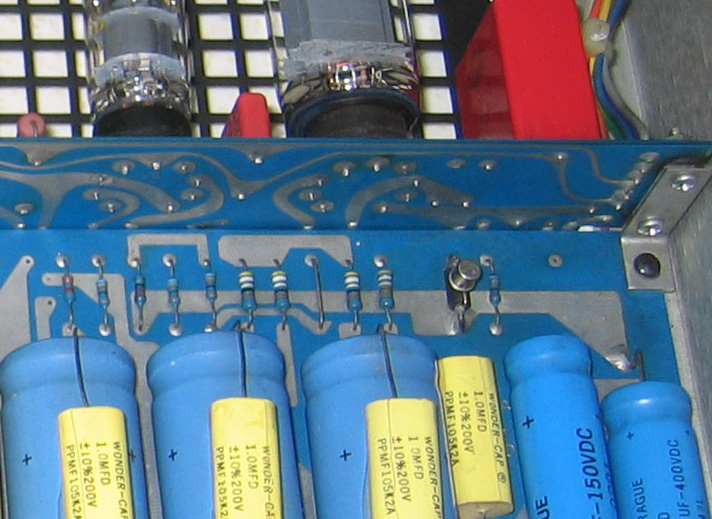

Thought Victorious, But Back In Trenches
I've reorded some smaller resistors for better fit. Though sticking to decent grades like Caddock and Holco.
Along with the first batch of resistors, I also ordered some Photo Flash Capacitors. This is what had been running in the unit since mid eighties or so. (I had had a problem back then, and the gentlemen who sold me the preamp was a service guru as well. He siuggest replacing the 2 100 uf cans with 4 200 uf Photo Flash. 2 for each side as it were.)
So one of the other things I thought I could replace on the cheap were the caps. The minute I tacked together a quick set up, I couldn't believe how quickly the 5651 came on. Woo hoo. I was going to post right away, but figured I would neatly assemble everything back together.
Wanting to work on it right away, I drained the caps with a 1M ohm resistor as I had read best to drain before tinkering around. Well, once everything was tucked back in, dang, now the 5651 again takes a few minutes before it comes on. I thought maybe I had destroyed the photoflash caps with my draining method, but as I always buy extras, quickly set some more up again. (I am running outboard caps next to my power supply on a piece of plywood! Look like a made scientist!). Result was no different, but at least the 5651 eventually comes on.
The only thing I am noticing now is, if I turn the preamp off, then on again, the 5651 strikes almost instantly. But not if left off for awhile.
The other thing happening is my 6JC6A's aint to happy about all this. Sometimes they glow really bright before they settle in. If they don't settle in, I test them, and they are definitely getting worn out by something, and need to be replaced. Have stocked up on them!
I did check the output voltage of the 5651, am getting a reading of 84.2 volts.
