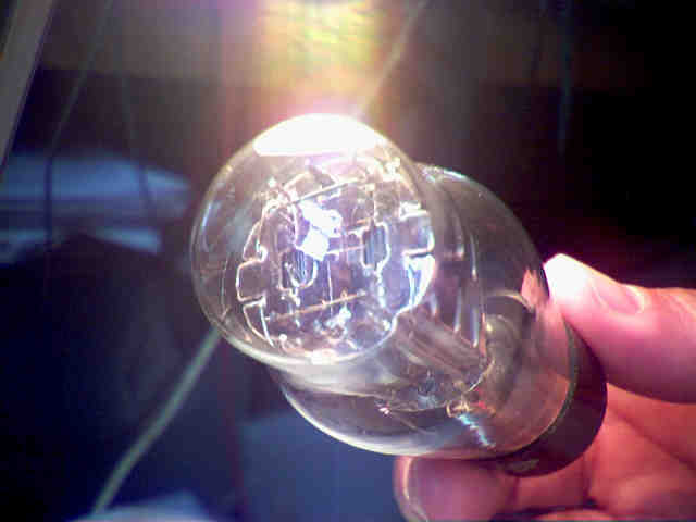

The 306A has got a 5 pin base and a plate cap. (The mystery tube has an Octal base and no cap.) The 306A does have one crucial aspect in common with the "mystery" tube. But the 306A is 5 times bigger and not too likely available for $3. The 306A datasheet curves do look quite good and it could well be a super linear triode. I don't have one to test here though. The mystery tube was a junk box dust collector, fairly obscure, I just tried it on the tracer one day. Totally amazed. I'm sure there are a bunch of other undiscovered wonder tubes out there yet.

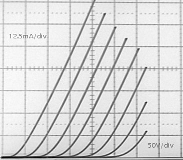

Edit: OOPs, Sorry, I made a goof on the mystery tube plot scaling data. It's plotted with 2 Volts per grid step, not 1 V. Mu of 10 then obviously.
That really is a very impressive set of straights (can't bring myself to call them curves!).
Straight curves or not if it is a triode it is not linear. Pick an operating point draw a load line. The straights (curves) are progressively closer together on the right side of the operating point and vice versa. The decreasing spacing of the curves means decreasing mu from the left side of the graph to right this is classic triode 2nd harmonic distortion.
BTW add a pinch of partial bypass to the cathode resistor and you can straighten any triode curve. Remove the bypass capacitor from a capacitor from a triode, if you put it on a curve tracer and the curves look like those of a pentode. Vary the value of the cathode resistor the rate of curvature will also change. I think that it is FM.
Also take a look at the old texts of pentodes turned triode. Convex curves of pentodes, concave curves of triode strapped pentodes and straight curves of ultralinear.
I would not be surprised if there was some of this Magic going on it the curves posted in this thread.

This russian triode-strapped little piece doesn´t look to bad either. Close to equal spacing. Pic by Hagerman.

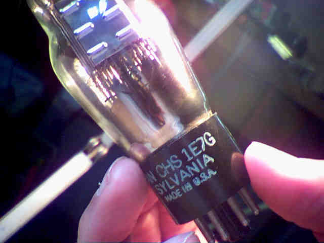

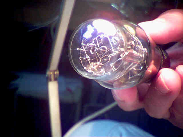

Ken, You got it!!
Imagine a dual pentode on an octal base back in the battery tube days!
Must be the fore-runner of the Compactrons. I had to parallel the two pentodes since the g2 is common to both.
