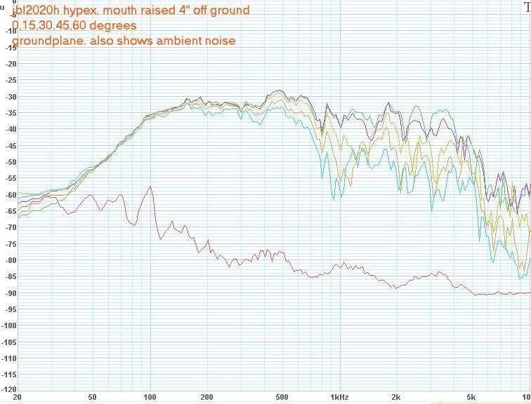

JBL2020H 80Hz hypex in the garden.

If the music room performance is all that counts why do you need a measurement 'without room' ?
Nor am I optimistic about "... well, you just subtract out the room response." Is there a way of doing so?
Yes - you physically remove the room by placing the speaker out in open space and measure there....

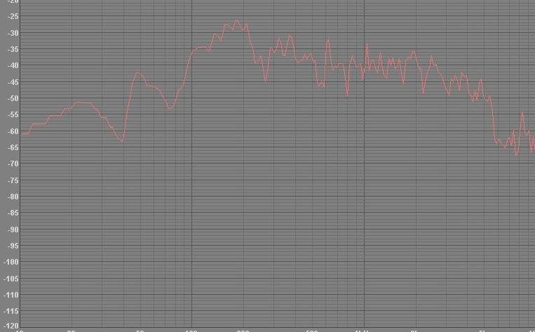

Yes, you have a fightin' chance of meaningful measurements in your living room with noise. Moreover, the 1/3 octave stuff I grew up with is crude and not great help in fine-tuning. Now I see you can do really fine work at 1/24 octave bands that produces a reliable (consistent, repeatable, fine-enough) trace. I am in your debt for that knowledge.
What I'd like to see now, is the relation of the indoors and out of doors "racquetball court" curves on the same chart in order to assess the value of collecting out of doors data. Does in-room variation swamp out of doors curves?
To operationalize a criterion, could you usefully set a bass equalizer from the racquetball curve?

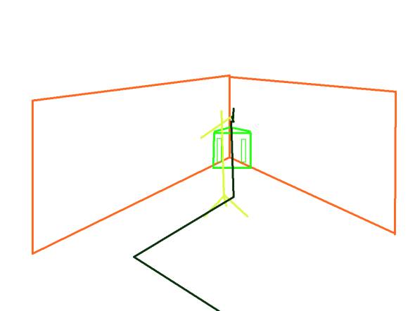

So basically all you want to do is EQ your klipsch to a 'flat before room modes' condition ?, but cannot as it needs the corners to function as a 'proper' horn, meaning the outdoor measurements are useless as the speaker will not work without the floor / walls to complete its horn flare ?
I understand your position now and why you was so 'put out' by Tom D's suggestions.......(and why you spoke about raising the walls with the speaker)
In your case I think you need to find 2 very high buildings that join at right angles. Get an in car amp and a laptop adapter / inverter so you can power the laptop and preamp / mic combo. This gives you a mobile testing station so you can drive out, stick the horn in a good test corner, and measure it. A standard mic stand should hold the mic in the right position (equidistant from all surfaces)

As a kind of conceptual test case, I am asking if equalizing based on an out of doors curve would be adequate. If yes, then I guess out of doors is useful. If not, then, not. To start with, what do the indoors and out of doors curves look like when on the same chart? I am just trying to formulate a test case to represent the words "Gee, the two curves are kinda' alike."
Earlier, and esp. in connection with Tom's posts, the question of economic feasibility (and structural feasibility) were raised. These are of the greatest practical importance and I'd like to learn more about the price for a 1/24 octave filter, time window, and whatever else is needed too.
But first, the conceptual test case.
