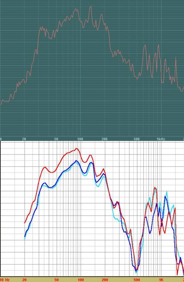

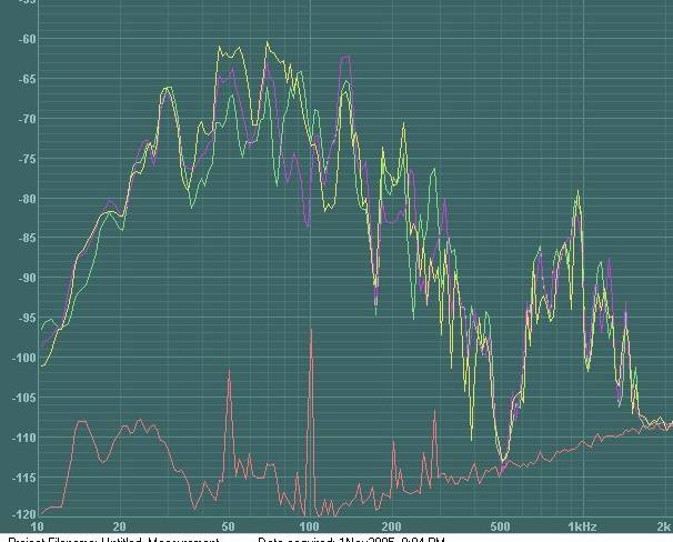

I think we all know how to measure the response. We all agree that measuring a horn at distance outside gives an accurate result.
Most of us have this evil thing called winter. I have been working on a couple of horns all winter and I never seem to get them to measure the same inside as outside.
What has been posted is pointing to the direction of measure outside and then figure out what is not going right inside.
Unfortunately that is what we all do with horns. After it is actually nice here in Ottawa I'm going to try some experiments to see if I can really relate a close mic response to a 10 meter ground plane response.
If it works to some degree I'll post it and see what you guys come up with. Because if there is some way to accurately predict an in room response by a little jugling of the db's down a bit then I can produce better results in the winter to!
