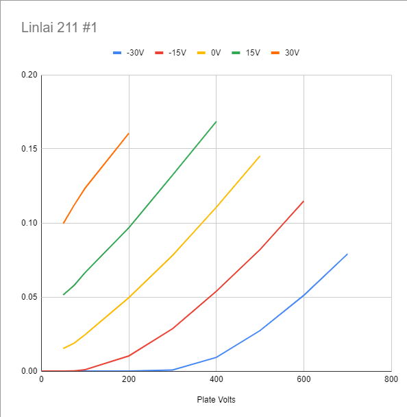

Oh, wow, those are very nice triode curves.
I've been looking at the mosfet I use to drive the grid. I have another that has the same capacitances but more transconductance. I might try that one in place of the Cree fet. I'm also going to try with resistive and current source load and try to quantify exactly what difference that makes.
Joined 2019
I traced those curves a few months back for a forum member, was really impressed, so couldn't pass up the lot when the opportunity struck. 1.8K plate resistance, mu 6.5, good stuff!

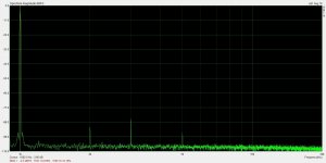

I've been attempting to track down the source of the high-order harmonics in the amp.
1) I doubled and tripled the standing current in the grid driver mosfet. Distortion was exactly the same. I substituted a different mosfet with 5x more transconductance (FQPF4N90C). Also no difference. If the grid drive were the source of the high-order harmonics I would have expected the relative amplitudes of the harmonics to shift in some way but there was no change whatsoever with these grid driver modifications.
2) I constructed an adjustable screen supply for the input tube and varied screen voltage. Lowering from 115V to 75V lowered distortion of the tube and lowered the amplitude of higher harmonics at high levels considerably. When I ran this configuration in the full circuit, the high order harmonics were again identical to what they were before. 2nd and 3rd were slightly lower which gave THD results that were a little lower overall. I did try referencing the screen supply to both ground and the cathode. Interestingly, the cathode referenced supply gave a little less distortion at levels below 2W and the ground referenced supply gave less distortion at high powers. I expected that one would work better than the other across the board.
3) I swapped out the VT-127 for another sample. Relative amplitudes of the high-order harmonics are all different with the other sample.
I think the high-order harmonics are caused by the characteristics of the VT-127. I don't think there is any simple way to get rid of them.

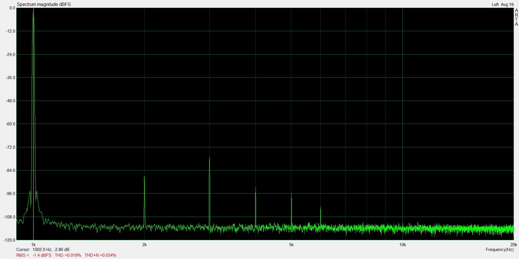

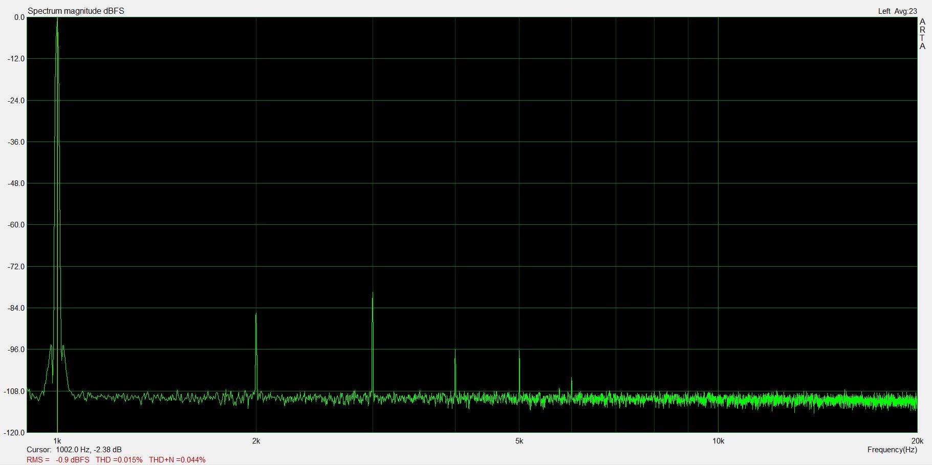

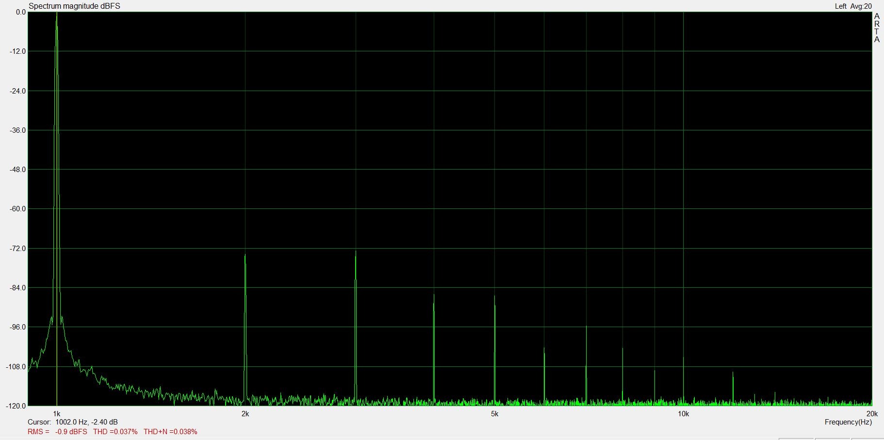

This is a summary of my latest tests with the new input tube operating point:
100mW: 0.017%
500mW: 0.013%
1W: 0.015%
2W: 0.018%
5W: 0.028%
10W: 0.037%
20W: 0.042%
30W: 0.10%
I want to try a folded cascode input stage and see where that lands me. It's possible that it will have less distortion but that this will lead to more system distortion if there is less cancellation between the two stages. I won't know until I try. But try I will.

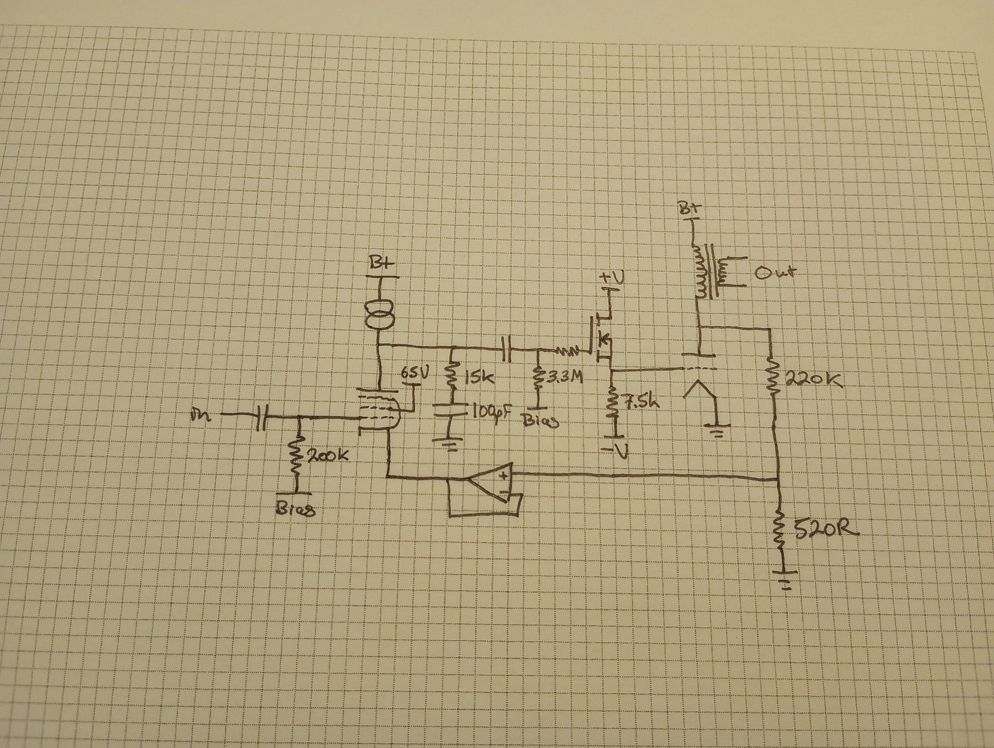

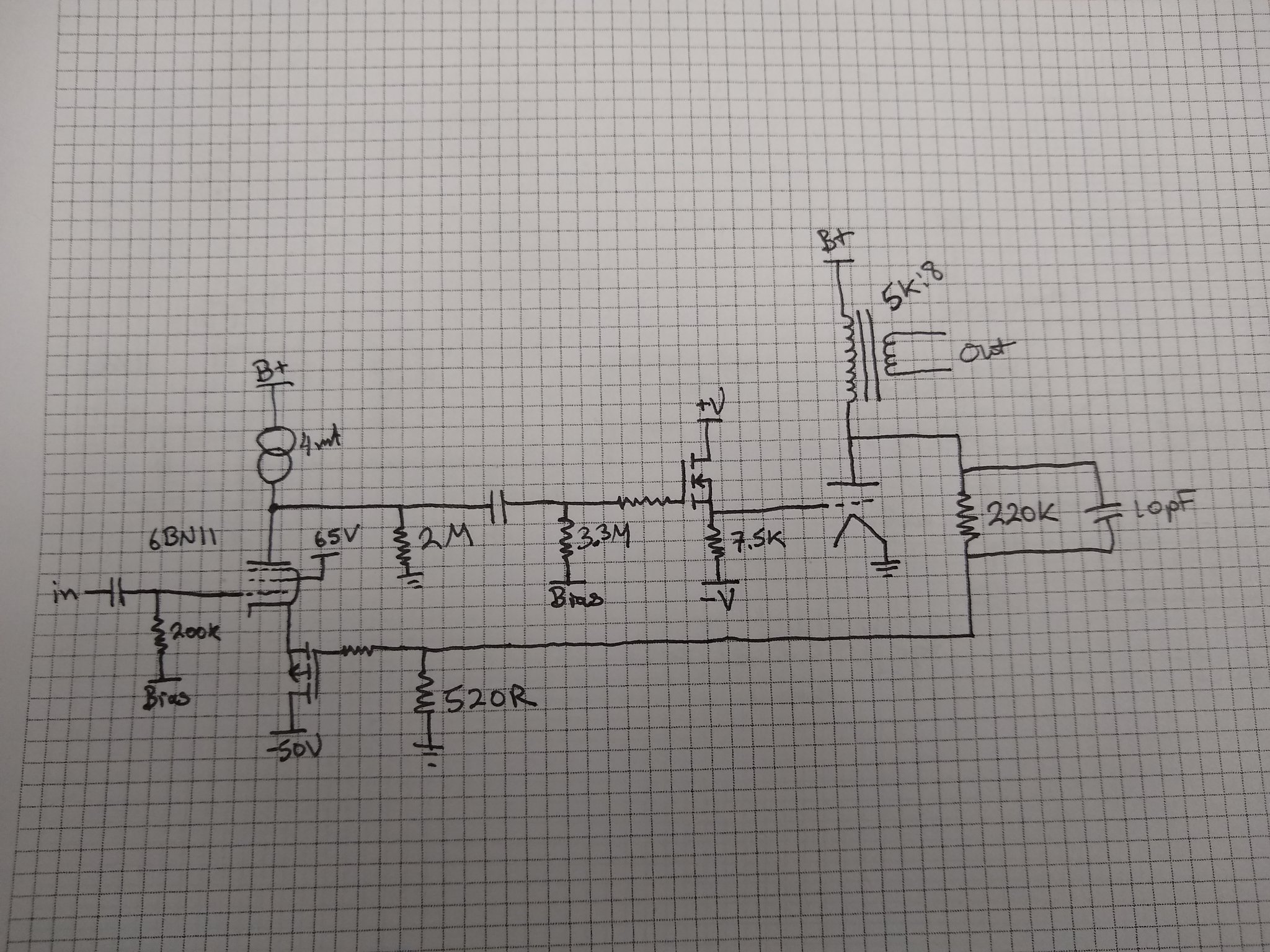

Here's a more current schematic of what I've got going:

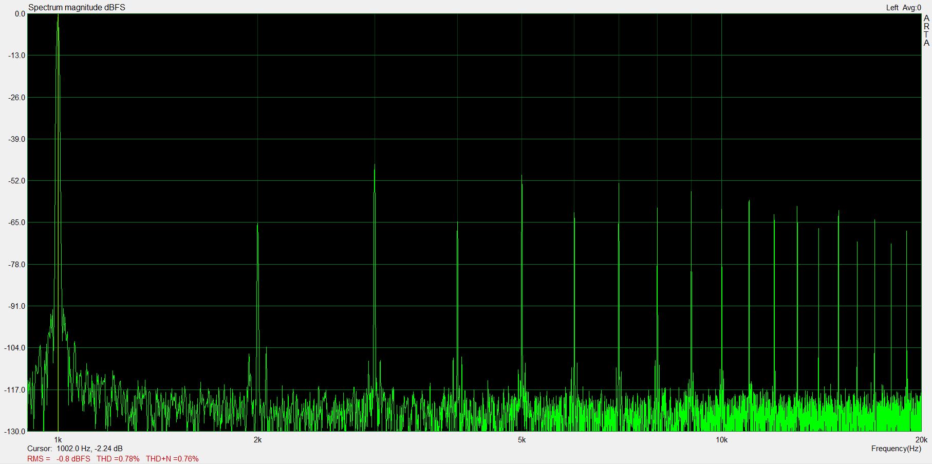

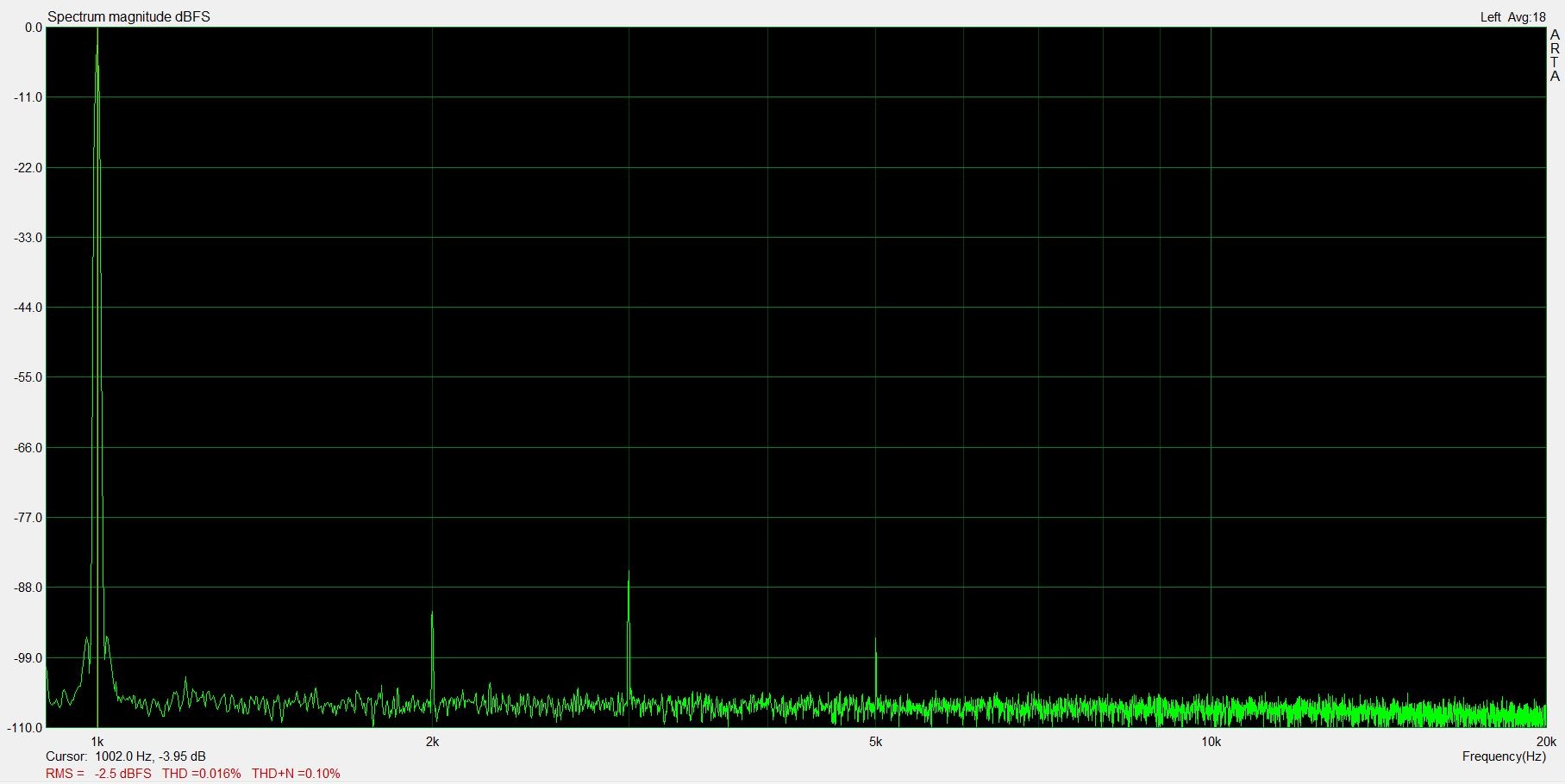

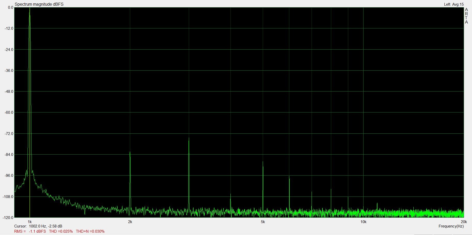

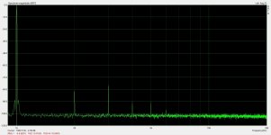

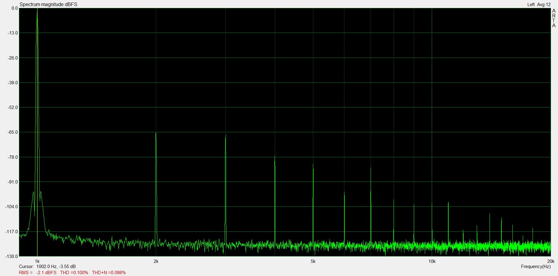

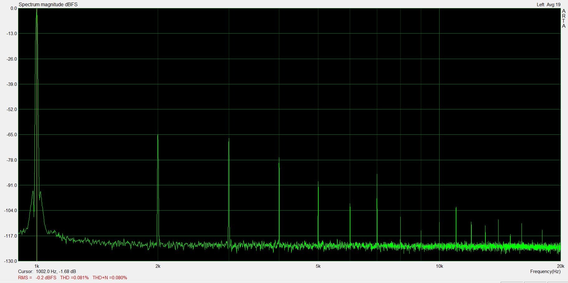

Here is a summary of the distortion measurements with a 211:
100mW: 0.016%
500mW: 0.013%
1W: 0.015%
2W: 0.019%
5W: 0.025%
10W: 0.037%
20W: 0.081%
22.6W: 0.10%
30W: 0.78%
The spectrum is 3rd dominant until pretty high levels, where it becomes 2nd harmonic dominant. I suspect that the 2nd harmonic distortion from the 211 is cancelling very well with the 2nd harmonic that is produced by the 6BN11 driver. I lowered B+ to 620V to provide an operating point optimized for the 211's 75W plate dissipation limit. I ran the tube at 110mA. From looking at the grid waveform at clipping, it looks like a slightly lower B+ and slightly higher current operating point would be optimal. The tube hits cutoff before it starts hitting saturation.
The 211 looks like a really good tube. The plate is able to be pulled nice and low before it hits saturation and stops. It is a really great option if you want to build a transmitter tube A2 amp with a comparatively low plate voltage. 100T variants will get me 40W audio output with 750V on the plate, but a 211 will get me 30W with probably 600V or so.

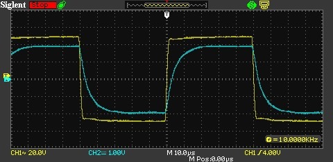

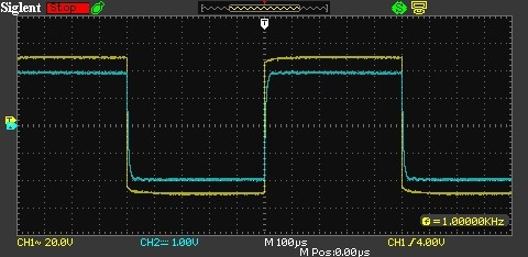

I've attached the latest experimental configuration along with square wave performance. I tested out an op-amp (LM4562) follower driving the cathode of the input stage. There is slightly less distortion overall but high frequency behavior is significantly better. Playing around with the RC network on the plate of the input stage, I was able to achieve a pretty good square wave response. The yellow trace is the primary of the output transformer, blue is the secondary.
This is probably a case where the output transformer design could be optimized for the very low primary driving impedance (<10Ohm) to get better HF performance for the amp. The current output transformer is an Electra-Print. Jack seemed very skeptical of what I planned on achieving as far as driving impedance and was somewhat argumentative so I doubt this transformer was optimized for the application, even though I really tried to convey exactly how it would be used.

Wow I just stumbled across this page while looking for a low distortion 845 or 811 or 211 amp. Amazing performance numbers for the 211. What's teh output impedance of the amp at the secondary coil? less than 1 Ohm? Amazing.
Is the circuit on post 354 or 347 the final schematic? And all without any global feedback from transformer secondary? Just wonder if cathode feedback will help the distortion characteristics & damping factor at all. By the way what transformers are you using for the 211 amp?

Zout is dependent on the output transformer used. The Edcor had lower winding resistances so Zout was about 0.7 Ohm. I'm currently using an Electra-Print transformer and Zout is closer to 1 Ohm but still below.
There really is no "final schematic" since I still haven't built it into a chassis yet. This is just a series of experiments, but the amplifier I will build will probably be a circuit like in post 354 and I'll make it reconfigurable for the various output tubes I tested in this thread. I'll probably make a second amp for the 826s since they require significantly lowered voltages and I'll use the Edcor transformers in that one. Some people may hate that I used an op-amp follower to drive the input tube cathode. The distortion with the p-channel fet follower was almost the same but it was easier to tame the 10kHz square wave with the op-amp follower and the end result was better. I personally don't have a problem with an LM4562 follower in my audio path since all my music has already passed through many, many NE5532s in the studio, but I know many in this forum would not approve.
The drawback to this approach is that there is no feedback around the transformer, so whatever happens there remains uncorrected. But it turns out that if you drive them from a low source impedance they add almost no distortion at midband. The misbehaviors will be at the frequency extremes. I think a few dB of feedback around the transformer would greatly improve things but I haven't gotten there yet. I'm currently working on an Arduino microprocessor bias controller for the amp that I'll probably share the code for here when I'm done.
