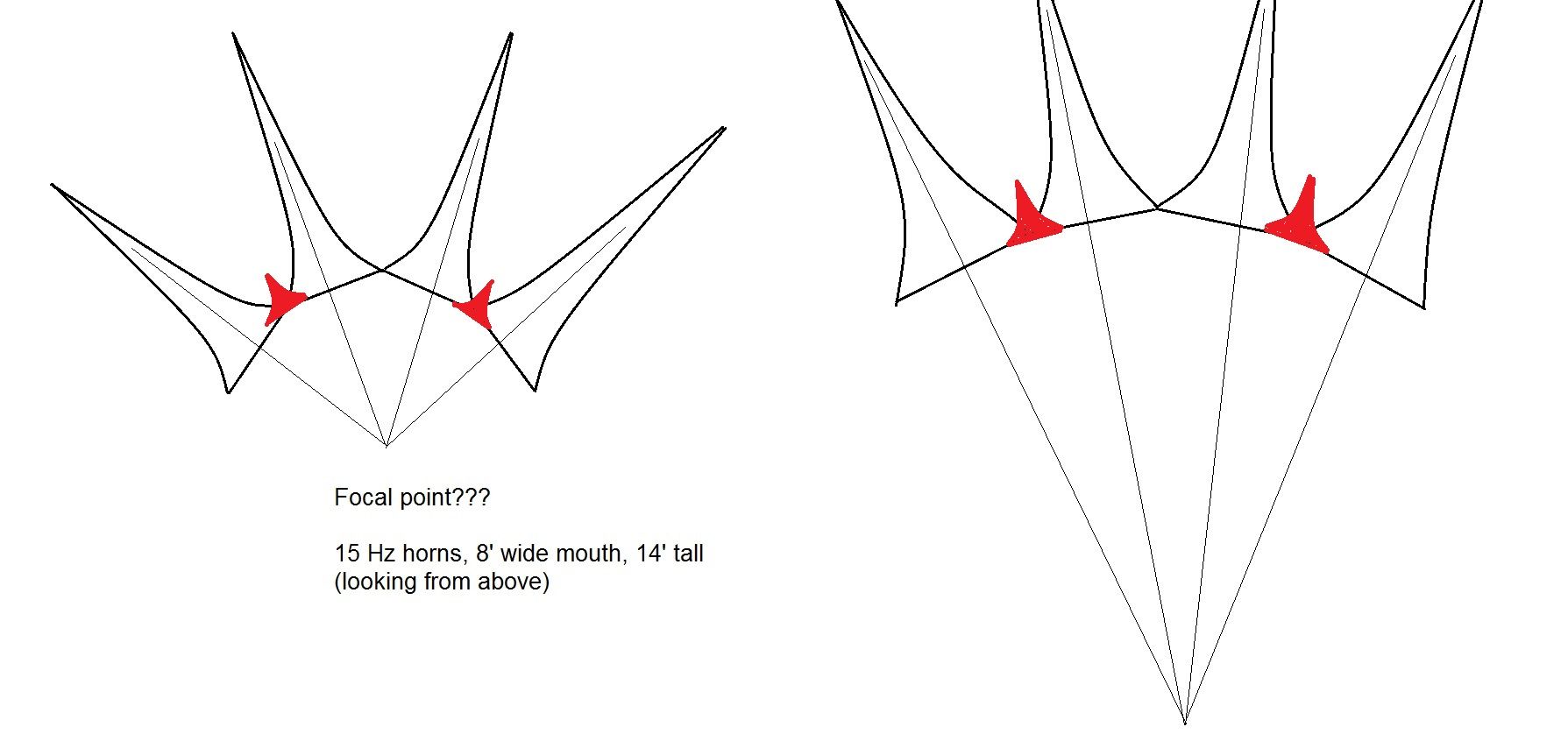

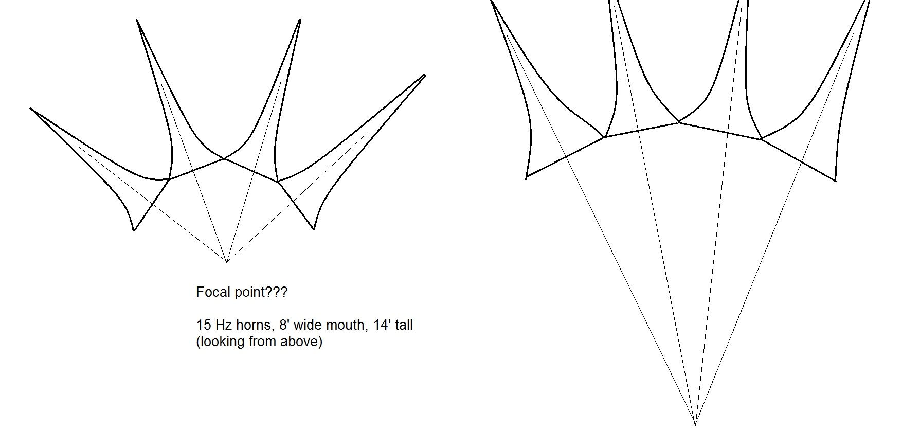

I’m going to build (qty 4) 1/4-space full size 15 Hz exponential horns – each with an 8 foot wide & 14 foot tall mouth. The left two horns will combine as a half-space stereo channel, and the right two horns for the right. Assuming most bass is recorded mono, I will essentially have a single full-space 15 Hz horn (with the ability to reproduce stereo, if needed – depending on my final crossover point. . .. )
I was doing some back of the napkin calculations. If I cast my horns 10” thick on all sides, I’ll need about 17 yards of concrete per horn (not including the foundation abutments). Concrete is about 150 pounds per cubic foot, making my horns weigh 68,850 pounds each (just in concrete). Assuming I’ll usea moderate level of steel reinforcement, add 6 pounds per cubic foot for the rebar, or 2750 pounds per horn. All four horns combined will weigh about 286,420 pounds, or 143 tons (less the foundation abutment). This will cost about 8 grand in concrete (assuming around 110 bucks/yard), and 3.3 grand in rebar. The wall, and the horn foundation abutments will easily increase the amount of concrete & rebar by 50%. . . The big unknown is the forms. To be cost effective, I need to build just one set of forms, and use them four times. . . .
But more importantly, weltersys has convinced me that I need to target my horns (i.e. see below). Question – where the heck do I start with making this decision???
To help in the decision process, here’s my proposed main positions (shown in red). Two stereo mains, positioned above each “pair” of stereo bass horns (also a weltersys influenced decision). Thus the very bottom of the main stack will be starting life 15 feet off the ground, and only go up from there. My thinking is that one pair of mains is enough - and that if I had two pair (one over each bass horn), I'd lose more in comb-filtering than I gain in fidelity. Opinions?
My gut tells me with my mains being pretty high in the air, that I should seek a focal point between 35 and 40 feet (i.e. the linear distance between each bass horn mouth, and the listening focal point) - or possibly more (i.e. something resembling the horn layout on the right). I'm ok with the sound having a somewhat "above" feel. And I can always revisit putting the mains in front of the horns - if I'm unhappy with the sound. (I'm going to purchase fancy digital delays. . . So there's options. . . .)
Focal point distance - the 143 ton question???
And needless to say - the sketches are NOT to scale. . . ..

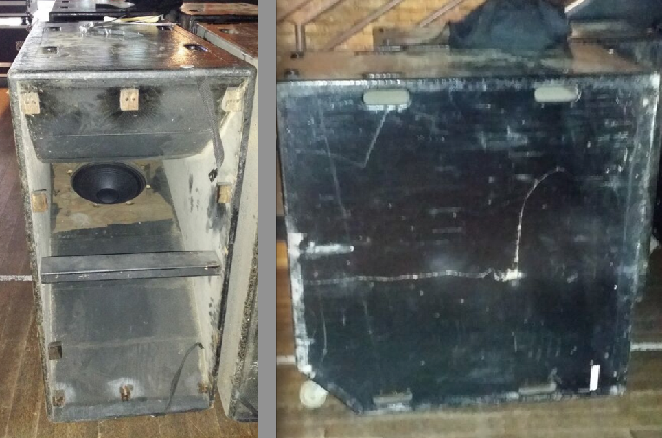

Oh, more memoirs, my 1981 L-2 2x15" bass cabinets, dubbed by Steve Raitt "Clams", were a direct adaptation of the Martin straight horn bass cabinets used by SuperTramp on their first USA tour. Steve came back to the warehouse we shared after hearing a portion of SuperTramp's sound check in which the kick drum had caused a fair amount of plaster to fall from the theater's ceiling on each beat, until the engineers realized they could not continue at that level without wrecking the joint. Naturally, this was something we wanted to pursue.
I whipped up a prototype, it was equal in "punch" to the "Collapsible Crunchers" Steve had bought from Eclipse Concert Systems to use with the Lamont Cranston Blues Band (on Shadow Records), the simple-to-build L-2 bass range was equal to the twice-as-large fiberglass curved exponential horns I was using at the time.
After the "mind blowing" revelation that bass (and low mid) frequencies do not need curved surfaces to sound (and measure) as good, the second iteration of the L-2 and L-4 used only a two-part expansion. The stiffer junction of the two part Vs the earlier 4 section "arc" actually made for more of the "punch" we craved that is often lacking in many of today's mono sub systems.
In March of 2016 the Minneapolis "Fine Line" club sold their Welter Systems 1981 L-2 "Clam" cabinets off, I don't know what they replaced them with, or even when they acquired them, other than it was after I left Minneapolis in 1995.
Rock and roll is not dead, and neither are my old bass horns, they are just living under another roof, with new cones pumping the kick out for another generation :^).

1) If there is any Welter Systems' influence in your sketch, it is way too obtuse for me to detect it. Please do not associate me, my company, or likeness to said sketch in the future, thanks for your consideration :^).1)Two stereo mains, positioned above each “pair” of stereo bass horns (also a weltersys influenced decision).
2)My gut tells me with my mains being pretty high in the air, that I should seek a focal point between 35 and 40 feet (linear distance between each bass horn mouth, and the focal point) - or possibly more (i.e. something resembling the horn layout on the right).
3)Focal point distance - the 143 ton question???
4)And needless to say - the sketches are NOT to scale. . . ..
After looking at your sketch again, I get it, you completely inverted one of the concepts I described as the basis of system design. Wow.
2) My "gut" feels a little sick just looking at your sketch, but I have mentioned I can get a little queasy at times. I even get seasick below decks, I don't think I could handle a submarine unless they are as smooth as TV and movie sets make them out to be.
3) Yeah, you need to make some decisions. "Some guys" would actually try a few measurements or outdoor listening before posting .
4) No, we would not expect plans submitted for preliminary concept evaluation to be to scale in light of #3 :^).
I will expect the Mini Nuke plans you will give me to be to scale, as that project will be in your "wheelhouse", so to speak.

Eric, I highly discourage you from arranging your horns in a concave array.
It will narrow the dispersion of your horns, there is no "focusing" or "concentration" benefit to it.
Please look at the material I posted two pages back, two papers about bass arrays. In both papers you will find information about what happens with concave bass arrays:
practical guide to bass arrays pdf
www.electrovoice.com/downloadfile.php?i=8913[/QUOTE]
WOW – concave is a VERY bad idea. Thank you for the link bob4. I knew there’d be negative off-axis implications from achieving a focal point, but not nearly to this scale. . . .Eric, I highly discourage you from arranging your horns in a concave array.
FWIW, this bone-head idea originated from the below comment:
All is not lost with Eric's "concrete" plans, if he simply were to "toe in" his rather large pair of large bass enclosures, center of their mouths separated an equal center to center distance as his upper L/R cabinet(s), and let them "beam in" at the "sweet spot", a good time will be had by all at that central point, which will be +6 dB louder than a point equidistant to the L/R, but located in front of either array, rather than on axis in the center.
At this point, I am going to disregard everything weltersys has said. Toeing in my subs was such a bad recommendation, it could be considered sabotage. And shame on me for actually listening to him - in thinking weltersys has my best intentions at heart. . . .
