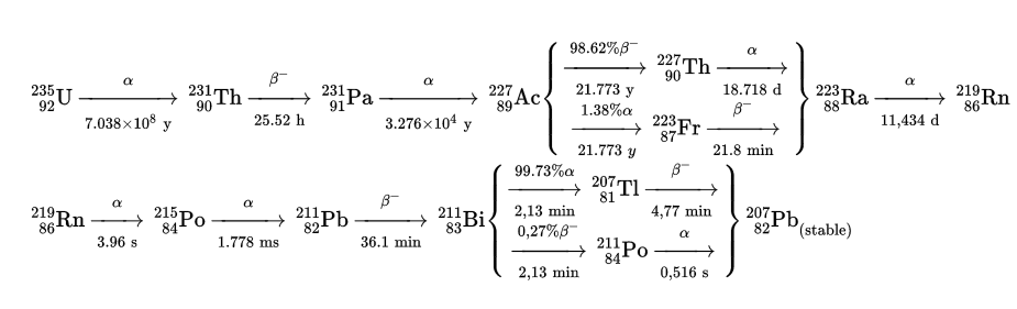

Well back to my projects, looks like I'll be closing on a house and dedicated separate shop/studio sooner than expected, so building the studio walls and a small shop addition will soon move to the top of the "to do" list. Fortunately I don't have to deal with all the building regulations and restrictions Entropy Eric has in the county he has chose to build in.
I'll have to ask him to design the nuclear power plant (for free, of course) I plan to put in the back yard.
According to the calculations he has so freely shared, with the purchase of a few pounds of U-235 from some "associates" in Los Alamos, the costs of concrete, rebar, and the cooling pipes from the local water supplier should be around the same cost as his project, the U-235 should cost less than the B&C woofers and Radian HF drivers he plans to buy.
Once the mini nuclear power plant is completed, I won't have to pay another power bill for the rest of my life, and resale value on the house should be at least double, unless Eric's design does not preclude the "China Syndrome", in which case the property will be available for sale as two empty lots. Considering the water table height, the property might then be "beachfront" property, so it's a win/win situation.
I'll make sure I keep soft drinks away from the control panel to avoid the "Pepsi Syndrome", but I'll leave it to Eric for the rest ;^).
I'd like to pour concrete before any potential freeze, can we have the plans done before November 30, 2016?
Eric, thanks in advance for the inspiration, and your Mini-Nuke design!

P.S. Oops, my previous estimate of the amount of U-235 was off, a pound of it is equal to 2.5 million pounds of coal, so my up-front costs should be way less than I thought, hope you guys check my math, I'm more of a horn speaker kind of guy :^).

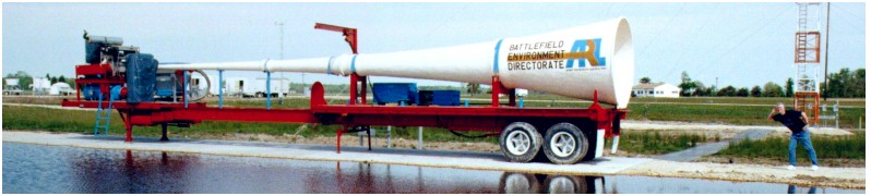

This reminds me ....
of ....
WHG
This is EXACTLY what I was talking about when I said Direct can't simulate the very narrow beams of OP's large horn - less overlap = less interference. I brought this point up myself, you guys are trying to make it sound like I'm either really stupid or trying to hide something.
>snip<
And here's a couple of them stack in real life for some size perspective.
