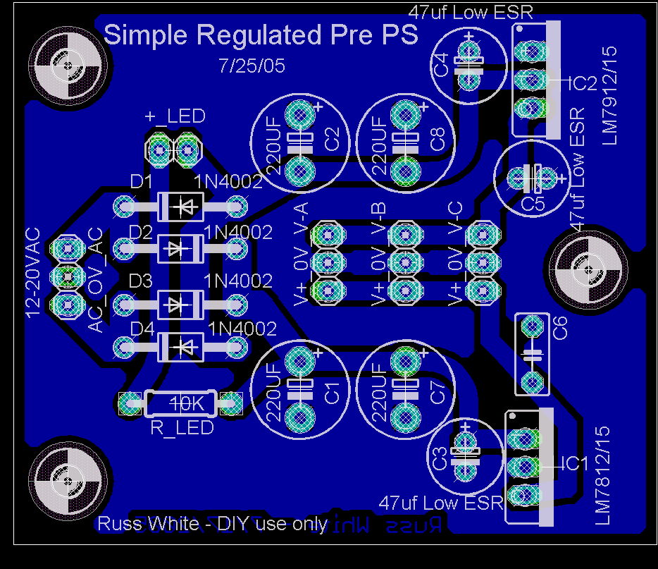

DcibeL said:Thank you for posting th BOM. Is there a specific capacitor type/manufacturer that you recommend for the other caps (the non-polarized caps)? I am just potting together the parts order now for this board.

Dcibel, what brand and type have you found for the low/ultra low ESR EL caps. I have to admit to not having much luck at all finding these sizes locally. I'm beginning to think that Australia is a quality cap desert Does Digikey/Mouser sell them?, I may have to do an import order if I can't find them locally.

Michael I will send you some 47uf ultra low ESR. Enough to complete the project. Cheers!

Russ, you are too kind. Now I definitely owe you a beer!
Are they the only critical ESR caps I need to worry about in this circuit?

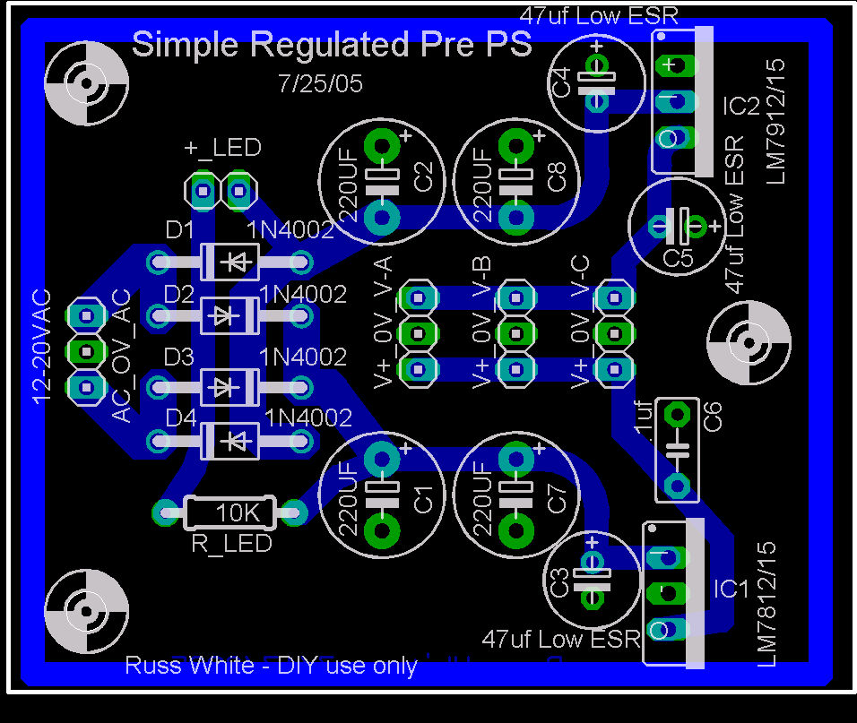

Well... on the power supply low ESR would be prefferable but anything will do.
The other caps are all film types, so no issue there.
I am reworking the power supply a little, so hold off on you parts for that. I should have it done in the next day or two. Busy weekend for me.

I was just going to ask why there is different sized capacitors on each side of the power supply, but I will await your modified PSU.
Just for reference on the Low ESR caps, Mouser has the closest thing with the Xicon caps. However it takes a very long time for shipping from mouser for me, plus the addition of customs fees, so I will be using Panasonic "low impedance" capacitors from Digi-key. They have a slightly higher series resistance rating than the Xicons, but I think they will do okay.

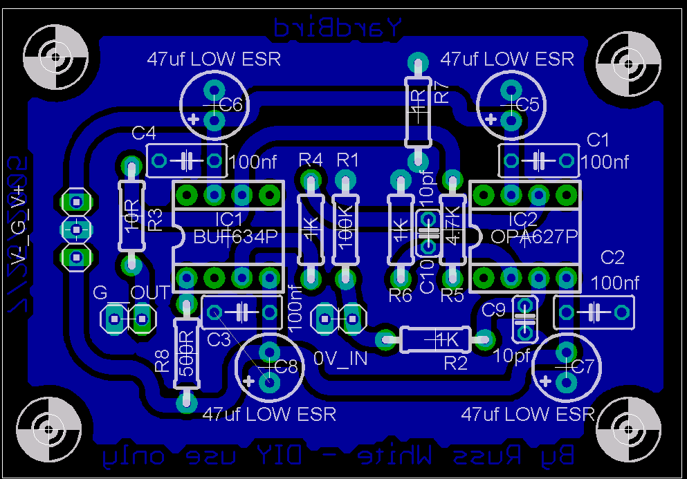

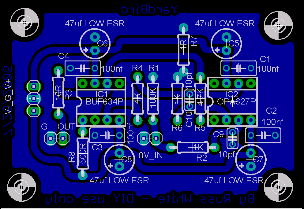

Ok, there is a serious error in the yardbird design. It will always operate in unity gain. Whoever can tell me why wins a (virtual) cookie.
I will be fixing it before I send them out, its a simple change. I can't believe I did that.
The Freebird does not have the problem.
