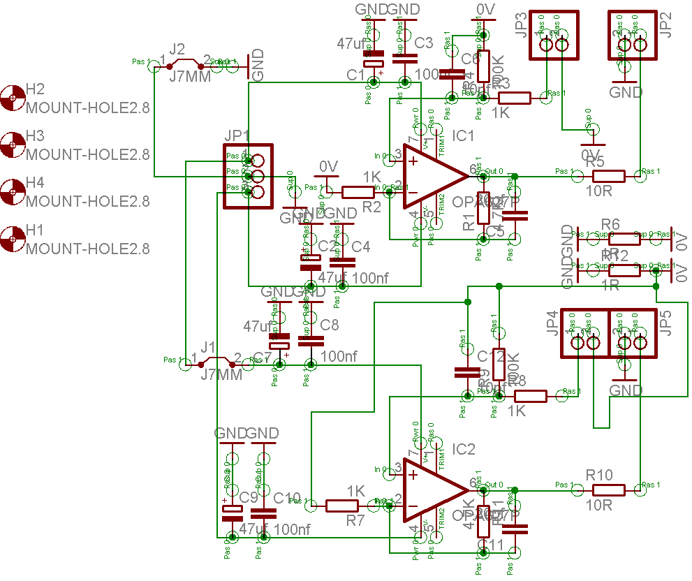

Yep I sure will post a schematic for all of them. It will probably be the next day or two , as I am building a case for my Mauro Ref amp right now and that is likely going to consume my day. But don't worry it will come. I will also include a complete BOM and suggestions regarding the optional parts(like compensation caps) and gain setting.

And a parts list for a gain of a little more than 5.
C1 47uf CPOL-EUE2,5-6E E2,5-6E rcl 1
C2 47uf CPOL-EUE2,5-6E E2,5-6E rcl 1
C3 100nf C-EU050-030X075 C050-030X075 rcl 1
C4 100nf C-EU050-030X075 C050-030X075 rcl 1
C5 20pf C-EU025-030X050 C025-030X050 rcl 1
C6 10pf C-EU025-030X050 C025-030X050 rcl 1
C7 47uf CPOL-EUE2,5-6E E2,5-6E rcl 1
C8 100nf C-EU050-030X075 C050-030X075 rcl 1
C9 47uf CPOL-EUE2,5-6E E2,5-6E rcl 1
C10 100nf C-EU050-030X075 C050-030X075 rcl 1
C11 20pf C-EU025-030X050 C025-030X050 rcl 1
C12 10pf C-EU025-030X050 C025-030X050 rcl 1
IC1 OPA627P OPA627P DIL08 burr-brown 1
IC2 OPA627P OPA627P DIL08 burr-brown 1
J1 J7MM J7MM 07 jumper 1
J2 J7MM J7MM 07 jumper 1
JP1 PINHD-1X3 1X03 pinhead 1
JP2 PINHD-1X2 1X02 pinhead 1
JP3 PINHD-1X2 1X02 pinhead 1
JP4 PINHD-1X2 1X02 pinhead 1
JP5 PINHD-1X2 1X02 pinhead 1
R1 4.7K R-EU_0207/10 0207/10 rcl 1
R2 1K R-EU_0207/10 0207/10 rcl 1
R3 1K R-EU_0207/10 0207/10 rcl 1
R4 100K R-EU_0207/10 0207/10 rcl 1
R5 10R R-EU_0207/10 0207/10 rcl 1
R6 1R R-EU_0207/10 0207/10 rcl 1
R7 1K R-EU_0207/10 0207/10 rcl 1
R8 1K R-EU_0207/10 0207/10 rcl 1
R9 100K R-EU_0207/10 0207/10 rcl 1
R10 10R R-EU_0207/10 0207/10 rcl 1
R11 4.7K R-EU_0207/10 0207/10 rcl 1
R12 1R R-EU_0207/10 0207/10 rcl 1

Those would be the ones.maf_au said:Those 627's are like Digikey part# OPA627AP-ND ?
I would assume that the different part # is just for the package type. DIPs are always prefered over a surface mount package because if you wreck a dip, it is very easy to take out and replace, especially if it is in a socket. SOIC, not so easy to replace.maf_au said:Is there any practical difference between the OPA627AP and OPA627AU opamps? The AU is listed as a SOIC package vs the AP's DIP8, but the schematic and pinouts look the same to my newbie eye...
maf_au said:Russ,
Michael
You should get the DIP package for my boards. It is intended for the DIP package.
You could get the U package (SOIC) but you would have to get an adapter, and the results would not be as good.
Cheers!
P.S. Don't bother spending the extra to get the opa627B it is only better beter than the opa627A in DC, and that serves no purpose here.
maf_au said:Ok, thanks.
I didn't know that a SOIC is surface mount. duh!
What spec do I need on the tranny?
Michael
A 24-30VCT trafo good for 250MA is plenty. So anything larger is fine, but larger than an amp or two is really overkill.
I used a 25.5VCT 250MA trafo.
Sorry to be asking all these questions, What do all the CPOL-EU notations mean? Is there a way of telling if it's an electrolytic from that? are they all electros?
What quality and wattage resistors should I get?

Yes, those are small electrolytic, Low/Very Low ESR types are best here.
All resistors should be 1/4W 1% metal film.

Thank you for posting th BOM. Is there a specific capacitor type/manufacturer that you recommend for the other caps (the non-polarized caps)? I am just potting together the parts order now for this board.

DcibeL said:Thank you for posting th BOM. Is there a specific capacitor type/manufacturer that you recommend for the other caps (the non-polarized caps)? I am just potting together the parts order now for this board.
This amplifier project of mine keeps getting more expensive every day...
Yes, the parts add up eh, the story of my life.
The 100nf(.1uf) film caps from futurlec are a great choice. And inexpensive. They usally send me Wimas.
