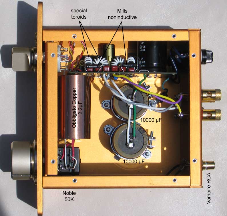

Been doing a few mods to my Amp6 and was thinking about trying better output inductors if worth it, any idea's regarding better coils?
I currently use 2.2uf Auricaps for coupling, may give the 4.7uf Siemans MKV a try next although they are huge, I have some Jenson PIO but they are only 0.47uf
Nice work on your amp panomaniac

I have not put anything bigger at C18/19, but the biggest high quality cap you can get in there will certainly help.
I always added an outboard 10,000uF cap tied to C18/19 or sometimes two.
In the Trends mods that I do now I'm using 2x2700uF Panasonic FM with very good results. They are too big to fit snug against the PCB, but they still work nicely. Something that size or bigger on the AMP6 should be great.

panomaniac said:I have not put anything bigger at C18/19, but the biggest high quality cap you can get in there will certainly help.
Thanks Michael
I just tried a 4700uf Panasonic FA for C18/19 but the bass seemed to be less tight and a little bloated, maybe its down to the type of cap.
Unfortunately Farnell over here only seem to stock 2200uf and no 2700uf FM's, I've not tried the FM series yet, would you say these are better sonically than the FC's? I'm going to give the higher BC136's a go too.
I've compared a 470uf BC136 against a 470uf FC in C1819 and found the BC to sound much better in my system at least so will be interesting to see how the larger values sound.
