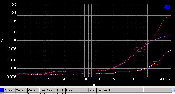

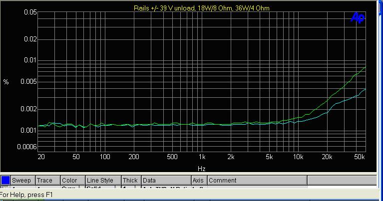

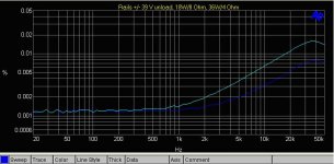

Some test results for LME49811 with one pair/two pairs ThermalTrak 4281/4302 vs load condition (4 Ohm, 8 Ohm). Supply rails is +/- 49 V. Measurement bandwidth is 80 kHz for the left and middle graph. Bias current per device is 50 mA. Output power is 18 W/8 Ohm, 36 W/4 Ohm.
4281 and 4302 are low beta droop devices. For one pair, the 10 kHz distortion is doubled from 0.003 % to 0.006 % (8 Ohm -> 4 Ohm). When there are two pairs, the distortion is reduced for the two load conditions. There is almost no addition degradation for 8 Ohm to 4 Ohm at 10 kHz. At 20 kHz, the THD+N are 0.002 % and 0.003 % for 8 Ohm and 4 OHm, respectively.
The measurement bandwidth is 22 k for the right graph.

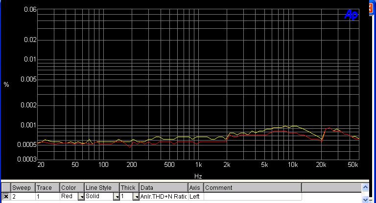

Speed-up capacitor
The effect of speed-up capacitor is evaluated. A 0.1 uF is in parallel with the driver emitter resistor to speed-up output device switching speed.
The amp under test is still LME49811 with two-pair 4281/4302. There is no effect for 50 W into 8 Ohm load (lower two curves). The capacitor does reduce the high-freq THD+N considerably for 100 W into 4 Ohm load. We need the output stage working harder to observe the effect clearly.

Is the red line passing close to 0.05% @ 20kHz, the very early onset of cross modulation?
Is cross modulation something related to slew-limit distortion?
