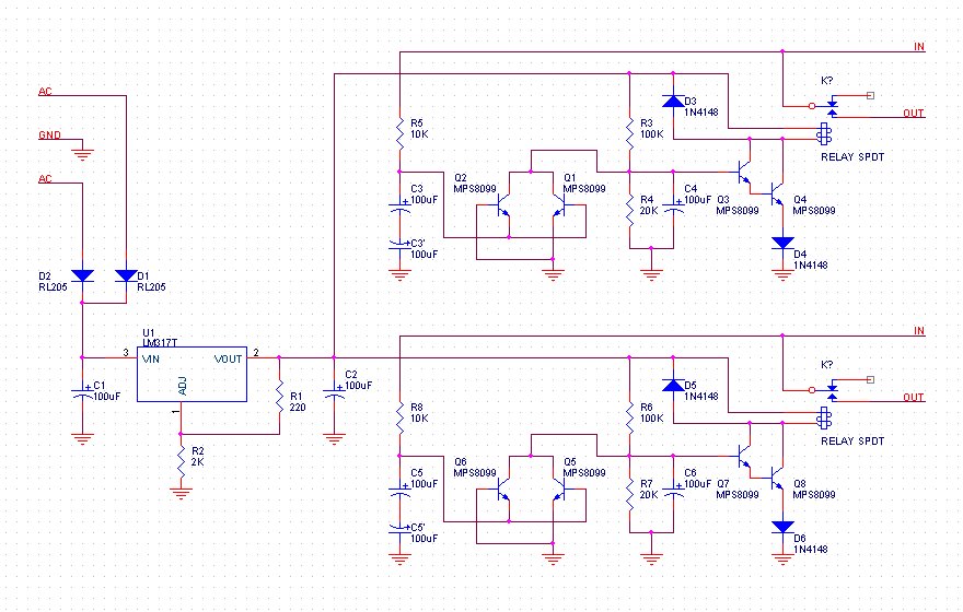

Help!!! I fried my speakers!!!
I need help understanding what I did wrong so I don't blow my other speakers and became speakerless!
The tweeters are fine but the woofers died! Was it DC at the output? Was it oscilation? Too much bias voltage? Was it because I changed some values of the capacitors? Please help me understanding so I don´t do it again!

Hi Paulo,
Is you amp 49830 MOSFET? Did you adjust the bias with measurement either the current or voltage drop across any 0.22R emitter resistor? Was it adjustable? Did you short the input+ to ground and measure the output DC level? What value of the compensation cap do you use?
You should have the bias level and output DC level stable (say measure them for 10 min). The bias level may move up or down slowly due to heat sink temperature. The DC level must be very stable.

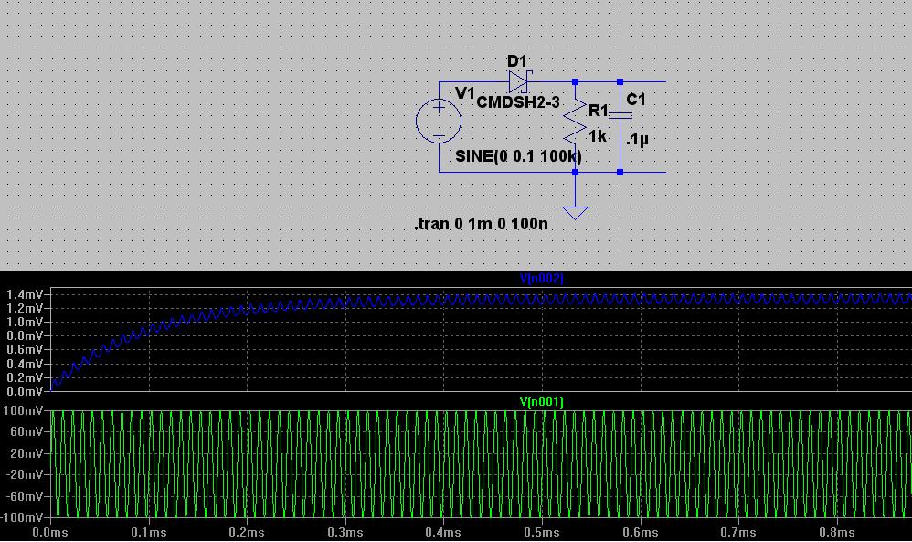

To check oscillation without a scope, you can connect a dummy load to the output (8Ohm power resistor). Input should be shorted to ground. If the resistor is getting warm, you have osc problem. You can also make a envelop detection circuit to rectify the osc waveform to DC. It consist of a small signal diode and RC filter. However, if the osc level is too low to turn on the diode. it does not work.
Assume the osc is 100 kHz, 100 mVpeak, the circuit below can help you to detect it.
Panson
- is DC the only thing that can damage speakers?
You should add a speaker protector which cut off the speaker for the present of DC. Here is a simple circuit for your reference.

I bought this exact kit from eBay some time ago! It´s the exact same circuit but I forgot it and never assembled it!!! Should've known better...ou should add a speaker protector which cut off the speaker for the present of DC. Here is a simple circuit for your reference.
