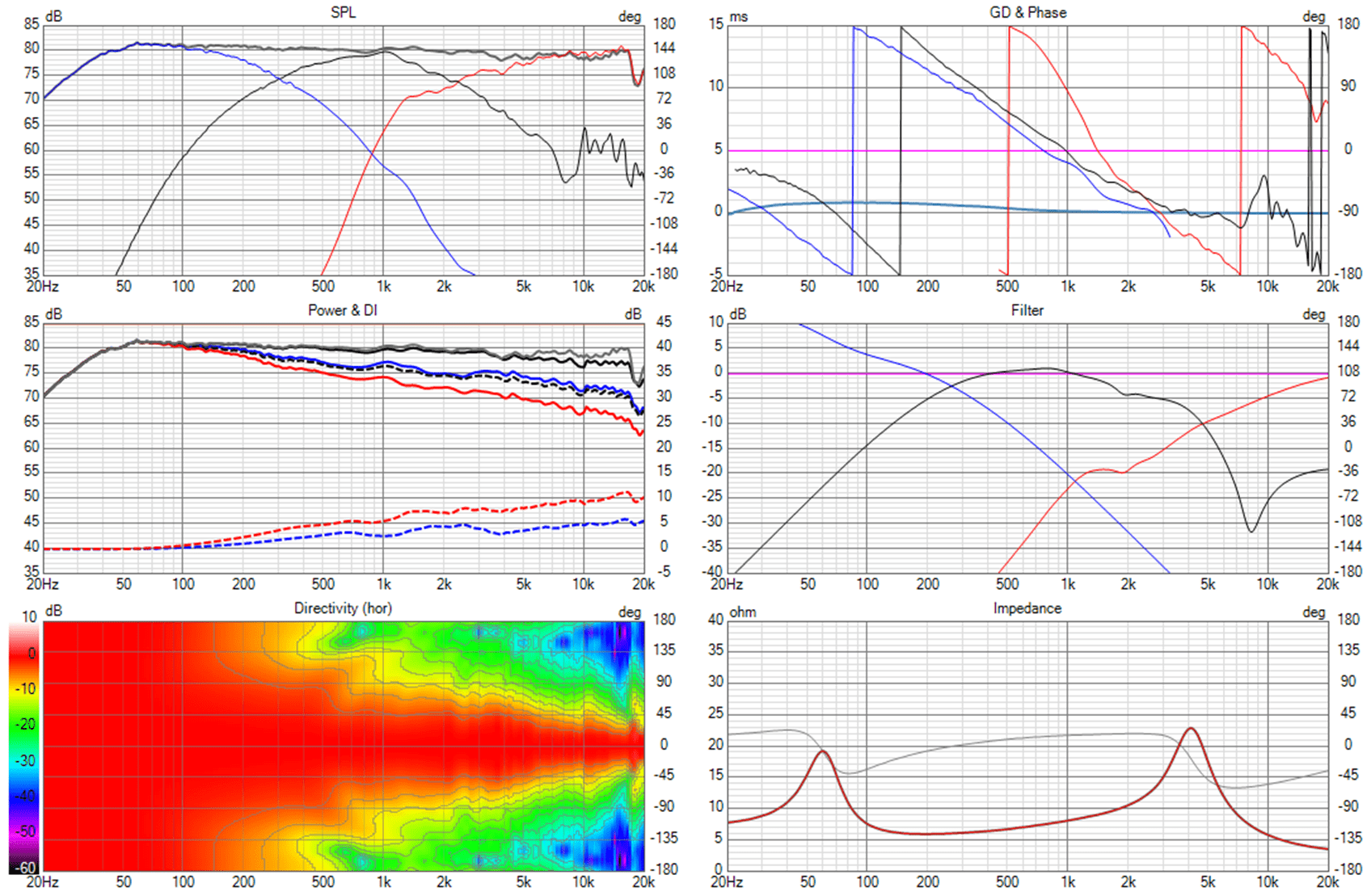

I’ve been experimenting with simulating an active/passive crossover. At this stage, this is just proof of concept activity. It has no real application to the final product, but it demonstrates to me that the concept of an active lower crossover combined with a passive upper crossover has merit.
I have not selected the drivers yet, but I know the woofer will be 8 inch. I assume the mid driver will be a 4 – 5 inch driver. At this point, I assume the tweeter will have a waveguide for best directivity control.
For simulation, I used measured acoustical and impedance data from earlier projects. I used data from an SB23MFCL45 in a 10” wide enclosure to represent the 8” driver. I used an SB15CAC30 in a 10” wide beveled enclosure to represent the mid driver. I used a Satori TW29BNWG to represent a typical dome tweeter with waveguide.
This crossover seems reasonable. The woofer is fully active, with one amp channel. The mid/tweeter has the other amp channel and has a blend of active and passive networks. I forced the driver sensitivity/gain to be compatible with each other, whereas in a real crossover I would need a resistor network on the tweeter as a minimum.
Of course, the actual drivers I select will have somewhat different directivity and frequency responses than this proof of concept simulation. But this exercise has convinced me that this approach is feasible.

Yes!but it demonstrates to me that the concept of an active lower crossover combined with a passive upper crossover has merit.
I have been doing this for years in projects were resources and/or budget are limited. It works extremely well and saves one extra amplifier.
You can even improve the noise from the amplifier drastically, when you attenuate the tweeter passively. Which is at least 6dB from the bafflestep plus the additional extra sensitivity tweeters have.
The bafflestep doesn't seemed to be modeled in here I think?
I personally would give the woofer a 4th order filter.
Thanks for your thoughts. I had not considered that aspect.You can even improve the noise from the amplifier drastically, when you attenuate the tweeter passively.
Actually, the NF response shape of this particular woofer has a natural 4 dB drop from 100 to 500 Hz, so it does not require the full 6 dB of baffle step. I am using a + 3db shelf at 200 Hz. A different woofer will need a different shelf.The bafflestep doesn't seemed to be modeled in here I think?
SB23MFCL45-8, sealed box, Near Field
I was more talking about the tweeter, because I don't see any additional attenuation with the tweeter.Actually, the NF response shape of this particular woofer has a natural 4 dB drop from 100 to 500 Hz, so it does not require the full 6 dB of baffle step. I am using a + 3db shelf at 200 Hz. A different woofer will need a different shelf.
Which feels odd, although not impossible, because of the bafflestep as well as the higher sensitivity.
But anyway, like you mentioned, this is just some preliminary investigation (which I applaud btw!)
It is something to keep in mind for the real thing.
Btw, attenuating the tweeter will cost (a lot) more power and voltage from the amplifier.
Also something to consider.
Although the real power in the upper frequencies isn't that big plus you would have had the same issue with a fully passive filter anyway.

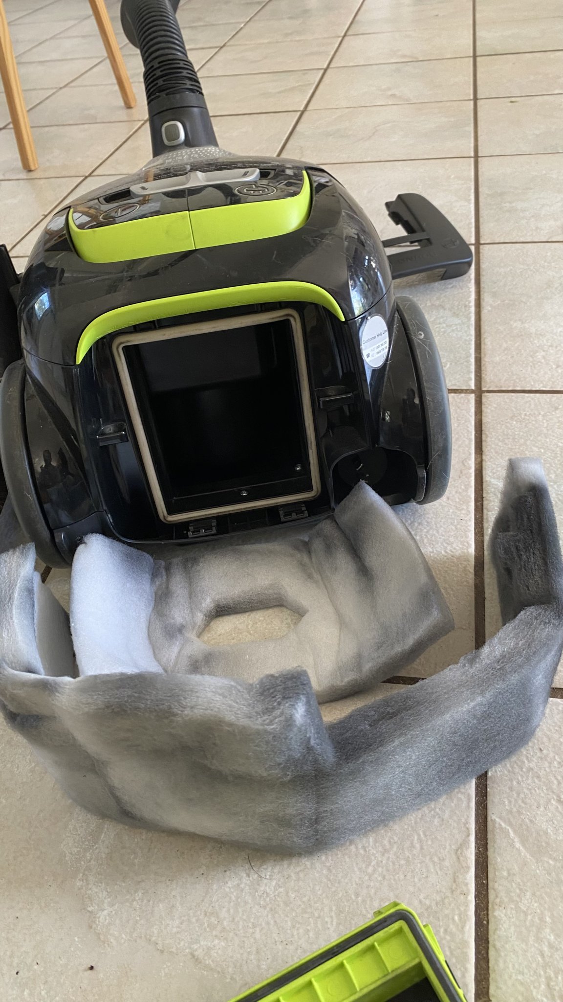

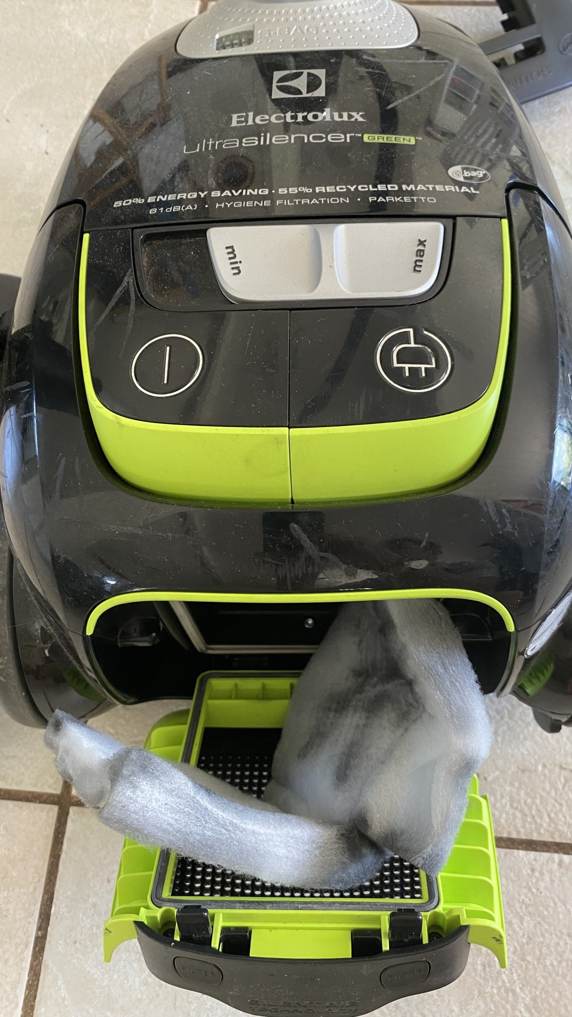

This is going off on a wild tangent (hifijim feel free to report to moderator to remove this post)
But I was trying to figure out the unusual smell in a vacuum cleaner. My left leaning, hybrid driving, tree hugging, over-recycling spouse asked me to have a look at the vacuum cleaner. As the HEPA filter, exhaust filter and vacuum bag had recently been changed, it was odd that it would emit an malodorous scent through the exhaust duct.
This an Electrolux bagged canister vacuum machine, model range Ultrasilencer,
(precursor to the current Silentperformer) range.
It was a low-medium cost ($300) vacuum cleaner purchased about 15 years ago.
Anyway, to my surprise- it uses Dacron or other dense polyester type fibrefill material wedged deep, inside between the vacuum motor and external casing. Here are the photos for your viewing displeasure.
No wonder it is extremely quiet in use (imagine having a sleeping baby (or listening to music) and vacuuming in the same room, but stinks after a decade of use!
