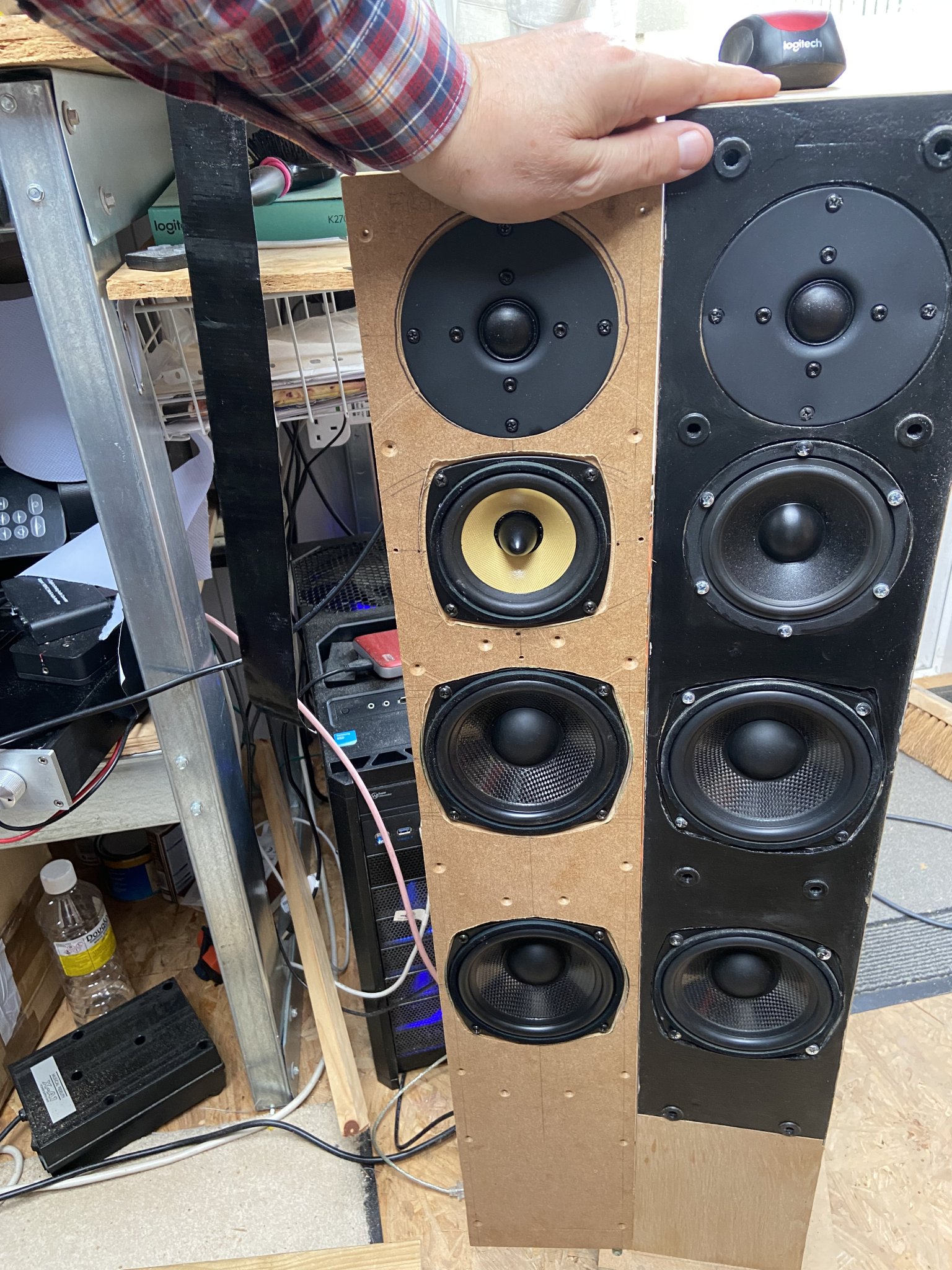

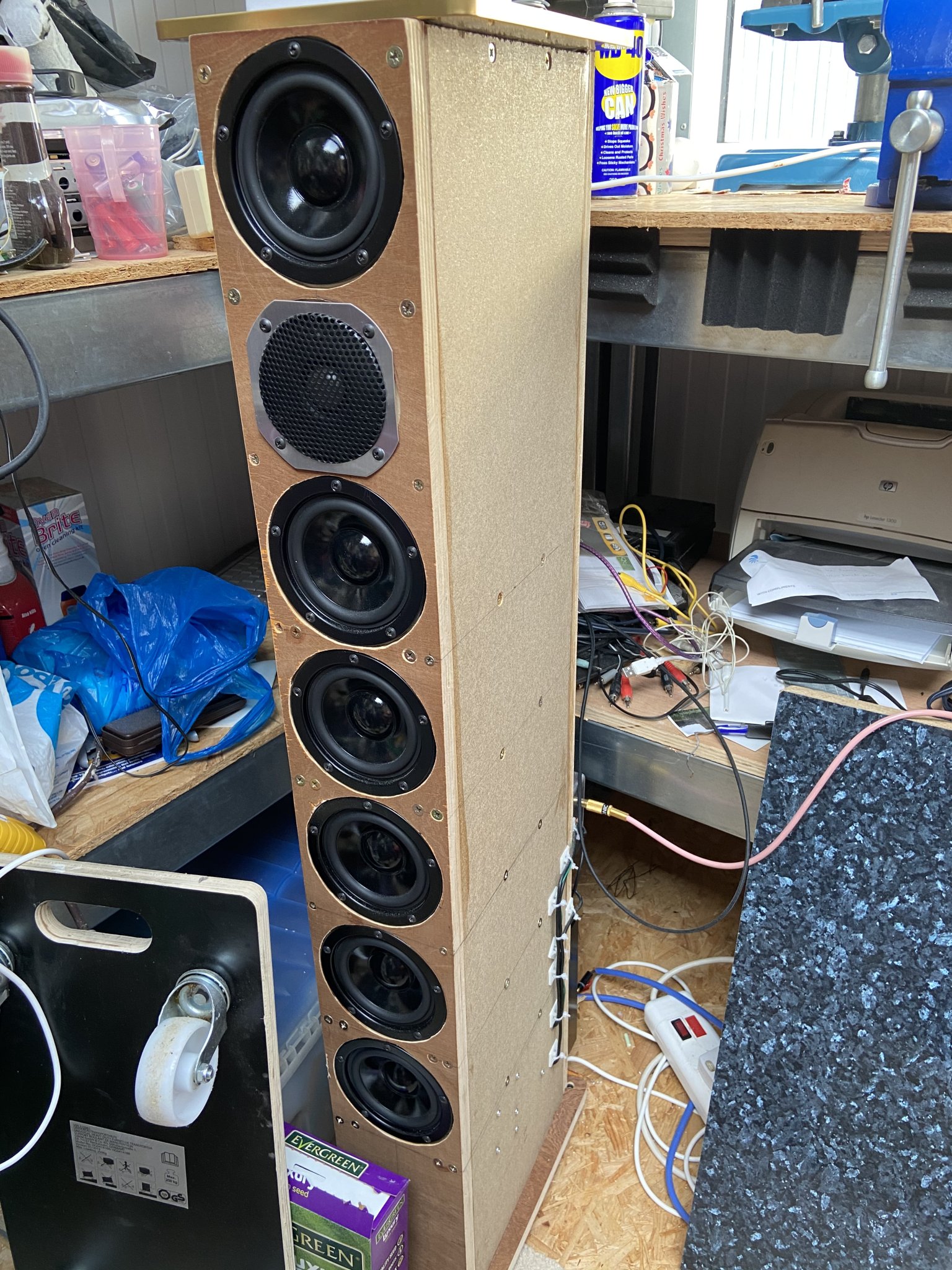

Ok, I have Few pictures 😀. Please bear in mind this is my first effort and pretty much everything was my first attempt at anything.

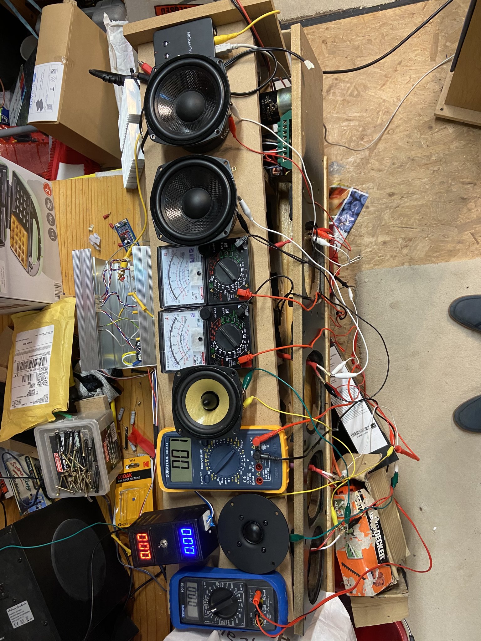

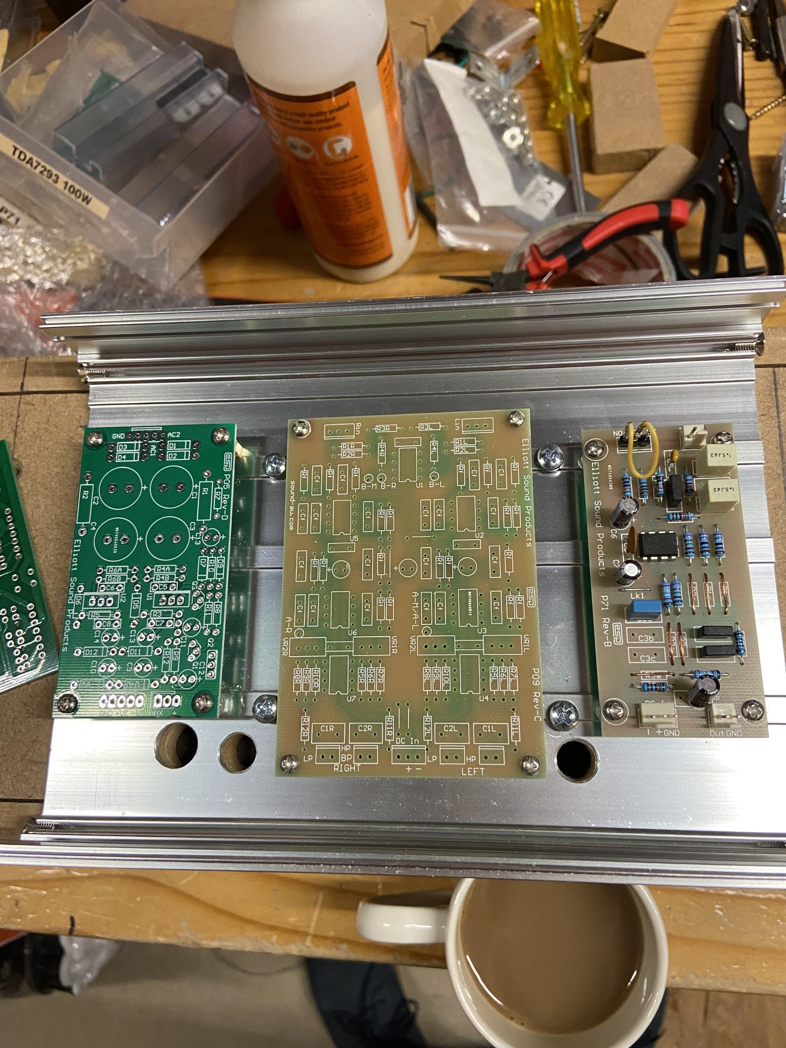

This was a bench test before assembly just to check all was good.

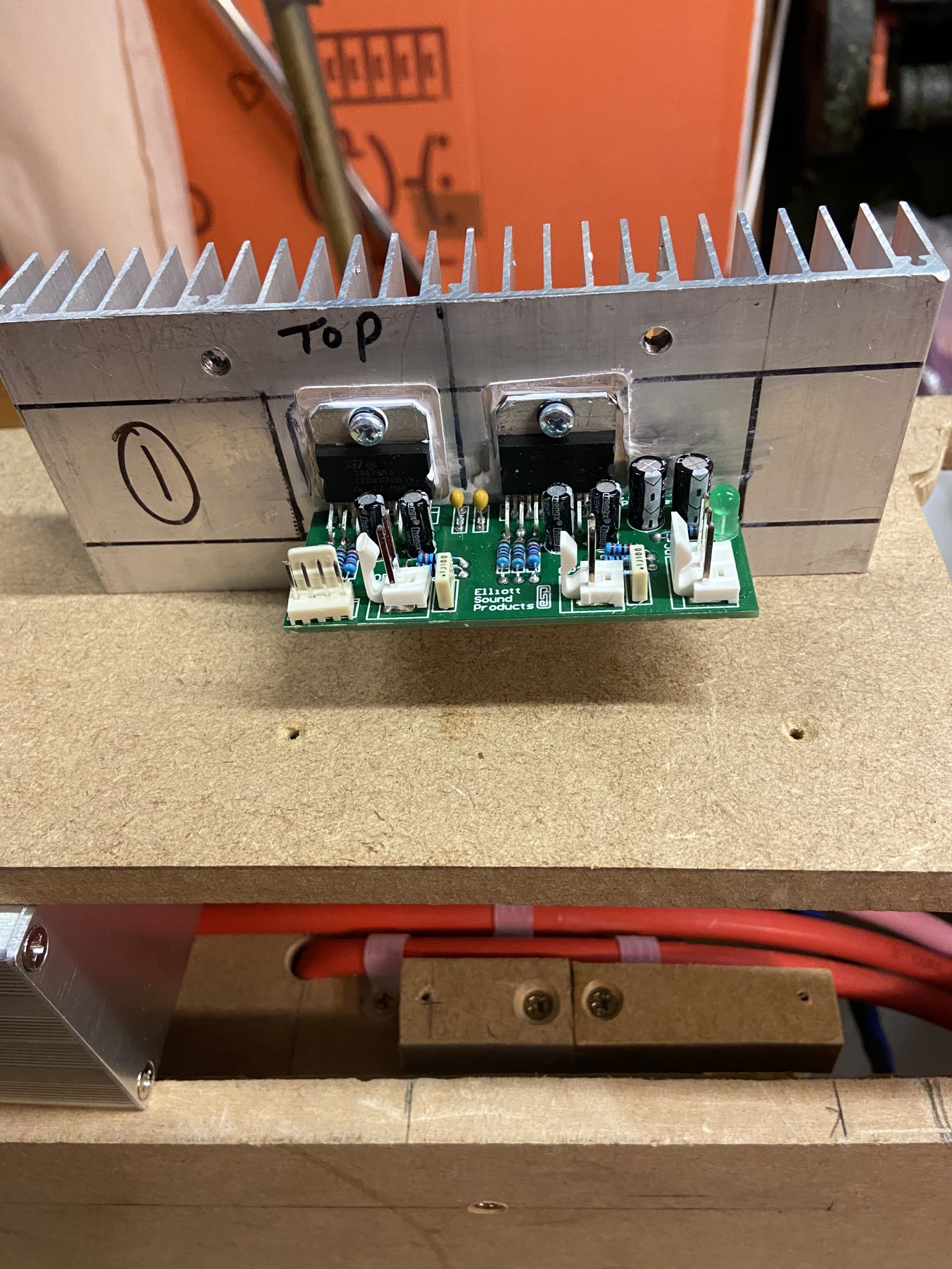

One of the two pairs of tda7293 amps fromESP.

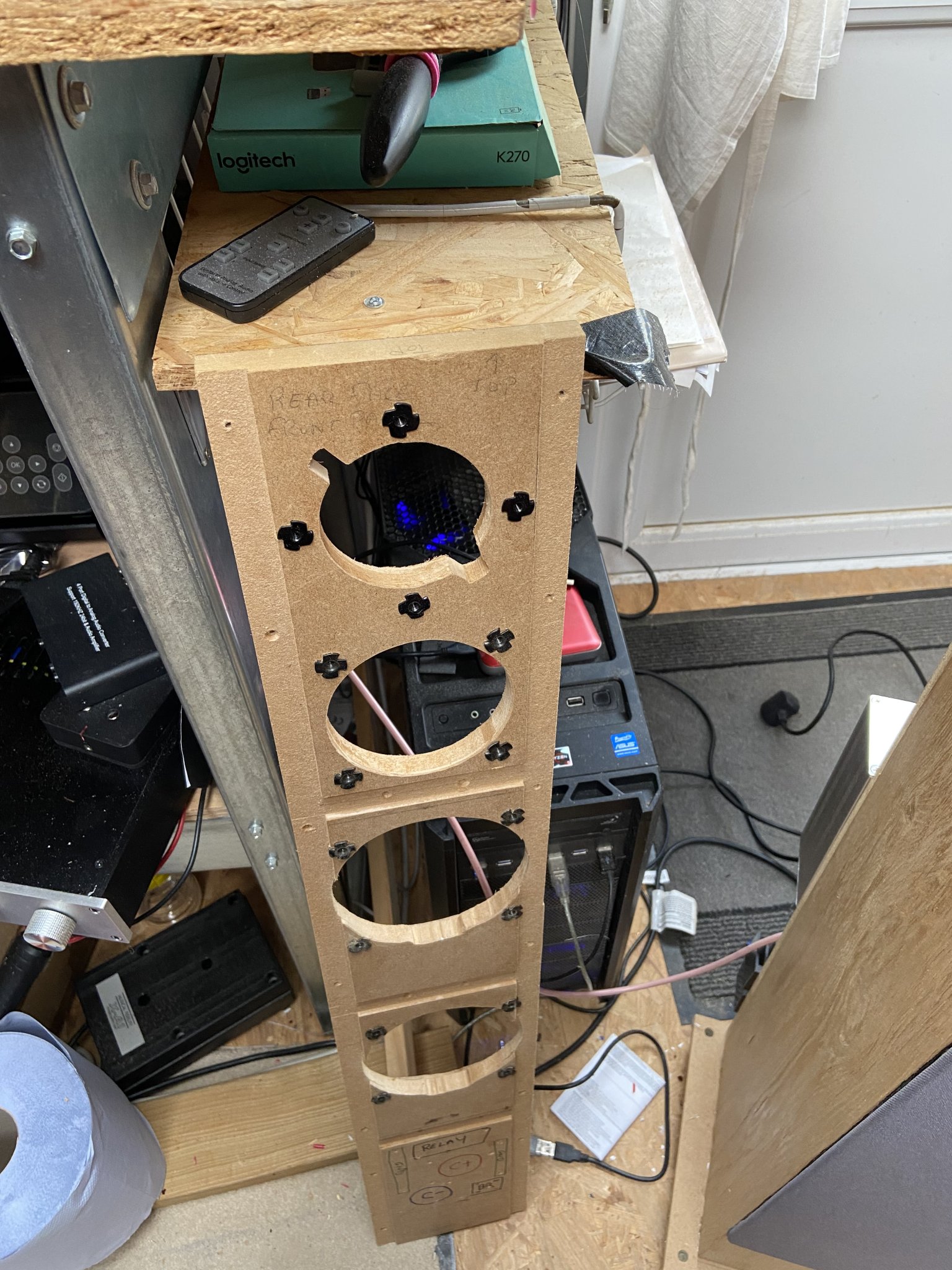

Crossover filter and regulated psu in progress.

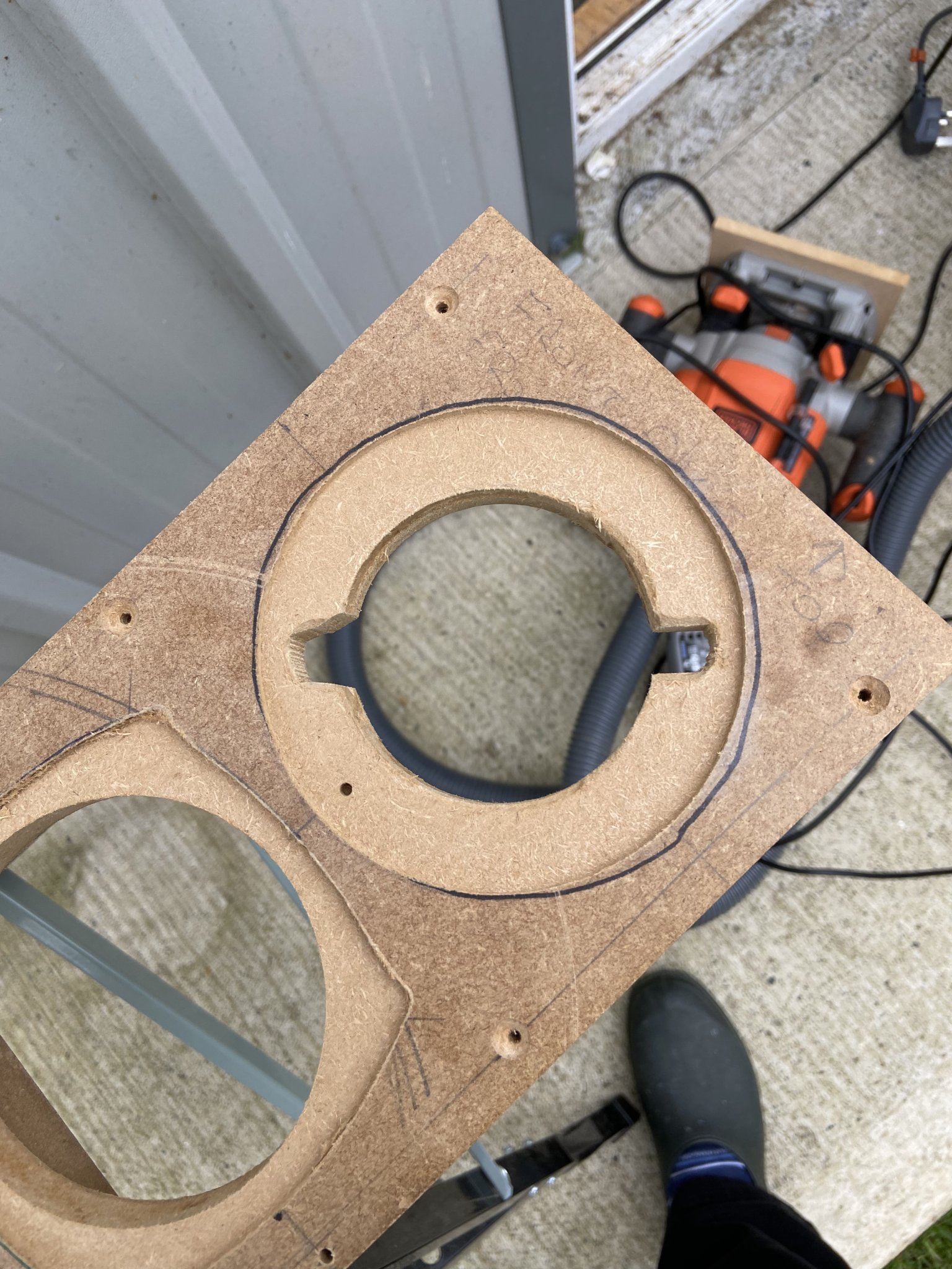

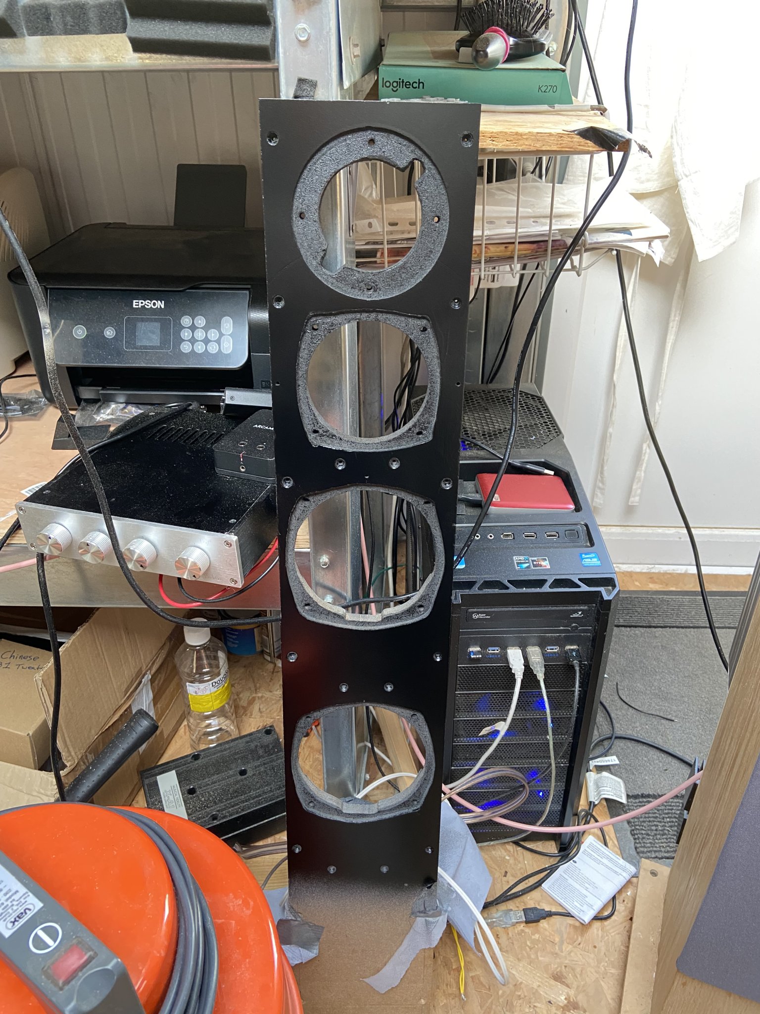

Front panel in preparation.
Rear of front panel with t-nuts inserted. You can see the side of an earlier more complete one on the right.

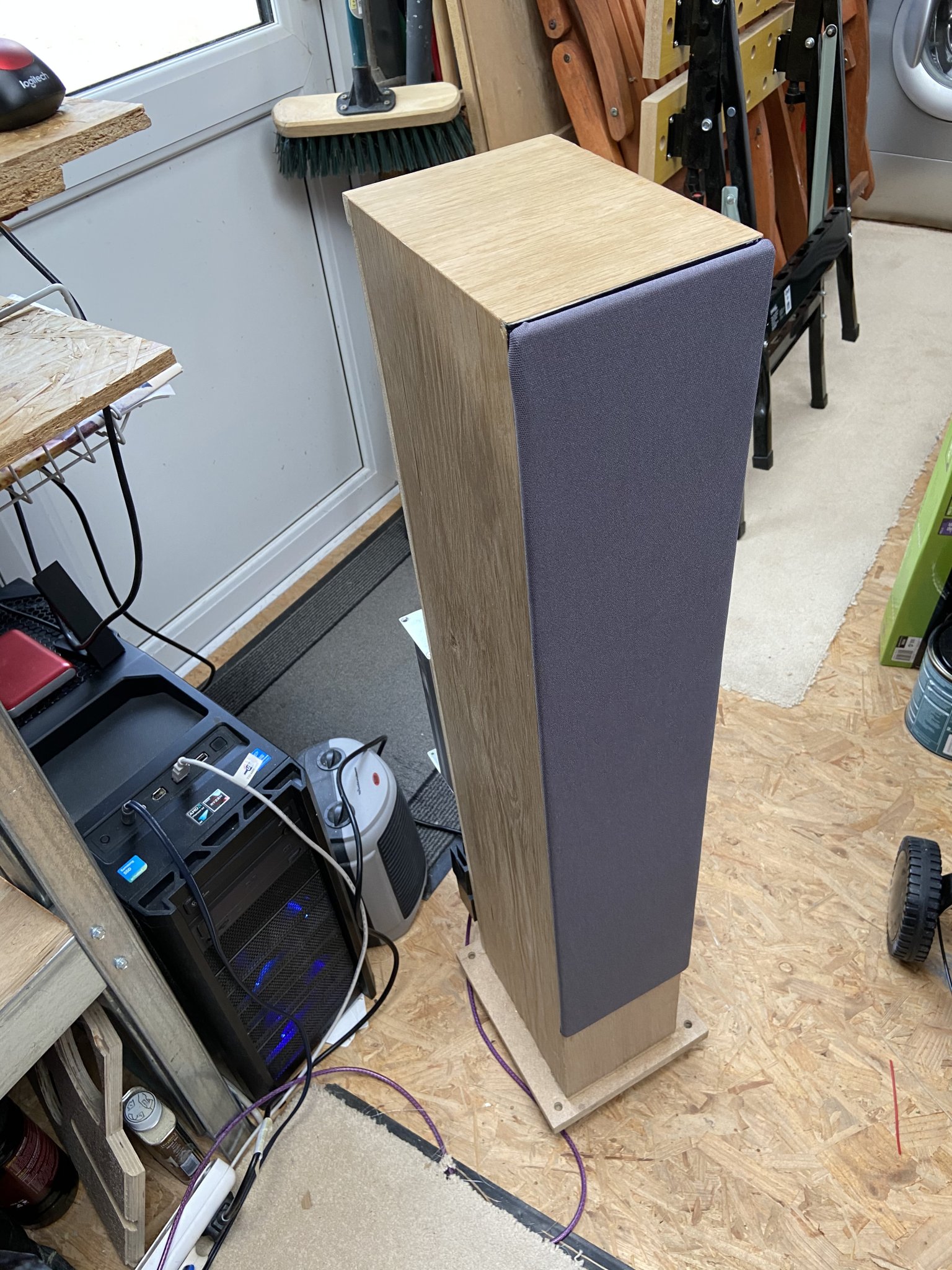

Very nearly complete here.
Prototype 2 and 3. The midrange was unobtainable for a long time so I had to substitute a Kevlar midrange for 3.
And here is the first effort. Note the external wiring to get enough separation between cables.
And finally a random picture of work in progress.
Having now read lots of build threads, I suspect no-one in their right mind would do it like I did, but they work well and I learned a hell of a lot on the way.
Thanks all for the interest. I wish you all success with your projects.

Thanks!Ok, I have Few pictures
I like them very much!
great looking speakers, the challenge you chose as first project is very inspiring.

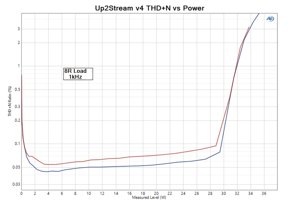

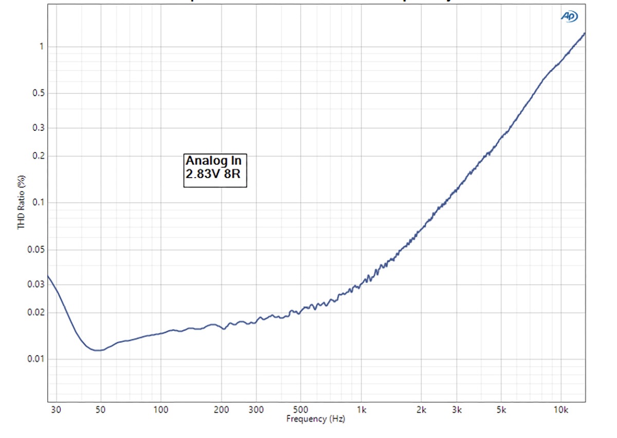

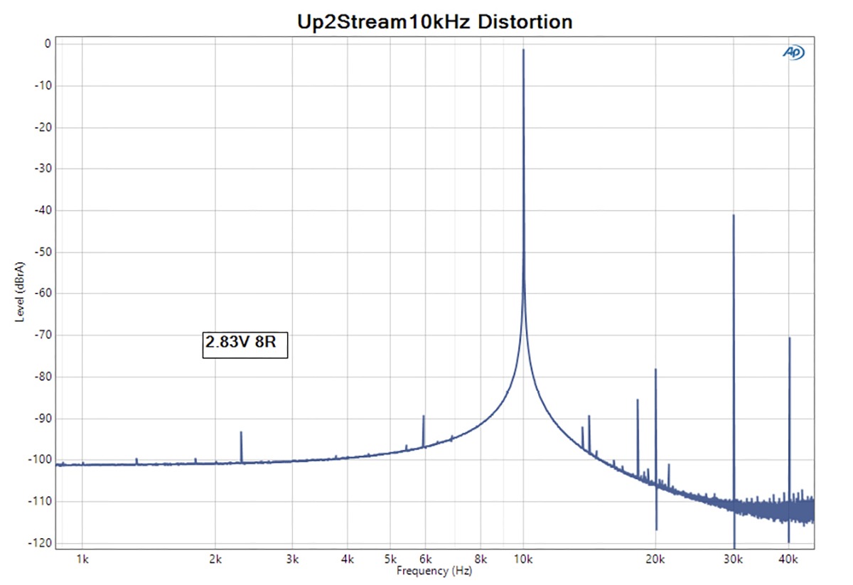

I feel the relevant performance measurements are here-
So let’s call that 30W@8 ohm power and THD for 5Khz at 0.3%.
Which is an order magnitude better than the Sure JAB5 (0.3 % vs 1% = -10dB), albeit with slightly 3dB less power (50W vs 100W)

Here’s some other important measurements.
OK so it’s no high end amp, but for $80 you get an app driven, wifi or BT audio streaming solution with DSP and TPA3116 amp for 50Wx2 (4 ohm)
