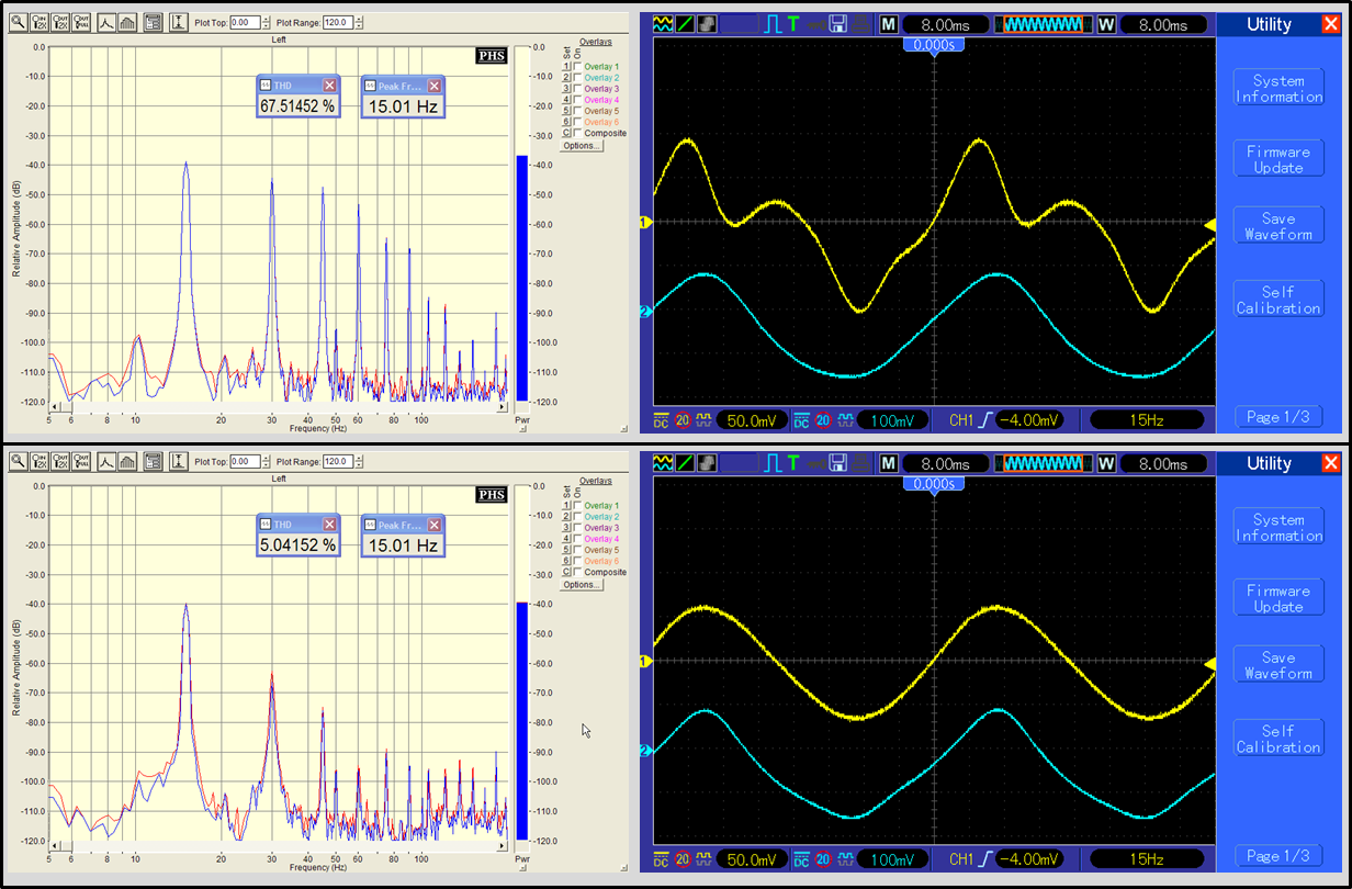

The O-scope trace talk with bentoronto reminded me I meant to comment on several of your posts where you suggested that MFB would require more power to force drivers to behavior in a linear fashion. I willingly admit that this was exactly what I had thought…until I actually built a MFB system and looked at O-scope traces. If you look at the waveform distortion generated by woofers operating beyond Xmax, the sinewave shape does not get clipped or tend to flat-top the way you might expect. Rather, you will see a triangular shape(3rd harmonic like square wave, but opposite sine). This puzzled my for quite some time before stumbling on an old Wireless World article that explained why(I’ll post it if I can find it). Basically it boils down to the phase difference between force application and cone acceleration(SPL) and operating in stiffness dominated range below resonance. With matched magnitude of fundamental, the waveform actually peaks at amplitudes higher than with no distortion. So, if distortion is predominately 3rd harmonic the woofer is actually driven less hard by MFB at particular times in order to clean up the distortion and leave the same level of fundamental. Power requirement for reducing 2nd harmonic is less clear, but in general terms MFB requires a little more drive during half the period, and a little less during the other. In any case, the differences in amplitude we are talking about is pretty minor. The take-home is that low frequency distortion reduction by MFB does not require significantly more power or generate more VC heat to produce the same fundamental SPL as a non-MFB system.
The distortion levels shown in the attached waveforms were about 20% without MFB, and 8% with MFB. This was from a VC feedback system, showing about 3x reduction, which is typically about as good as I could get with VC feedback. I know I’ve seen pics of an even better comparison(not mine) here on diyAudio(I think) where there was significantly more distortion and much more 2nd harmonic. Will see if I can track that down…
On the topic of woofer distortion and drive level, meant to comment on this as well.
In my experience, distortion tends to increase at a fairly moderate rate. In this case they increased output by ~9.5dB, so ~3x applied voltage, ~9x applied power, and the distortion only went up by about 2x. So, not exactly an exponential rate relative to increased voltage or power. I don’t think you’ll see exponential behavior until suspension starts reaching end of throw limits.If there was another chart showing distortion levels at 90 db, the distortion levels would be VERY low, as the distortion is ramping up at exponential rates with increased power level.
Great to have more data points from bolserst.
While the attached traces show how much cleaner the VC MF performance is, hard to intuit how bad that is perceptually or, at least for me, to connect the wavy lines to %THD numbers.

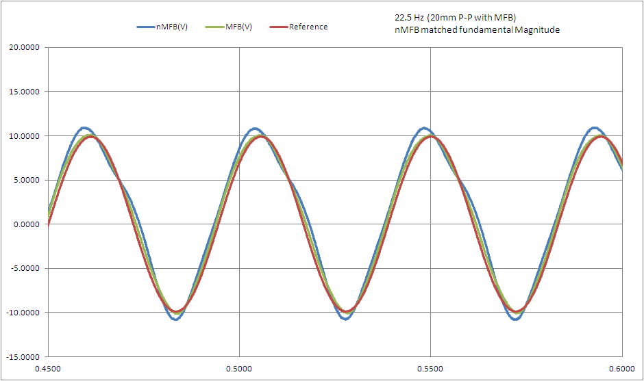

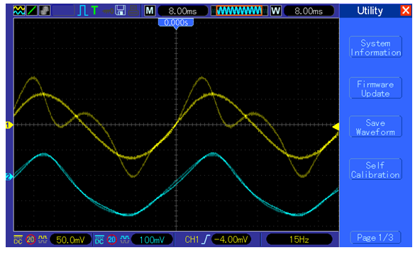

I did locate the higher distortion plots I was thinking of.
The first attachment shows harmonic content and wave forms with and without MFB for matched fundamental amplitude.
The second attachment is an overlay of the waveforms so you can see more clearly the differences in input voltage(blue curve) and output SPL(yellow curve).
Looking at the peaky, kinked no-MFB output, you would never guess the minute changes to input voltage required to clean it up from 67% to 5% THD.

Might try to answer my own question.Likewise, apropos those wonderful charts you posted (a few posts after), what is the mechanistic explanation for the hideous 15 Hz non-MFB waveform and why does such a tiny change to the MFB signal make so much difference?
I guess what we are seeing with the hideous non-MFB wave is that all those higher frequency distortion notes are piling up early in the wave form (they pile up early because they are faster). So there is a peak before the true wave peak and there is a lowering after the true wave peak.
But still mysterious how such a small change in the MFB drive signal can make such a big change in the audio output waveform?

Bolserst,With matched magnitude of fundamental, the waveform actually peaks at amplitudes higher than with no distortion. So, if distortion is predominately 3rd harmonic the woofer is actually driven less hard by MFB at particular times in order to clean up the distortion and leave the same level of fundamental. Power requirement for reducing 2nd harmonic is less clear, but in general terms MFB requires a little more drive during half the period, and a little less during the other. In any case, the differences in amplitude we are talking about is pretty minor.
1)The take-home is that low frequency distortion reduction by MFB does not require significantly more power or generate more VC heat to produce the same fundamental SPL as a non-MFB system.
2)My post was concerning BL tapering, although moderate suspension stiffness increase is included since all woofers have it to some extent. All that was being illustrated was that the tapering off of BL does not necessarily mandate a significant additional voltage input to the woofer to correct the resulting distortion…as odd as that may seem. Then again, looking at triangle waves coming from your woofer when intuition says they should be flat-topped squarish looking waves(like when tube amps clip) is pretty odd too.
3)The additional thermal stress from driving a single woofer harder than you would a multi-woofer system is a very real concern. It must be considered when sizing the amp and the intended use. It is no coincidence that subwoofers intended for concert or dance hall use have higher long term thermal capability than those intended for hi-fi use.
4)I’m not sure about what happens if you have a woofer with a particularly steep increase in suspension stiffness when stroke starts exceeds Xmax(based on BL). That is not a type of woofer I would ever choose for a MFB project…or any hi-fi project for that matter. If the suspension stiffness is that nonlinear, why would you use it at all?...perhaps to keep auto-boom-boom types from overstroking and destroying it? If you wanted to keep distortion below audible thresholds without MFB, you would have to avoid stroke that reached the steep increase point. If I can locate a woofer like this I can borrow, I will give it a test-drive beyond the threshold with MFB, for science….well that and morbid curiosity.
5)The air-spring will get harder to push with increasing stroke…that is the very definition of a spring F=K*x. But, the change in the spring constant(K) during a complete in-out cycle which would cause distortion is comparatively small once you crunch the numbers. Also, since this variation in K during the stroke results in 2nd harmonic distortion, it wouldn’t require additional net power to overcome anyways.
6)The first attachment shows harmonic content and wave forms with and without MFB for matched fundamental amplitude.

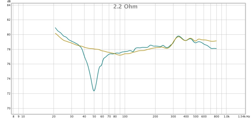

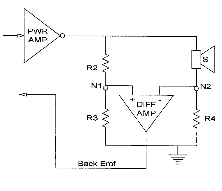

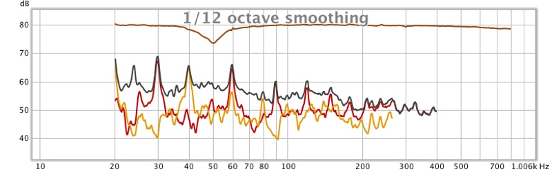

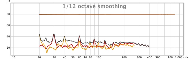

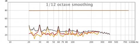

Here we go, using 2.2 Ohm resistor connected to a 15-inch, 8 Ohm driver in a 6 cu ft sealed box.BTW, in 5 minutes, anybody can eyeball their speaker error - no mic needed. Just connect a small resistor (.5 or 1 Ohm) to your speaker ground-side terminal and do an REW sweep of the electric signal. It will also reveal distortion and your speaker resonances will be obvious. And you may even see the VC inductance show up at higher frequencies.
Simple as that. You are looking at your rudimentary VC MFB signal
The first chart shows the signal to the speaker. Pretty flat considering it is a quite low voltage signal after passing through a gazillion junctions, a Behringer DSP, a 1975 JVC receiver I bought at the Salvation Army for $20 and other digital boxes between John Mulcahy's house and this picture*. Distortion, noise, and hum with my long alligator clips and going back over those gazillion junctions clocks in around 55 dB, as shown by the THD black trace. The other traces are 2nd and 4rd harmonic.
The second chart shows the signal at the top end of the 2.2 Ohm series resistor. Since the driver is adding its own personality and fluctuating back-EMF (fluctuating due to distortion), that is reflected in the voltage across the resistor. THD is a lot more, maybe like -30dB, but I don't know what that really means quantitatively or in terms of what could be accomplished with MF.
The third chart compares the two runs and shows where MF would be applied if you used this crude method. Where the resistor signal is low (because the excessive/distorted moving driver grabs more voltage to itself), you would be cutting the signal to the speaker. For example, at 50 Hz where the speaker resonance is too loud. Where the driver is balking (like the band below resonance), you'd add more power (without MF, you'd be fooling with EQ, a very blunt tool in real-world rooms).
At the right end, you can see the driver's inductance is adding to its impedance and so the voltage across the resistor is lower. You wouldn't be compensating for that in any simple way, but I'm just illustrating the point for readers.
Yup, simple as that.
Using a Wheatstone Bridge instead of a simple series resistor would magnify the sensitivity of the sensor but then you'd have circuit grounding issues to fuss with and still have various-sized shortcomings of VC MF.
Ben

Ben,Here we go, using 2.2 Ohm resistor connected to a 15-inch, 8 Ohm driver in a 6 cu ft sealed box.
The first chart shows the signal to the speaker. Pretty flat considering it is a quite low voltage signal after passing through a gazillion junctions...Distortion, noise, and hum with my long alligator clips and going back over those gazillion junctions clocks in around 55 dB, as shown by the THD black trace. The other traces are 2nd and 4rd harmonic.
*with a proper shielded test set-up, the THD generally achieves better than 80 dB (.01%)
*Considering you want to test THD hopefully less than the 10% a typical good driver exhibits at Xmax, you will need a bit of work on the 25% discrepancy between 55 and 80 dB. If you wrap your alligator clip leads into twisted pairs, they will cancel out most of the usual household noise.
In audio "hi-fi" circles, none of your charts look "pretty flat", which would generally be considered within +/- 3 dB.
What does the SPL measure when distortion, noise, and hum clocks in around 55 dB below it?
Good luck,
Have fun!
Art
The purpose for posting the charts was to encourage other people to discover the errors and the error signals lurking in their speakers. For basic series resistor or Wheatstone Bridge VC feedback, you'd likely not want more than .5 Ohm sitting there.Ben,

*very conveniently, the "headphone jack" on some Mac laptops (such as the Air I use for my music server) takes a trick 4 wire plug and so works directly with the IMM USB mic.
Ben,I note your well-intentioned advice about shielding my leads even if you don't understand that it wouldn't matter much with a minuscule 2 Ohm load.
I have been using the mic in and line out on my Mac Laptop and desktop units for dual FFT testing for 10 years or so, got tired of lugging a large USB mixer around when a simple analog in/out adapter box worked fine. The impedance of the load has no bearing whatsoever regarding SN ratios, the SN of the mic pre-amp "is what it is", in addition to upsteam noise it captures and amplifies.
The "output resistance" you may have measured at 2 ohms is simply a series resistor in curcit to prevent the headphone amp from being shorted while plugging in whatever you decide to plug in to the hole, headphones, adapters, paper clips, screws or what have you .
Shielded twisted pair can get another dB or so SN over a balanced twisted pair, but I was suggesting a "free" fix, knowing your adversity to spending any $$ you can avoid.
My advice did not include shielding, it suggested twisted pair wire, which increases CMR (common mode noise regection) of the usual RF and 60Hz (and harmonics) mains "hum" far more than shielding.
For shielding to be effective for both RF and mains noise, MU metal, as used in the shielding cases on expensive audio in/out transformers, must be used, but effective design and placement proximity has largely eliminated the need for MU metal other than RF prone locations. Examples still requiring MU metal would be radio station studios with their sloppy broadcast antenna located on their roof, or sound studios located in close proximity to the "line of fire" of megawatt RF transmitters.
Getting SN to approach 80 to 100 dB in those situations is a challenge, while in typical homes, not difficult if you attend to some basics, and keep the exposed high gain portions balanced lines.

The signal you have plotted is proportional to the current thru the VC. If you measured the impedance, and then calculated the current for a given voltage input and multiplied by the value of your resistor, you would get this curve. Note that it is flat below resonance, where the sealed box woofer response is falling -12dB/oct. So, as I mentioned previously, if you try to use this as a MFB signal you will not flatten this falling response.… using 2.2 Ohm resistor connected to a 15-inch, 8 Ohm driver in a 6 cu ft sealed box….The second chart shows the signal at the top end of the 2.2 Ohm series resistor. Since the driver is adding its own personality and fluctuating back-EMF (fluctuating due to distortion), that is reflected in the voltage across the resistor.
BTW, what woofer is that? If your measurement is correct, it could not be the Brutus 15.
With the dip in the current being only ~7dB the impedance peak would at most be 2x to 3x of Re.
This indicates a pretty weak motor with Qe likely over 2.0.
The Brutus 15 should have close to a 20dB notch in its current signal measurement.
As mentioned above, the signal at the top end of your series resistor is just showing you the current thru your voice coil. Rather than calculating it as applied voltage divided by impedance, you could calculate it as (applied voltage – back EMF) / (blocked impedance) and get the same answer. What is useful for MFB is the back EMF voltage since it is proportional to cone motion (ie velocity). The bridge arrangement does not “magnify the sensitivity of the sensor”. Rather, it enables you to extract that portion of the signal you are interested in (ie back EMF) from the total voltage measured at the sense resistor.Using a Wheatstone Bridge instead of a simple series resistor would magnify the sensitivity of the sensor but then you'd have circuit grounding issues to fuss with and still have various-sized shortcomings of VC MF.
I can post some example plots illustrating this if it would be of help.
A great difficulty is the presence of a not-EMF signal from the extracted voltage, that is what is due to the part of the impedance of the driver which is not related to the movement of the voice coil in the gap. It needs compensation which can only be very approximative because the voice coil presents :
- a value of inductance which is variable with the frequency and with its position in the gap
- a value of resistance which is variable with frequency, increasing at high frequencies.
These facts seems to have limited the amount of feedback which can be applied to the Wheatstone based servo-systems to 12 dB.
My experience concerning the need for impedance compensation is in complete agreement with your statements.
I was ignoring the complications in the previous post to try and more clearly show how/why the back-emf signal is extracted with the bridge circuit.
Not sure if you saw the measurements I posted showing the effects of ignoring compensation and VC heating.
See attachments and last paragraph of Post#209.
The other thing shown in Post#209 that initially surprised me was that the uncompensated bridge signal matches the signal from the second VC of a DVC woofer. In that case, corruption of the back-emf signal is coming from mutual coupling between the driven VC and the signal VC. Once you draw out the equivalent circuits for each, you can see why this is so.
Since compensation is a compromise at best which eats into phase/gain margin and limits usable loop gain, I found it best to use only woofers for which the need for compensation is pushed above the desired upper bandwidth of the woofer.
