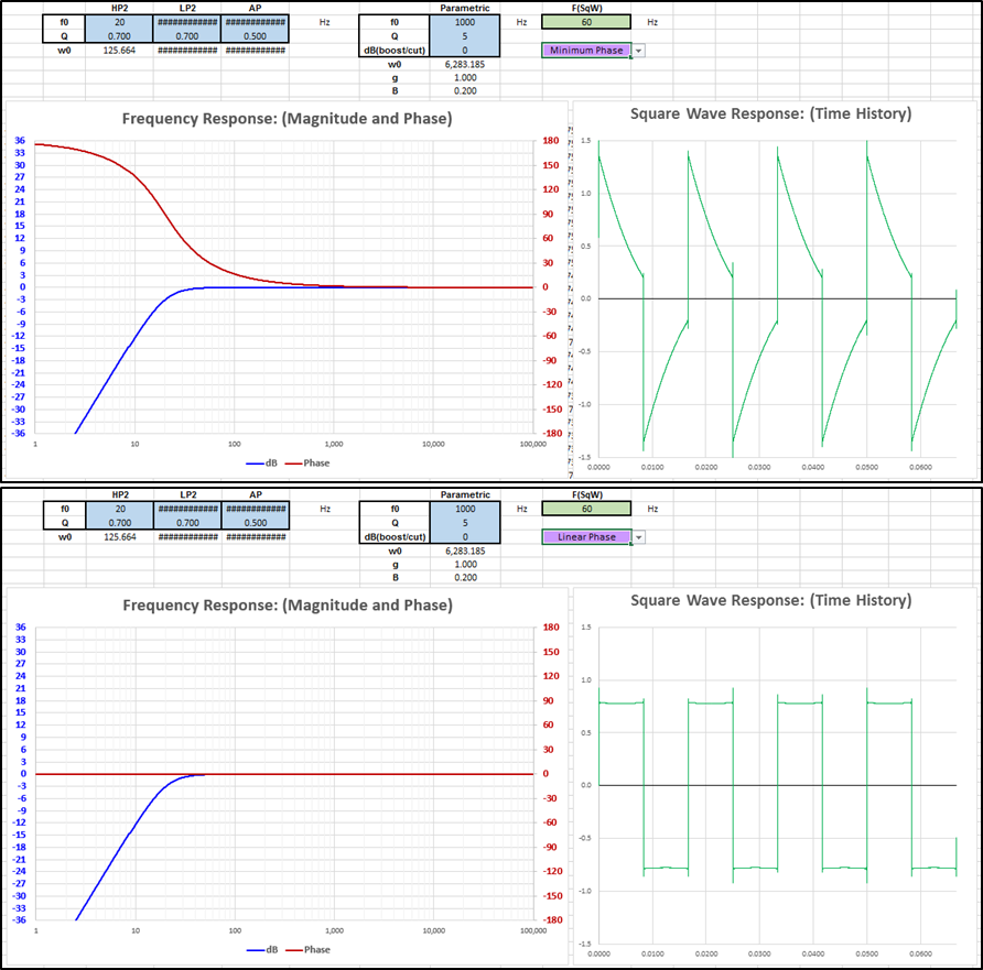

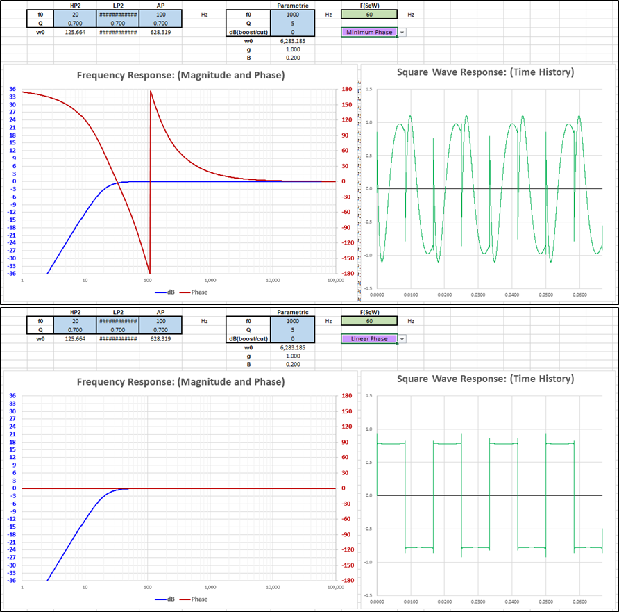

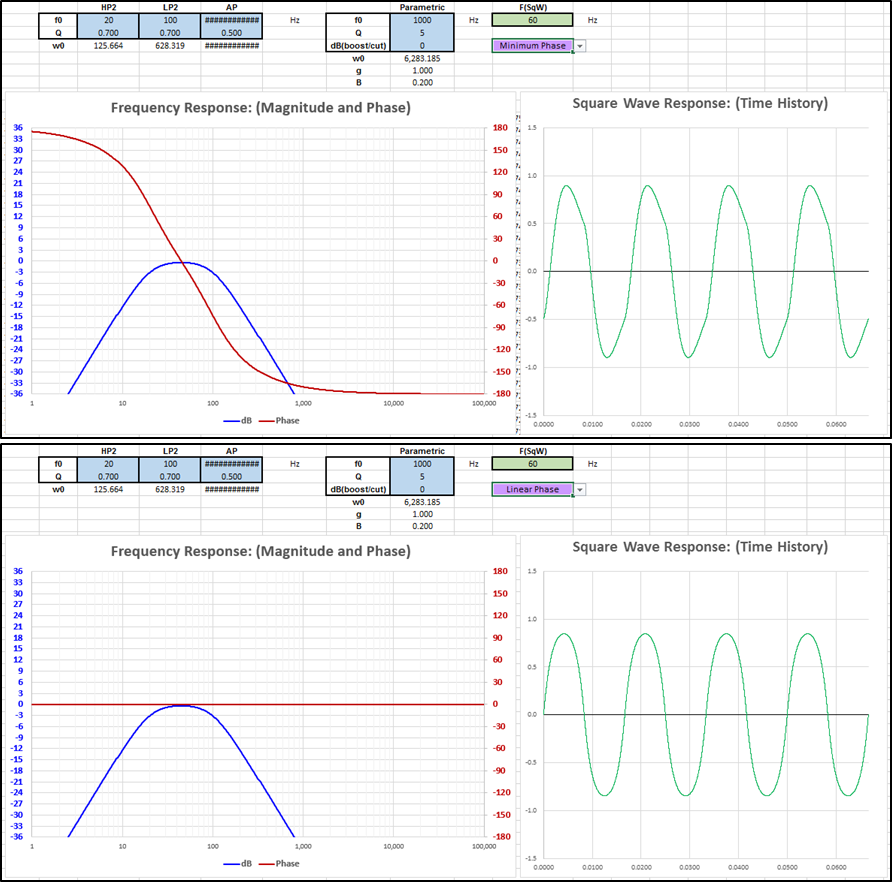

Here are a few screen shots from a square wave calculator I made to help visualize response magnitude and phase effects. It lets you define different LP or HP filters, parametric EQ, AP filter(basically phase response for a perfectly implemented crossover), whether you want minimum or linear phase, and what frequency of square wave you want to look at.
Attachment #1 60Hz Square Wave, for essentially perfect full range response with LF corner at 20hz. Note that minimum phase results in significant waveform distortion. This is what you will see from a theoretically ideal analog MFB setup.
Attachment #2 60Hz Square Wave, for essentially perfect subwoofer response with LF corner at 20hz and HF corner at 100hz. As I mentioned to you on the planar forum when discussing 10kHz square waves and ESLs, when you are bandwidth limited just above the signal frequency, you will mainly see fundamental sine wave.
Attachment #3 60Hz Square Wave, for essentially perfect subwoofer + mains response with LF corner at 20hz and crossover at 100hz. This is what most of us listen to all the time. The only way to fix the waveform distortion is by linearizing the phase with DSP.
If anybody is interested in a copy of this spreadsheet to play around with, let me know and I will see about posting a cleaned up version. You will need Excel 2007 or better.

Yes please, thanks
I'll work on getting that to you. It's a small text file but I'm not sure if attachments are allowed in PMs or not, and I'm pretty sure it's too big to simply copy and paste into a PM. I might need an email address to send it to but either way we can move this to PM.

What's the relevance of squarewaves in relation to musical reproduction? This is a novelty....Attachment #1 60Hz Square Wave, for essentially perfect full range response with LF corner at 20hz. Note that minimum phase results in significant waveform distortion. This is what you will see from a theoretically ideal analog MFB setup.
Ability to play square waves (or not) and what the system actually plays when you feed it square waves can tell you a lot about the system, which I think he succeeded in pointing out in detail. Remember, all those colorful graphs are inter-related. The frequency response, phase, group delay, impedance, etc.
As far as ability of a system to create square waves as a prerequisite for a pleasant listening experience - not necessary. But neither is pretty looking tone bursts, and some people seem to be laser focused on that as a system goal for some reason.
A reasonable dispersion pattern, on the other hand, is an absolute requirement for good sound (even though some people don't seem too bothered by obnxious tweeter bloom) unless you are listening outside with no boundaries close by. That is something that 1 square meter ESL panels will never be able to do.
