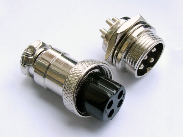

- so I'm almost finished with all mechanical parts. The only thing I now have to be certain about:
Using this umbilical chord and connectors that I have:
Four pin connector w. Shielding - ser attached photo.
I want to have a 5th wire ( ground ) in the umbilical chord in my setup.
1. Is it correct to connect this 5th wire to the metal frame / metal connector on each end of the umbilical wire?
2. Is it then also correct for me to connect the ground pads on the two main amplifier boards in the main chassis to each separate metal connector from each power amp ( I'm using dual power with two separate power chassis ) - and in the end connecting this circuit to chassis of main amp?
Please fill in if something's wrong. I also see that this is a topic that has been often discussed - and with different opinions stated- Remember : I want the fifth wire included in my setup between my two power modules and my main amp chassis.
PS: I have no problem understanding the grounding between the MEM / and transformer and the chassis of each power module.

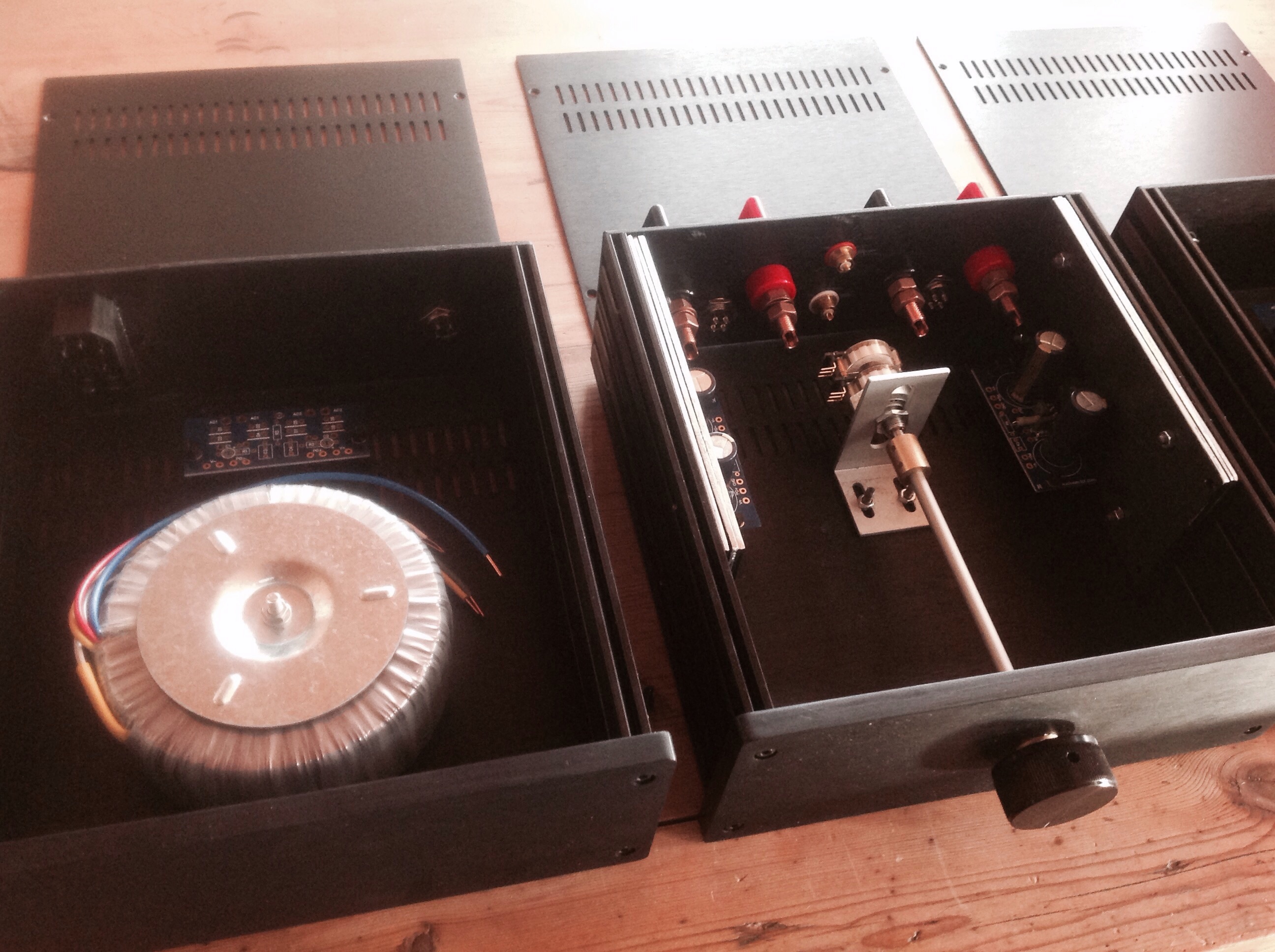

Look good, but I saw that you used 3 plates of alu, what is thickness of one ?
I hope that there is no air between each.
Phil.
... Yes, the only thing I managed to source locally at the moment.
These alu plates are screwed together with 5 screws and fasteners to the rest of the chassis. I have just dry-tested these plates- they are not fixed at the moment. No space between them, they are all straight.
They are 3mm + 2mm + 2mm = a total of 7mm thick.
I was thinking of using thermal paste between each plate.
Will my solution cause any problem?
will appreciate all inputs !

2nd try. This is difficult for me to understand.
Using this umbilical chord and connectors that I have: A four pin umbilical setup WITHOUT SHIELDING
A FIFTH WIRE BETWEEN EACH POWER CHASSIS AND THE MAIN CHASSIS.
2. In this setup is it correct for me to connect the ground pads on the two main amplifier boards to the main chassis - attached to same place where the two 5th wire (ground ) is connected from each power amp?

Yes, that would be correct
