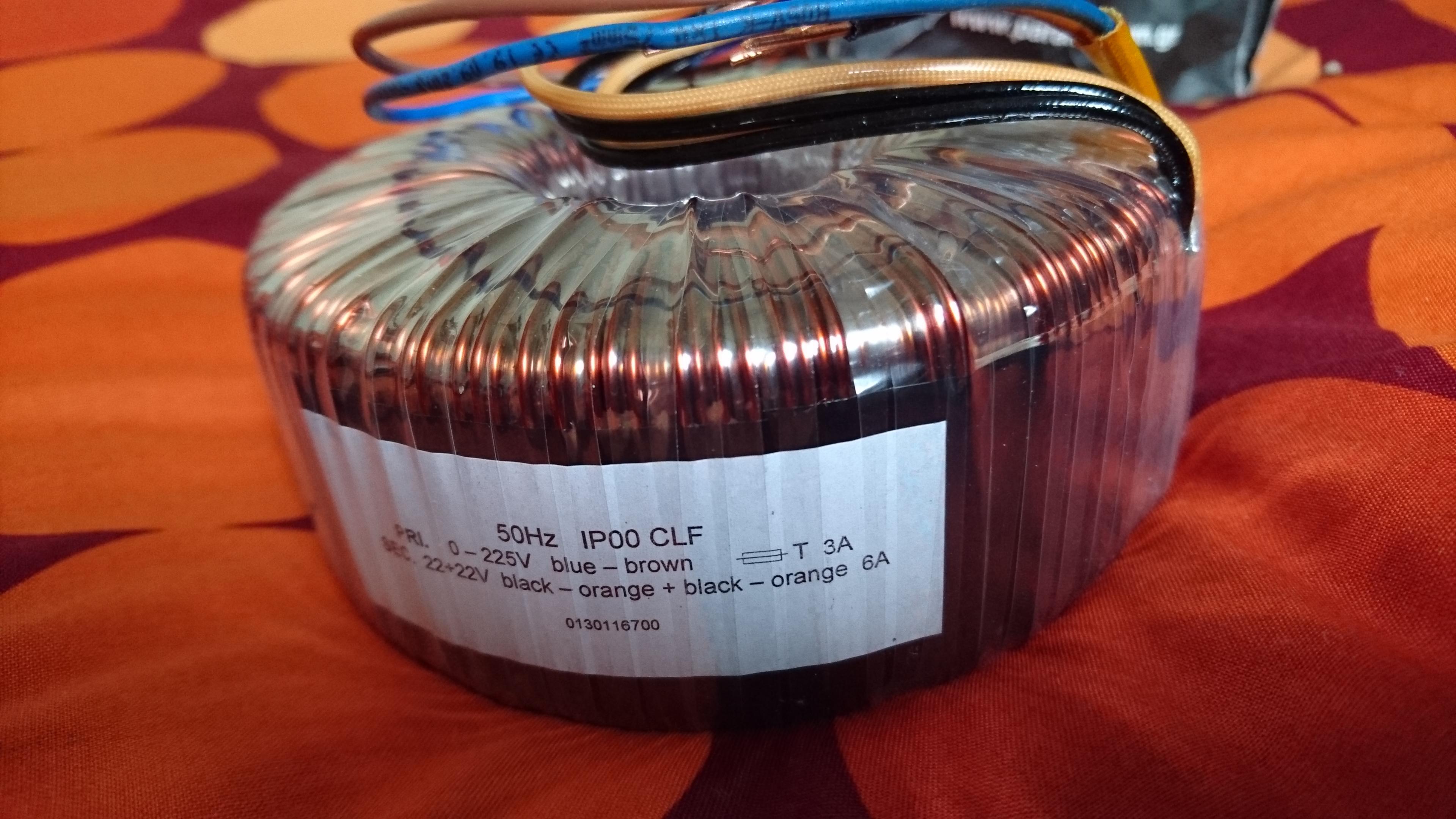

For LM3875 I read in the manual that you use always transformer 300VA for monos or stereo. For stereo some supplier advised me that it would be better instead of 1 300VA to make 2 monos with 2 160VA. What is your opinion about that?
(My speakers are small and the listening distance is small too (about 80cm))
