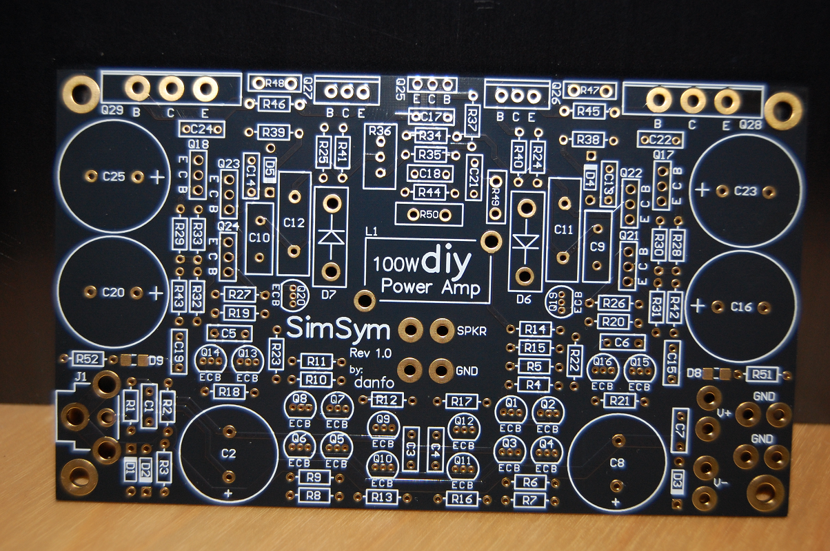

This was supposed to be a simple symmetric (SimSym) amp but now it's not so simple anymore and with optos etc it will defenately not be simple.
I'll keep the idea with optos in the back of my head maybe for a later project.
Did some final changes (changed 56pF caps to silvered mica ones because the one I had chosen from Elfa isn't beeing stocked anymore).
Right now I got my finger on the order button.

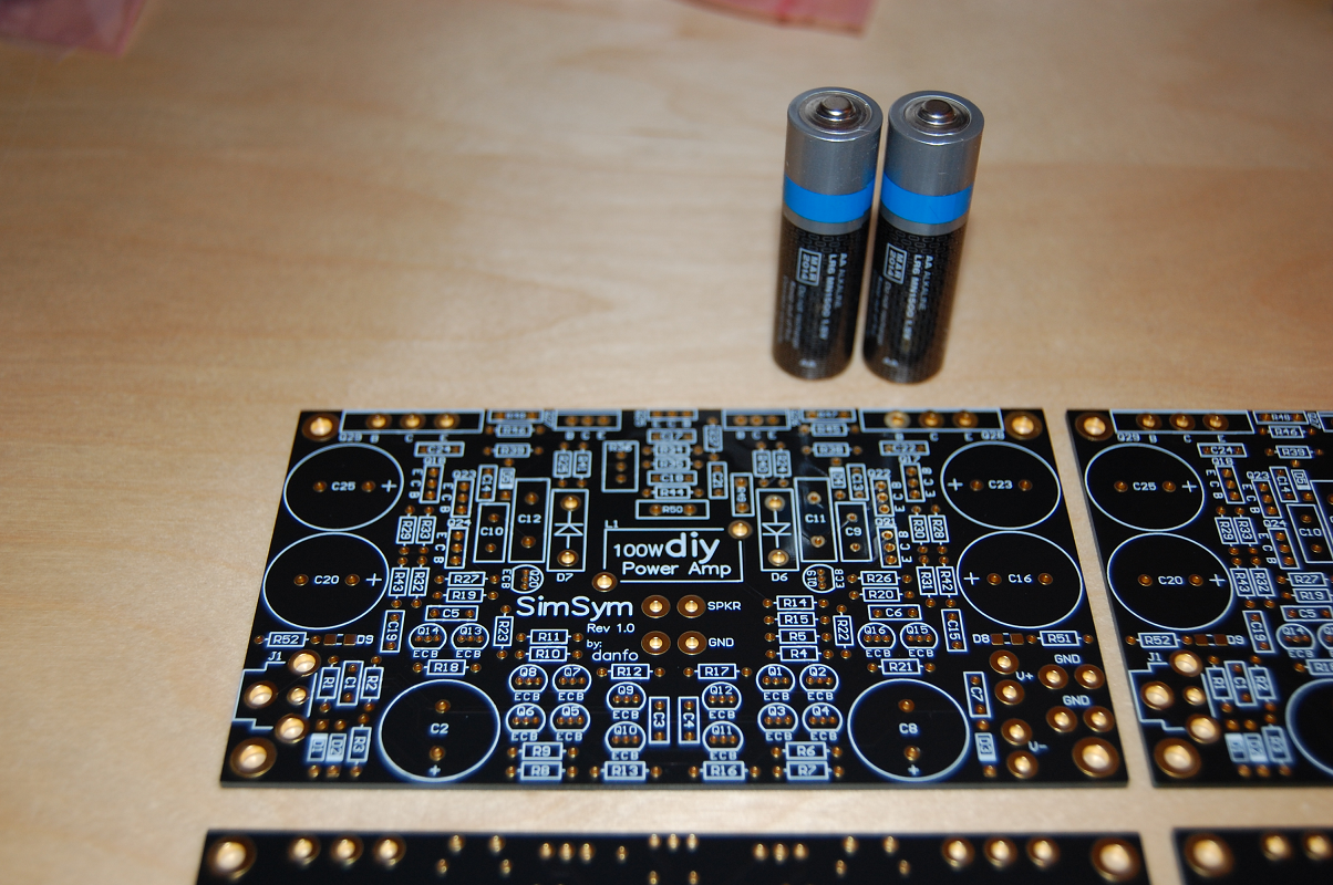

It's been a while but finally I've assembled the amplifier and tested it. And it works! I'm going to have to adjust som values in the vbe multiplier though because the maximum quiescent current I can set is ~37 mA and according to the sim it should be ~80 mA.
I'll post some high res pictures later but for now I made a little video.
YouTube - Testing the SimSym Amplifier
The power dissipated in idle is 12 W according to my bench supplies and my multimeter. That's 120 mA @ 100 V and it gets me a bit worried because the currents just don't add up. According to the sim I should get a total of 76 mA @ 100 V in idle.
But anyway it seems to work fine I've been playing for hours (not very loud though) and no smoke yet.

To get the quiescent current I measure the voltage drop over the 0R1 emitter resistors (both at 3.7 mV with R36=0R). To get the total current I've measured the current coming out/in of/to the +-50 V rails with my multimeter in series and the bench supplies also confirms 120 mA.
The bench supplies show 25 V in the video but it's a 2x0-30 V supply with a button to series connect both supplies so it's 2x25 V per supply.
I haven't done any more measurements. The card is so compact and packet with components that it's hard to get access without accidentally shorting something.
I forgot to include the zener current for the cascode biasing so the total should be 81 mA.

I've done some further measurements on the total current consumption and now my multimeter shows 90 mA on both rails (it's a velleman DVM92, I really need to get a better one). I also revisited the simulation and it says 94 mA on the positive rail and 92 mA on the negative rail (with 39 mA quiescent current) so now it seems that all the currents do add up.
However the bench supply still shows 120 mA but I don't trust it.
The dc offset is 2 mV according to the velleman, (simulator says 17 mV).
I've also measured the voltage drop over the 22R filter resistors ~0.9 V and that checks out with the simulator.
