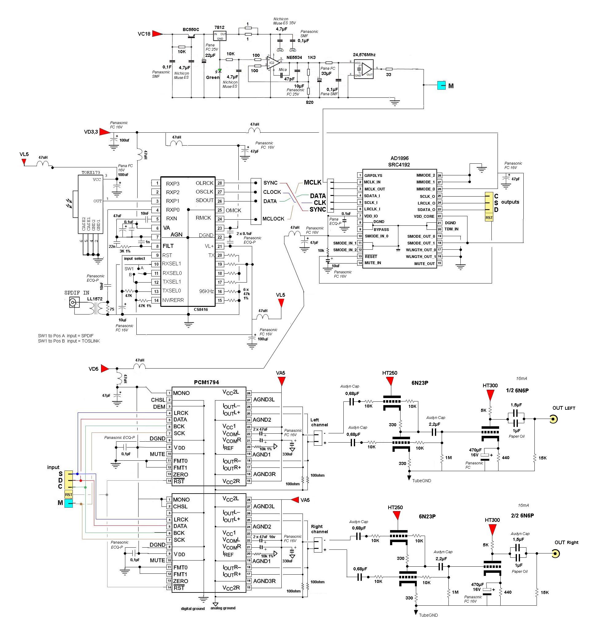

I'll just route the resistors topside and easily removable on the prototype board, and see what happens. Sadly, I have no scope or other measuring equipment, so all I can rely on is my ears.
I can't find any DIT jitter info on AK4114 or 4115, but I'll just try both with and without SRC and see if there's any difference. Or just screw it and tell myself it's good enough without SRC...
if you put 1206 chip R pattern in series supply position you can always try ferrite bead core lossy inductors too - 0805 fit 1206 lands good enough for hand assembly so either could be used
I'd be frightened to think someone without a 'scope would tackle the Hawksford nested multiloop op amp I/V - its not a established diy project with any history - lots of possible bugs, parts selection subtleties, MHz oscillation to check for - even if layed out properly

I know this goes against the DIY spirit, but I'm not sure I want to venture into the world of scopes. There's simply too much learning and experience involved for me to enjoy it on a hobby level. And inductors are another design aspect I really don't want to have to learn, but some simple suggestions are welcome. Russ White uses CLC (10uF > unknown L > 0.1uF) on each rail on the 1794 in his COD, which afaik is pretty good.

I was thinking about your comment of C-L-C on the supply lines...
As L has 600 ohms (!) and supply current to PCM1794A in order of 10's mA... did you considered ripple noise if current supply suffer some spikes sinc'ed with MCK? A small step of 0.5 mA in supply lines would result in 300mV step :eek: noise in supply line...:confused:
I must being overcome several aspects, but... i'm not inclined to put so high R in series with the DAC chip supply....

The use of inductors in the power lines is quite useful imo, they filter the power going into them, but also filter out any junk the device might create, from reaching the other power pins. Using the scope before and after the inductors in some of the DACs I've built, shows significantly more noise after the inductor then before.

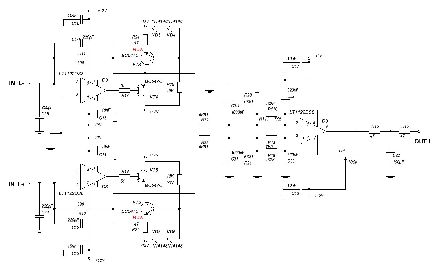

im trying to build a Pcm1794a in dual mono,can someone tell me if i should use a resistor before opamp input ?the currents were summed + 100ohm to ground
ill use something like opa2227
here is the schematics PCM1794 dual mono i/v converter - conversion - stage :
ill use 2sc2362 instead of BC547 /SA970 / 2 SC2240
