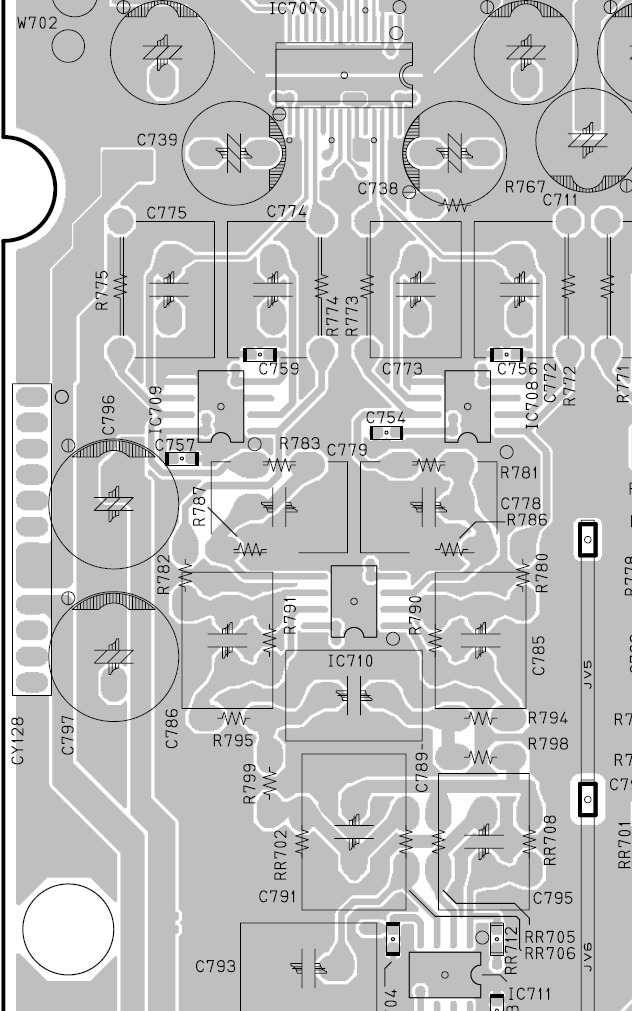

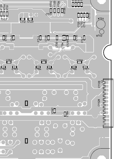

Take a look by all means, but don't try that at home:D. This is quite a good example of how not to do a DAC output stage - in particular the decoupling. Are all those thick (power) traces ground fills?
Board looks different, schematic is just that - schematic...

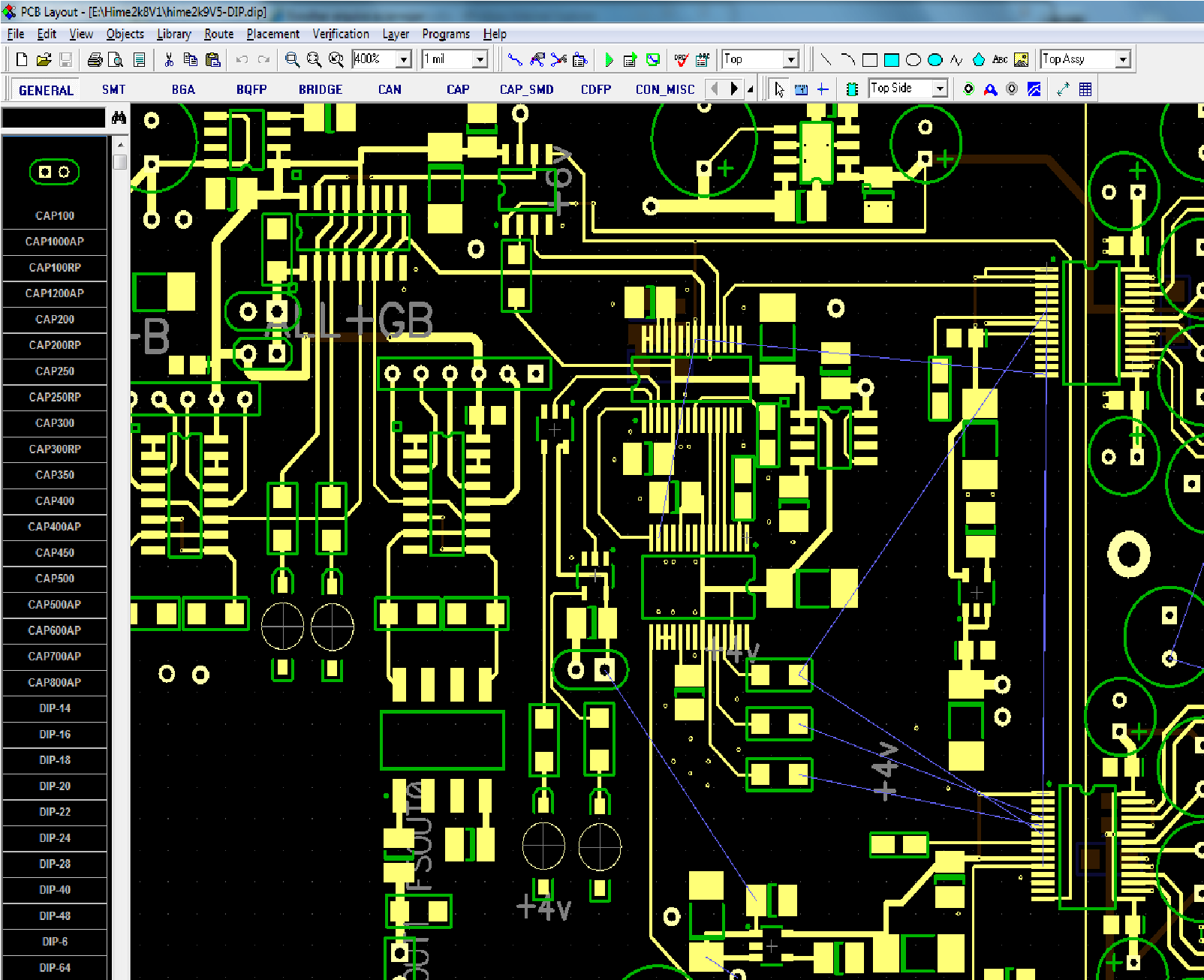

Are you really sure sensitive analog circuits are going to be better off with multiple built-in 2MHz oscillators? Especially as each reg has its own and they won't be synchronised.
Sure? Never :) But I'm trusting Pierre on this. If he says it's good, it's good enough for me. And the specs do look nice.
I'll start off with two DAC boards, with and without SRC, and shuffle things around a bit to be able to experiment with Iref resistors and PSU resistors and caps. They'll still be separate boards so I can test both zapfilter and LM4562 output stage.
If I keep the PSU resistors for each rail, how do I decide on the values? DIR draws 2x 8.3 mA, SRC draws 2 + 66 mA. DAC Idd draws 23-45 mA depending on sampling frequency and ~35 mA Icc. There's no separate power data for the three Vcc rails.
But what's IC406-2 and all the transistors for?
IC406-2 looks to be a switchable gain stage (0dB, 6dB) but I can't think why its needed. The transistors on the output side (TR402/3) are for pop/click suppression on power up/down or output muting (which is the same thing). Notice they're the 'wrong' way around - I dimly recall that a transistor connected in such a way has a lower saturation voltage.
M'kay. Just wanted to make sure I didn't have to mess with it.

Ok, I'm having a little difficulty understanding the Denon circuit... I can see that the first six opamps are the regular I/V and summing circuits, and IC406-1 single ends it all. But what's IC406-2 and all the transistors for?
Does this player support HDCD? If so the switchable gain is implemented in the analog path in this particular case. (The HDCD allows the required gain for HDCD mode to be implemented in the analog or digital domain.) The PMD-100 digital filter has a pin for external analog gain control... The other transistors are for muting - I wouldn't use them..

anyway, I'm changing layout as it was routed almost to the end. but the section between SRC and the converters was too confused.
One more note: Where did you get the information about Iref pin?? to change the resistor value does not affect performance at all? or maybe there's a range to make it work?

I appreciate all the extra work you've created for me ;) Anyhoo, two questions still remain - PSU resistors and decoupling caps.
abraxalito said:
also I don't think 10 Ohms series R in all of your chip supplies is necessarily a good idea - you need to know each supply pin's current load frequency spectrum and psrr sensitivities to determine if/how low DC Z is needed
Do I drop'em or keep'em? And if I keep them, how do I determine the best value?
And the always interesting decoupling caps... Is lyte + film + ceramic a decent way to go, are they needed on all rails, and if I cut the PSU resistors, will regulator decoupling one cm away be redundant? TI states reg decoupling isn't even necessary, but I'm guessing that's a minimum budget scenario.
Gimme perfect answers for those two, and I'll leave you alone ;)
Either way, I'll probably make four DAC boards (2x with and 2x without ASRC) and a few flexible opamp boards, so I can experiment with both zap an different opamp configuration, as well as position all Iref resistors and caps to be relatively easily replaceable.
