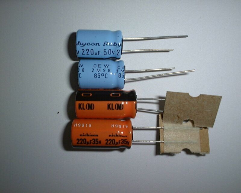

What do you guys think of these 220 uF Caps?
Regards
Anthony
Ruby and Nich both make great caps.. for audio you'd better ask someone else.
