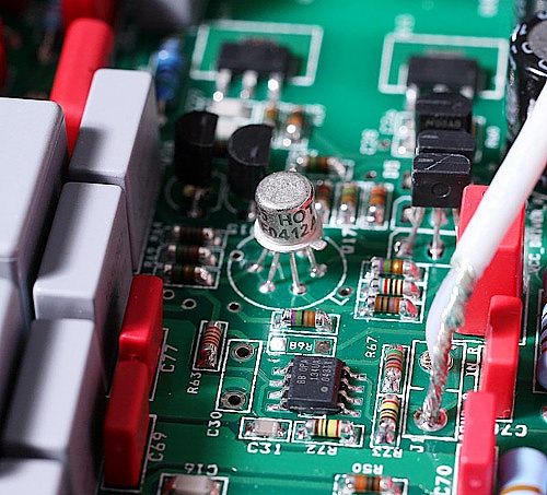

Adding an OPA134 buffer stage before the power amplifier is not new. I have seen it before and always wonder why they did it. Here it can be seen in the Metis 3 from Goldmund.... I did guess that it only was a way to save the rare "2N5565 from beeing damage by the user.

The OPA134 is TI s gem, Its there by its own right... it is highly probable that the formula TI is using is a subset of my formula
Using an opamp as an input device has two reasons: To provide the common line impedance of 47K at the input while having the strength to drive relative low impedance IPS. Secondly, the opamp can be given gain in order to reduce SNR of the amp itself, running 2Vpeak instead of 1Vpeak. This means less CFB gain which increases available bandwith. All in all nothing too special here.

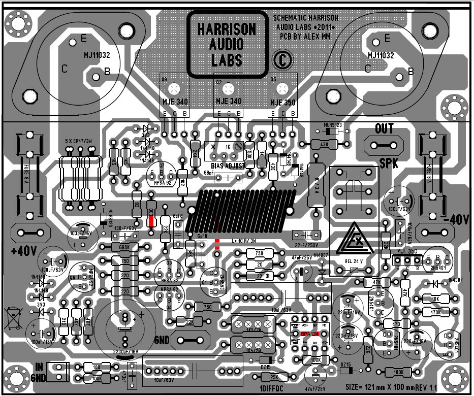

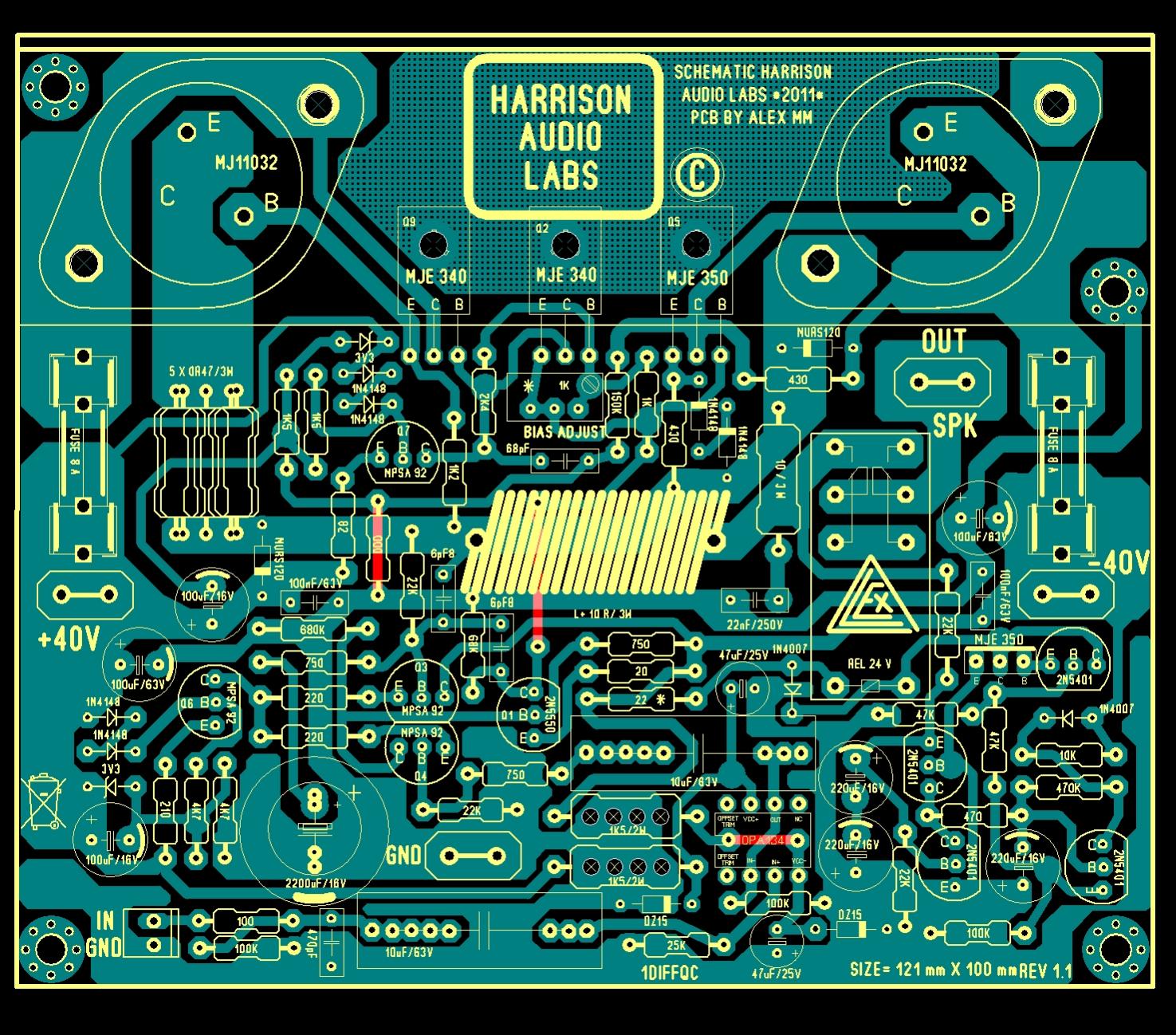

The objective of this project is to share a good amplifier as well as get user feedback to update both the amplifier and the model it is based on.All this will hopefully improve the state of the art :). And depending on how much love it receives get affordable modules for the world.

With due respect, there is nothing spectacular or ingenious about the amp design that would make it better or worse than any other good design. I have simulated it and the harmonic distribution, the phase change, slew, etc. is no better nor worse than most of the "good" designs offered on the forum.

Hi Michael, no this is a standard darlington configuration used in a TEF. The difference is this transistor is one of the thougher cookies in the jar and well suited for high current drive and DC motor control. It would mimic on quick guess 6 x MJ15003 paralel connected output devices crammed into a single package making matching unnecessary. It could contribute much of the output character of the amplifier relating to brute force and very low output impedance, However it is by far no magical formula for success.
Hi Michael, no this is a standard Darlington configuration used in a TEF. and a quasi complimentary matching pair.The difference is these transistor are some of the tougher cookies in the jar and well suited for high current drive and DC motor control. It would mimic on quick guess >6 x MJ15003 parallel connected output devices crammed into a single package making matching unnecessary. It could contribute much of the output character of the amplifier relating to brute force and very low output impedance, However it is by far no magical formula for success. What can be considered is it high gain of around 1000, to a VAS running at low current would reveal a pretty wide band operation and I would guess at least several MHz. The High Gain Bandwidth product call for serious feedback that needs be employed and this will extend the linearity significantly. It is a promising design though with little comments needed as he took care in his design.
There is a great following for the sound of quasi complimentary amplifiers since it is said that the top and bottom half have identical characteristic and arbitrary steps in harmonic generation is well controlled. Although I would like to hear the amp perform in my current system, I do not have the time and inclenation to do it in the next few days.perform. Unfortunately to justify proper comparison one has to follow the same build quality as the specimen that you intend to compare with, else the outcome can be skewed.
