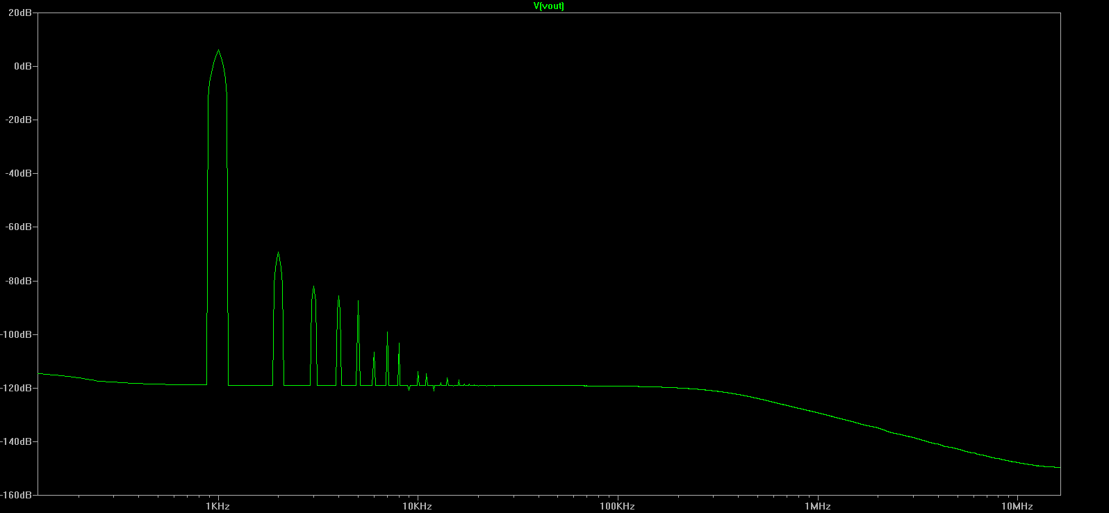

Your concept is interesting but it looks like the character is defined by the front end op-amp according to my simulation. In that case I can hang it onto any amplifier and enjoy the fact that it is virtually free from all harmonics other than the second.

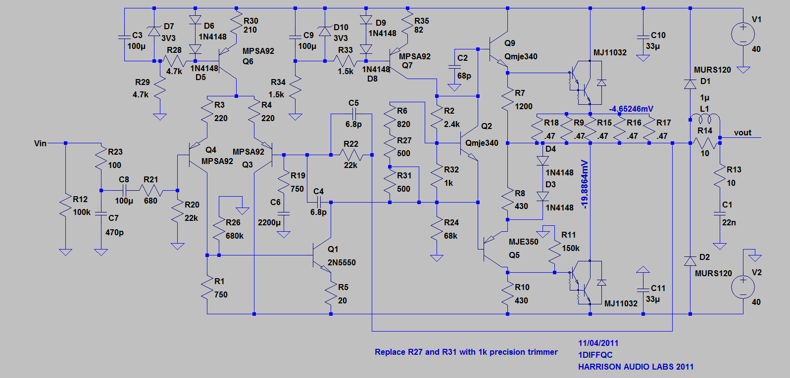

Hi Onaudio, building an amp on a whim is not always possible, because there are so many other variables that will affect the outcome, the simulation proved interesting.
Thus it was a matter of trying your ideas on a similar topology rather than just simulating and viewing a graph trying to conclude whether subjectively it could sound good or bad.
I think this is where a lot of us go wrong, we simply try to draw conclusions from simulations.

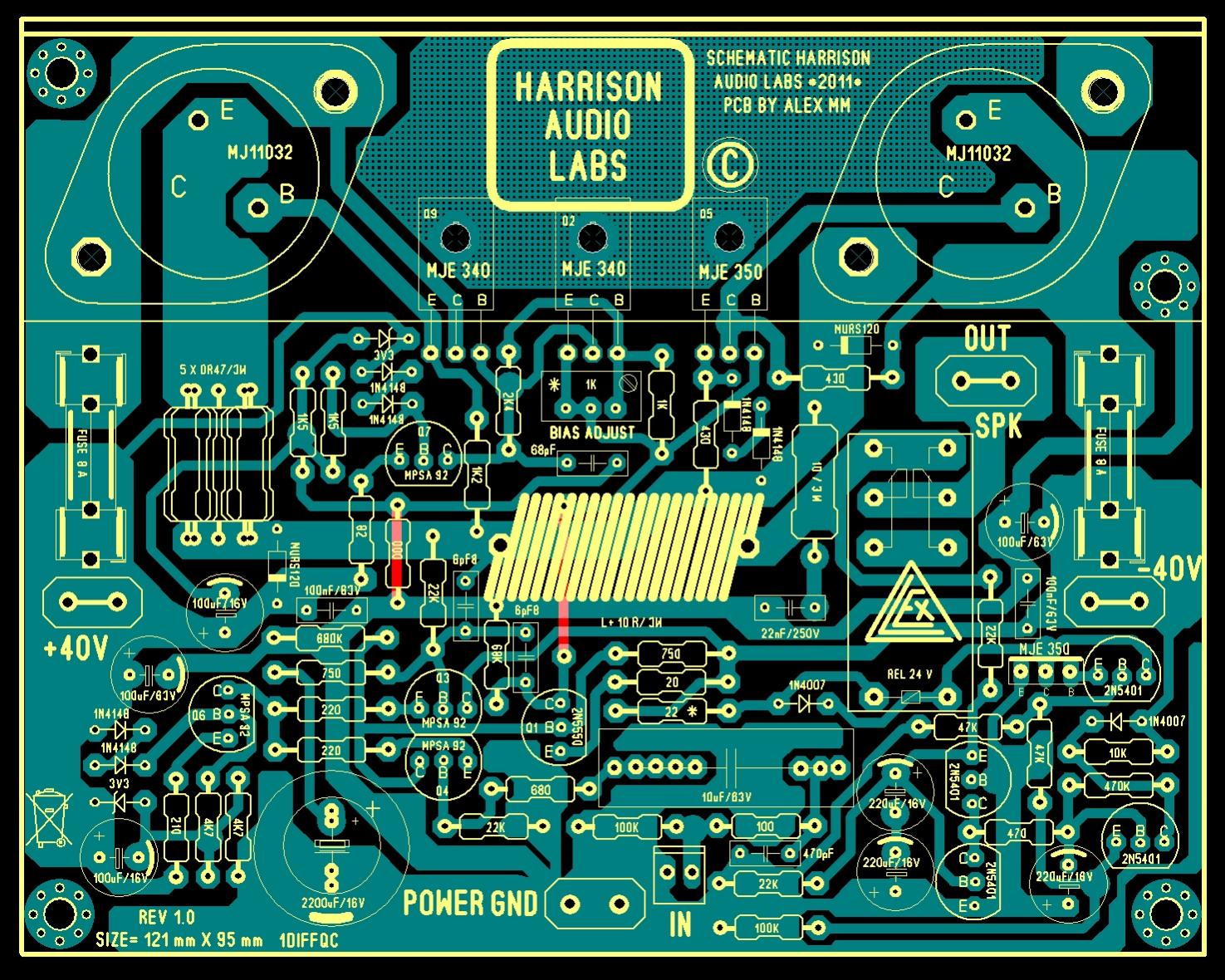

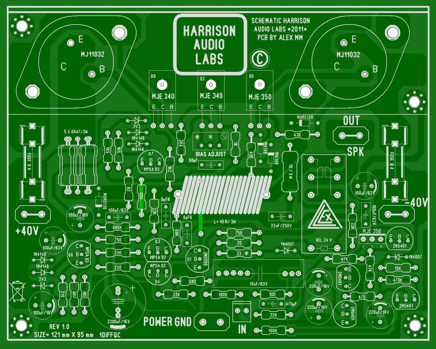

Here is the full amplifier PCB even protection on board
Alex.
Thanks Alex. This is a gem.
OnAudio, are you going to take your amp further, for example a builders thread, or will it end here? I vote that it has the potential to be a nice group project.
Dear Nico,
Thank you. It is a wonderful group project. Alex has been kind enough to include defeat able speaker protection . Could this also serve as a builders thread or do I start another thread ?
Alex, your design skill at laying out a PCB is exemplary.
I agree, Alex is extremely good.
How does he do it so fast? It would take me months.
