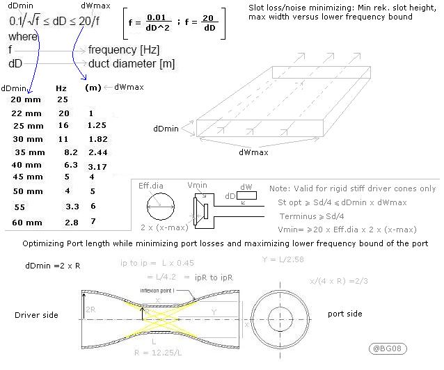

Is there a limit how narrow the channel can be - can it become ineffective? In a T-TQWT or OD could "chuffing" noise be introduced with a narrow exit?
Hi Vadi,
Picture notes and hints but no guarantee if absolutely correct:
b
Would these principles hold true for TH and T-TQWT as well?
Port Flares - Evaluation of noise
Hi Vadi,
b
Hi, Bjorn,
thank you!
Sladi
