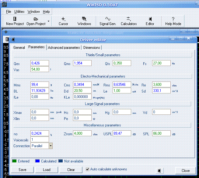

I have a pair of Aura 10000RPM subwoofers , is it possible to make use of them in a TH? They will be used in a small room(16sq.m/~172sq.ft) so I don't need much output. I would like to use them below 60-80Hz.
Frode
Frode
Frode said:I have a pair of Aura 10000RPM subwoofers , is it possible to make use of them in a TH? They will be used in a small room(16sq.m/~172sq.ft) so I don't need much output. I would like to use them below 60-80Hz.
Frode

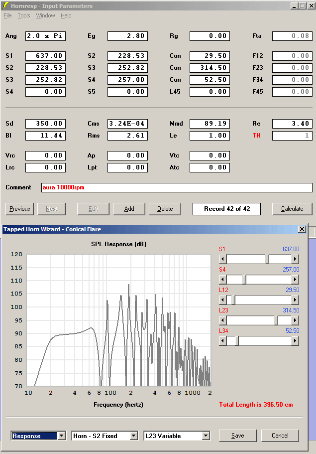

I have Hornresp, but I have to admit that I struggle a bit with the TH-simulations. I guess I just have to read the whole thread properly.
Anyways, I've made a simulation(probably stole it somewhere in the thread):
It seems like it should be possible to get a decent result, so I'll just have to play around with Hornresp. I'm open to any suggestions.
Frode

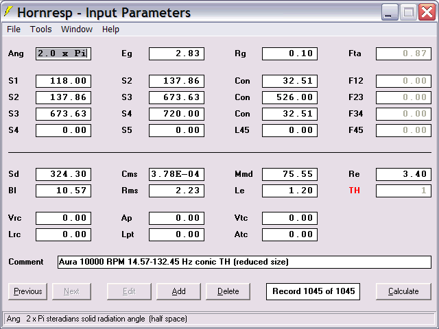

A reverse taper seems to work well with that driver.
Not sure how it would work in reality though.
450 to 100 seems impressive. But then I'd be worried about "port" noise.
A total of 3m length.
Construction might be a problem.
Juggle it a little more and you might find a compromise you are happy with.

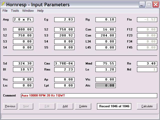

Frode said:They will be used in a small room(16sq.m/~172sq.ft) so I don't need much output. I would like to use them below 60-80Hz.
This driver wants a big cab, but considering the room size and the desire for two THs:
GM
Frode said:
Is this possible to sim in Hornresp?
Sure, though DW's specs seem way too small to me (don't forget to use the combined response tool):
GM
GM
Thank you! What kind of cabinet would you suggest for this driver?
Frode
Assuming your specs are correct, here's a starter , .. probably want to play with a true reverse taper vs. a combination taper.Frode said:
Frode
ALso, watch for excursion.
Reverse THs work ok and can go deeper at relatively smaller sizes, at the expense of efficiency. What else is new ?

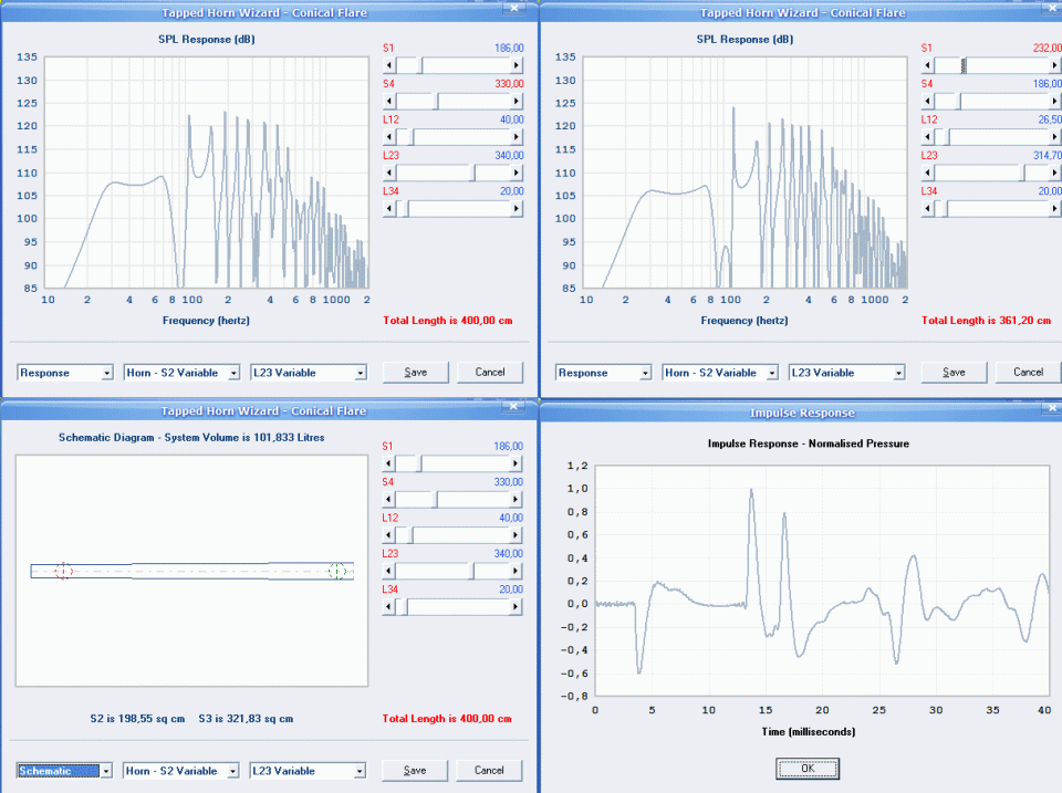

Makc said:Hello!
I can not build an optimal TP for my Woofer.
I need help, the options below.
Greets!
Sorry, but I am not sure what sort of help you want. A tapped pipe design? Or a tapped horn? Or..........?
What driver make, model is this?
GM
GM said:
Greets!
GM
Sorry.
1. I want to tapped horn at 30Hz.
2. I have a speaker Ivolga 10c (Xmax 9.5mm).
3. I use hornresp but I can not build an optimal design. If you get a flat SPL is designed more like a maze or the inverse of TP. In this pulse characteristic is always bad .
Perhaps the speaker is not suitable for TP?
