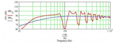

Thanks for providing your input.
Here's a comparison of your new model, versus the old model.
I used the old model with a single "virtual" driver which encompassed parameters that are equivalent to a pair of MCM 55-2421s. The new model defines the two drivers explicitly.
As the pic here shows, the differences are (fairly) minimal; mostly a bit more output in the midbass.

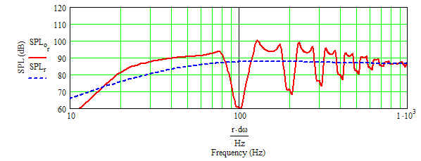

A tapped horn should have a lot more output than a TL. My hornresp sims showed output comparable to a horn. Also if you look at TDs statement about his TH having IIRC 10 db more output than contrabass. Not bad when you consider it's a single 12" driver compared to two 15" drivers. But who am I to talk? You have heard both of them!
Are your akabak models allowing for the path that goes from the mouth reflected back from the throat?

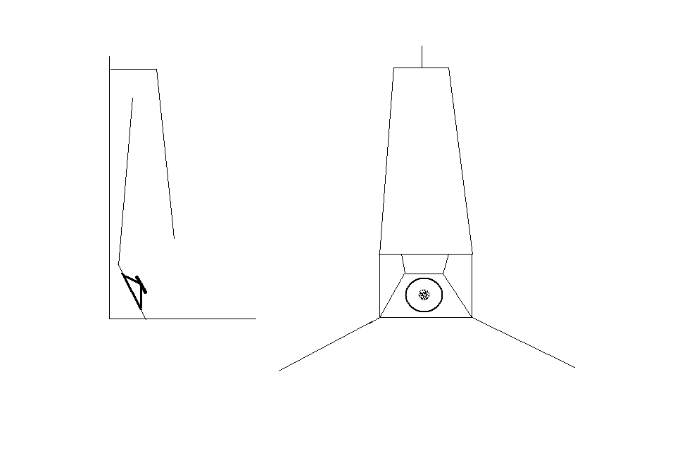

what's needed for script to describe a short tapped-box case which might be useful for DJ/PA work starting with just a baffle holding the driver then adding the panel in red?
paulspencer said:A tapped horn should have a lot more output than a TL. My hornresp sims showed output comparable to a horn. Also if you look at TDs statement about his TH having IIRC 10 db more output than contrabass. Not bad when you consider it's a single 12" driver compared to two 15" drivers. But who am I to talk? You have heard both of them!
Everyone's gut reaction is that a TH will have more output than a TL. But think about it for a minute -
A tapped horn and a transmission line both utilize the front and rear wave from the woofer. A front-loaded horn like the contrabass only uses the front wave. Based on that, a TH *and* and TL should have six db more efficiency than a FLH, assuming that the tuning and volume of the chambers is comparable.
Of course, that last sentence is key. FLH, TH and TL rarely use the same tuning. What GM did was create a TL that is all but identical to the TH that I posted using Mavo's Akabak model.
To make a long story short, I have a hunch that the Mathcad model is "in the ball park."
Here's how you do it:
1: Figure out the area of the throat
2: Figure out the are of the mouth
3: The volume of the airspace between the two is determined by those two variables, combined with the width of the enclosure.
That's all there is to it. The variable are outlined in the post where he listed the model.
If I were to model that design of yours, I would get out a pen & paper and figure out the area at the mouth and throat, the pathlength, and the width of the cabinet. It WON'T be 100% accurate because there is a LOT of extra volume in that bend in your model. Should be fairly close though.
:: PB ::
One thing I forgot to mention -
There are a couple of things that will make that pic hard to model. The expansion rate in your pic varies a LOT. That's going to make it tough.
Behind the woofer in your horn there's a big airspace - in a tapped horn the area behind the woofer is small.
In the mid point of your horn, the airspace is TINY - looks like about an inch across. In a tapped horn, the area at the midpoint of the horn is bigger than the throat, but smaller than the mouth.
And the mouth of your horn expands a bit, but is much smaller than the throat. Which is backwards.
Basically the segments should go [ smallest -> bigger - > biggest ]
Your segments go [ biggest -> smallest -> bigger ]
Does that make sense?
