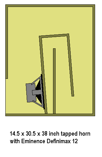

These Tapped Horns tend to be long ... too long to fit into a car. This morning, I played around with Cowan's (and MikeHunt79's) design, and came up with a fold that makes it a little more convenient.
This one will fit into your trunk, or your back seat. Is this something that appeals to you?
While I would have no trouble fitting the folded design in my trunk, the flare rate would need to be changed to avoid the use of heavy EQ due to the cabin gain. Anybody want to tweak this for a falling response below ~60Hz?

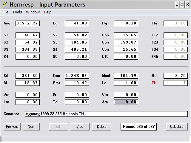

Driver suitable for Tapped Horn?
Guys. I've spent a few days reading this whole thread...
WOW...so much good information. Since I'm terrible with the math and simulation part...I was wondering if I could ask for a little help...
Will this driver work well in a tapped horn?
I've got two of these 10" drivers that were formerly in Fitsmaurice horns, and would like to re-purpose them for 2 tapped horns, if possible. I'm looking fo max efficiency from 30 hz to 120 Hz, If I can get that full two octaves. I'll be folding it like the fold that was just shown in Don's post, so I can travel with it from gig to gig.
Resonant Frequency (fs) 44Hz
DC Resistance (Re) 3.70
Coil Inductance (Le) 1.60
Mechanical Q (Qms) 2.80
Electromagnetic Q (Qes) .32
Total Q (Qts) .29
Compliance Equivalent Volume (Vas) 19.8 liters / 0.7 cu. ft.
Peak Diaphragm Displacement Volume (Vd) 372cc
Mechanical Compliance of Suspension (Cms) 0.13mm/N
BL Product (BL) 18.3 T-M
Diaphragm Mass inc. Airload (Mms) 109 grams
Efficiency Bandwidth Product (EBP)136
Maximum Linear Excursion (Xmax) 11.1mm
Surface Area of Cone (Sd) 334.5 cm2
Maximum Mechanical Limit (Xlim) 22mm

Re: Driver suitable for Tapped Horn?
Nifty driver, what brand/model is it?
Yes, it's suitable for TH apps, but a conic is so small at 76.789 L/2.7118 ft^3 net that you're probably going to have a hard time squeezing a 10" into it.
If you're as serious about max efficiency as you say you are though, then an expo has considerably more (shadow response), though of course it's much larger at 599.496 L/21.171 ft^3 net.
Hmm, after I did these I noticed they are for band use rather than corner loaded in a room, so they will be ~10 dB lower just sitting on a stage, though you'll gain ~6 dB back if stacked and parallel wired.
GM
Thanks very much for the calcs GM.
I love the response curve of the Larger (approx 21 cu ft) Tapped horn. That's one of the best looking response curves I've seen, and will easily cover the 30hz to 120hz range.
Can you refer me to another part of the thread that has the correct representation of exactly what each measurement (s1, s2 s3, etc...) is for?
And of course, i'd need the details on how to get the flare correct..
I promise to do the final work of actually creating the cabinet design, and i'll post it here for everyone's reference.
The driver, by the way, is the discontinued Eminenece HL10C.
Parts express still has them in stock, and as I said, I've got two currently mounted in Bill Fitsmaurice tuba 24s.
These two tapped horns will be driven by a crown CTS 2000 amp.
I've got a pair of the EAW LA212s for tops. So, It should make for a very nice sounding system. I'm a DJ who does care very much about the quality of the sound...not just quantity. And the Top 40 Music keeps using lower and lower frequencies as fundamental parts of the music. I've measured pop rap music with frequencies as low as 28hz! That's not easy to reproduce well, and I'm not willing to carry around enough reflex boxes to get any decent output at those frequencies.
