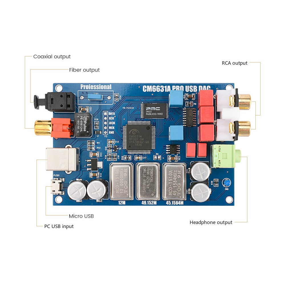

Hello Forum,
I gave the CM6631A a try and brought a simple board form Aliexpress. https://de.aliexpress.com/item/1005005178398281.html
This workes quiet well, if a simply attach a I2S amplifer to it. But I would like to combine this board with an ADAU1701 DSP that is already interfacing an APTx Bluetooth module. Hence the CM has to run in an I2S slave configuration. How can I archive that? Is it even possible to configure the CM6631A as an I2S slave device to output USB sound towards my DSP?

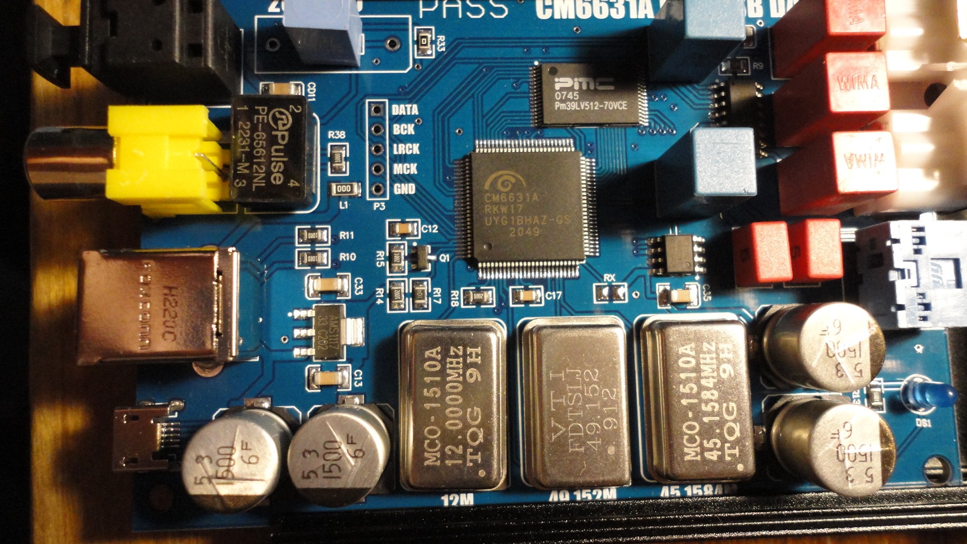

I have the CM6631A device bought on Ali in 2023. It has analog Speakers, Headphones and 2 SPDIF (coax. & opt.) outputs.
Everything works well on Win10x64 with C_MEDIA_Inc._USB_Audio_Class_1.0_and_2.0_DAC_Device_Driver_DAC_10.0.12.10, but this device is displayed in Windows as Speakers, but I want as SPDIF to transmit also multi-channel audio to the receiver (PCM max. 2x96kHz/24-bit, Dolby/DTS 6.1).
Device ID: USB\VID_0D8C&PID_0004&REV_0208&MI_00
Can I reflash such a device with new firmware created with CM6631AConfigurateTool after change to SPDIF ?
Will the Speakers and Headphones analog outputs also work?
Sorry, I'm very afraid of ruining the device :unsure:
