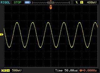

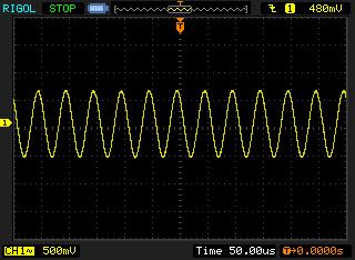

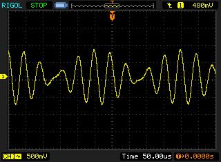

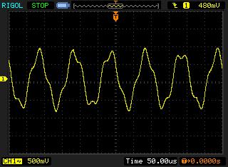

I'm trying the DIYinHK (isolated) CM6631A board, and same vendor's ES9018 board.
glt mentioned that you can play 44100 files with this combination, and it works fine - despite the BCLK coming out at 128 fs, instead of the 64 fs required in the ES9018 data sheet.
I tried it like this, but I do not like the sound. It sounds OK at first blush, and the 3D space is quite pleasant. But it sounds nothing like natural acoustic music - it's mechanical sounding.
LP source through same amp/speakers sounds wonderful.
The board has been configured:
- ADP150 for clock supply, preregulated at 5V. Clock is EPSON-Toyocom SAW 100MHz;
- ADP150 for DVDD supply, preregulated at 5V, (separately);
- ADP151 for DVDD 1.2V supply, preregulated at 2,5V, (separately);
- ADM7150-3.3 for AVCC supply, preregulated at 5V, (separately, separate transformer/rectifier to above supplies).
- voltage mode output (until I get it good enough sounding to apply my I/V method).
It sounds a lot better with 96000 files, so I have looked harder at it. I tried to use the FW updater, to change the 44100 BCLK to x64, but this app just quits without displaying anything, on my only windows PC (all my other computers are on Linux/Kubuntu 12.04 - Kernel 3.2.60).
Next, I scoped out some sinusoidal WAV files at 44100 - which look terrible! Admittedly, there's only a 22nF PPS cap across the phases ('Rasmussen Cap') by way of output filter.
So, I used SoX to upsample the sine WAVs to 88200:
sox infile.wav -r 88200 outfile.wav
and found that at 88200, which drives a x64 BCLK, normal sines are presented.
This seems to suggest that the ES9018 really does need a x64 BCLK, and x128 is really not suitable.
attached scopeshots: 10k 44100 - 10kHz 88200 - 20kHz 44100 - 20kHz 88200, played with DeadBeef on Linux Kernel 3.2.

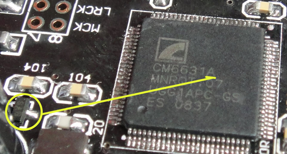

I've recently found a solution for issue that caused when CM6631A module is connected to any Mac USB 2.0 ports.
When you connect module to Mac it is detected as USB Audio Class 1.0 device and you have no ability to use anything more than 48/16.
Module has a reset chip LM810M3-2.93 (http://www.nscrus.ru/content/catalog/pdf/LM810.pdf), but as we can see from the CM6631/32 datasheet, the CM6631A has a power-on self-reset.
So, reset chip has been removed from a board and now the module is always correctly detected as USB Audio Class 2.0 device on any Mac USB port.
This method has been tested on MacBook Pro, Mac Mini and this CM6631A module:
New CM6631 USB Module Assembled Board for DAC3 AD1955 DAC7 WM8741 by Weiliang | eBay
LM810M3-2.93 is a 3-pin chip located on the top of CM6631A.
Thanks for posting this. I recently had a problem with a Win 7 PC. The converter performed as advertised until it was unplugged/replugged into the same USB port. Windows would then report that the device could perform faster if attached to high speed port. At that point the only available bit rates were 16/44 and 16/48. If left in this state the converter would run warm. At first this only seemed to happen with PC USB power but I was able to duplicate it with 9 VDC external power. After I removed the LM810 this never happened again. The device now runs cooler at all times and draws less current at power up.
