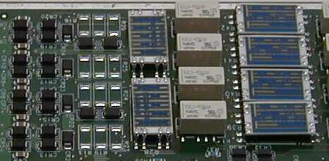

I designed power cross and lightning protection circuit for telecom line cards. It's a bitch. The big things are fusable resistor networks that have to open under very specific conditions. Getting more than one vendor that can make them work was a nightmare.
Acts Of The Gods.
I repair big system retic gear - BirdBrain (tm).
The controller lines out in the fields have multiple shunt gas arrestors and varistors, and the boards are covered in more 5.1V zeners than you can count.
I have repaired boards where half the IC packages are BLOWN apart, and tracks vaporised and without trace.
Can lightning be completely protected against ?.
Humm.. my only experience is working for a Power Company as a Journeyman inspecting Power station relays and servicing HV distribution systems.
