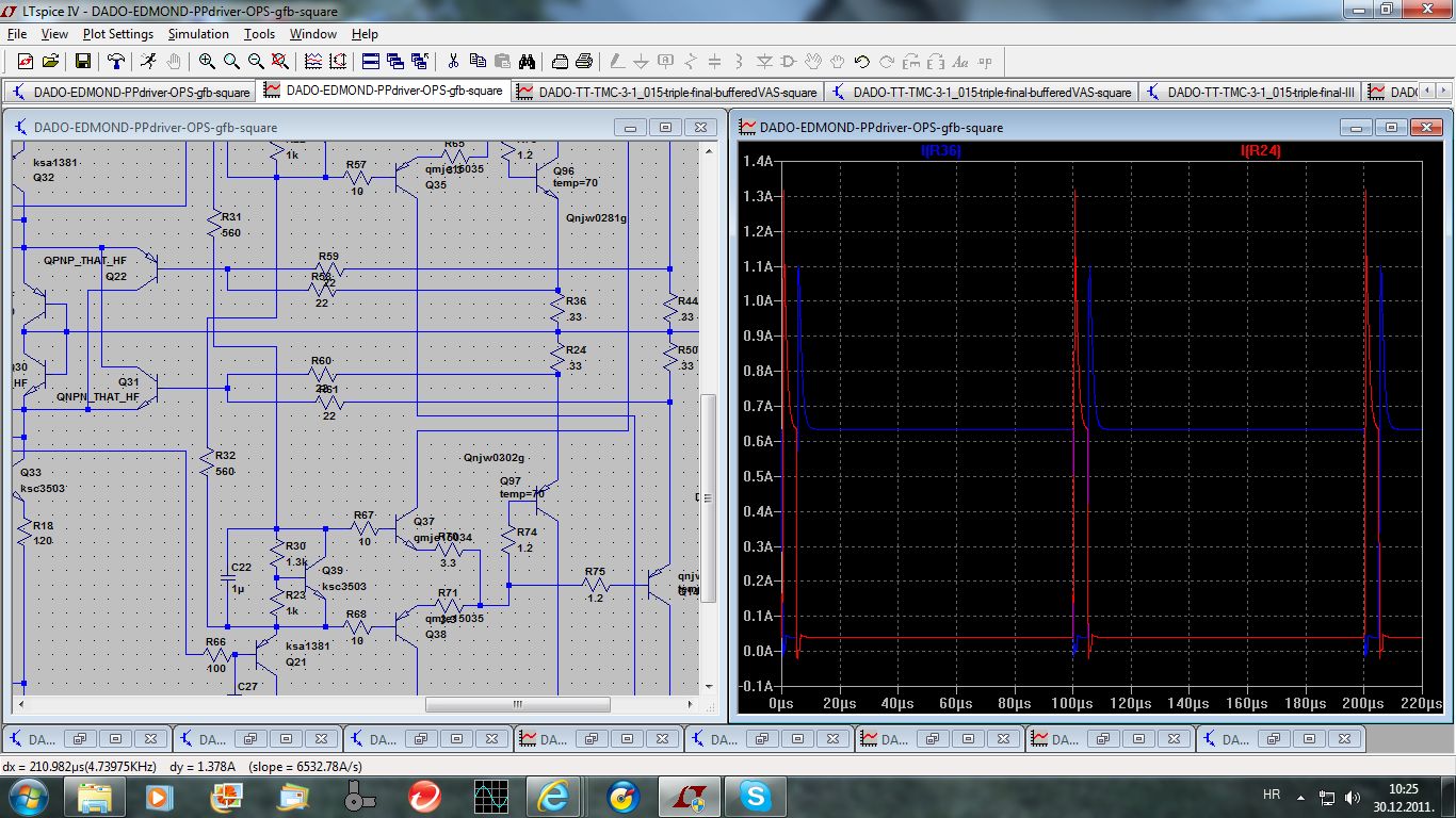

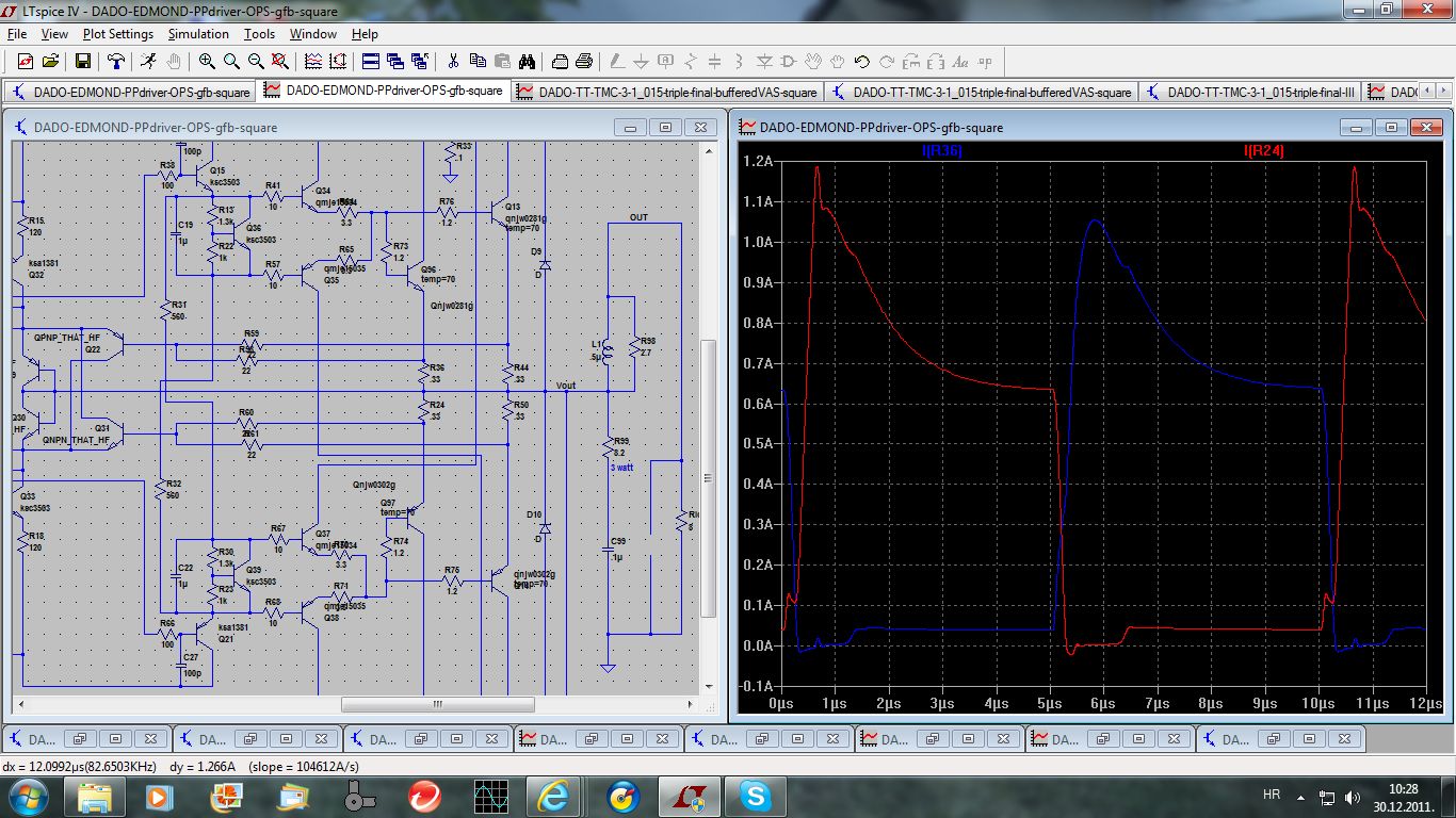

But what happens in case of square waves or a sine of say 250kHz? An ideal OPS should show the same (low) cross-conduction, though that's not always possible.
E.
Hi Edmond,
Here is square waves test at 5k, 100k, end 200kHz.
It is still with my input stage, GNF, and input filter. What do you say about it?
Damir

Hi Damir,
It doesn't look good.

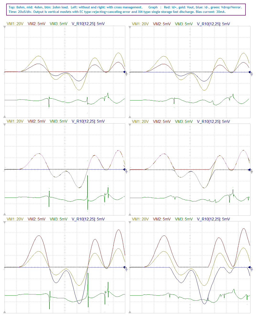

Hi, I am also re introduce my cross management in other thread that ever mentioned at "Variable operating biass output ?" thread, it is fun.
May right or wrong, as I know AB2 is simple cascoded current feedback with that cross connection for smaller current gap, and midle transistors for keeps output not turned off.
Correcting error with rejecting error using NFB. Output is current, thats why additional buffer or driver will increase its gain, but decrease its stability. I see no canceling error method except two different Re values, so almost pure rejecting.
Don't worry I like to learn.
I think that not-turned-off is not reject crossover distortion but little help, and there are many type of non switching, class-i, kendall, nakayama, edmondAB2, kenpeter, nelsonpass, may be many more, i think i have one:rolleyes:.
This one reject crossover distortion into 5mV scale.
