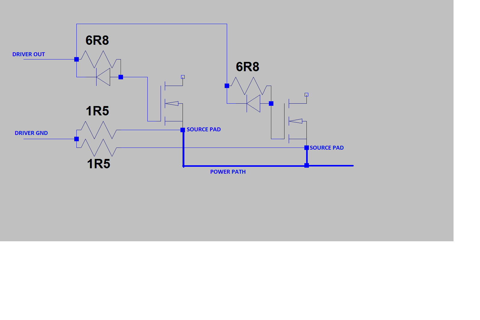

During high di/dt an inductive voltage drop across the source leg of the MosFet will happen. This drop is typically in the range of multiple volts.
Real life layout will have similar or worse inductance on the track, which you called power path. Means we will have a similar drop there.
The two separation resistors will define the reference for the gate driver more or less in the middle between the both potentials of the source pads.
This is resulting in different gate drive levels (gate pad vs. source pad).
The left MosFet will see less gate drive compared to the right side.
...not confident anymore that this configuration will solve the di/dt sharing...

Is that OK?
So this is you mean with difficulty with switching high current fast?
If your drivers has common ground and between 2 mosfet driven sources differ to 10V, yo need to separate the drivers. Driver rev(gnd) should be taken from sorce pin, not from place that may reach d10V from souce pin.
Oh?, may be they also using tracking rail, if 1bjt could deliver 10A peak, 10pair will be 100A. Dunno better ask them for that spec. My 200W into 4ohm amp only 14A maximum, current is limited.(and the manufacturer that says 80A or 120A for a few bipolars has become a joke over time). In the beginning, I got into amplifiers mostly by repairing class AB, I still fix one from time to time.

The drive current while charging Cgs brings additional drop on the separation resistor, which helps balancing the Vgs's.
Probably the exists some optimum value of this resistor here.
Of course this is not a cure-all scheme, works in conjuction with normal layout precaucions and common sense.

...your proposal demands to have two floating drivers, means two level shifter + drivers. Both sequences must have matched propagation delays, better than 10ns, preferably below 5ns.
Well, if you start to spend that amount of material, you are already close to a multiphase power stage, which does not need matching of propagation delays, but must have perfect DC balance for both tails...
Furtheron a multiphase system has switching residuals in the feedback of double modulator frequency - depending on the used technique to overcome feedback induced modulation distortion a multiphase system might have higher distortion or might need a specialized solution to overcome feedback induced modulation distortion. (Fortunately these distortion issues are relevant if you target THD around -80db at output levels > 30% max power, but not if you can live with -50db.)
...there are no limits to boost system complexity.
Finally it will always be a trade off between requirements, complexity, costs and as darkfenriz says common sense.
(The funny thing with common sense is that the number of conclusions equals the number of involved people. Commonly. Sometimes even exceeds...)

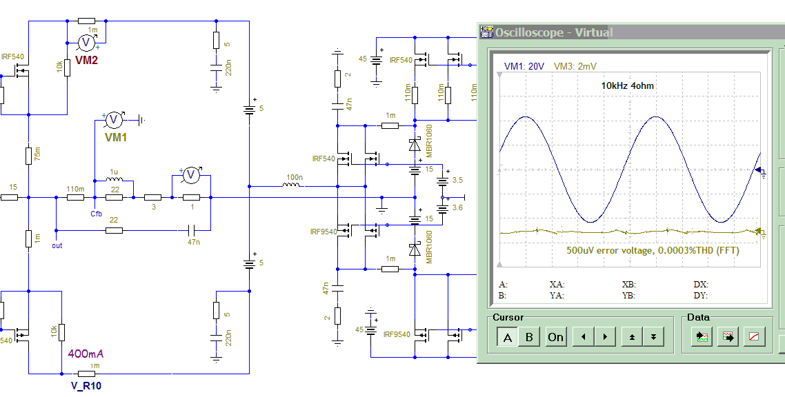

Picture of simplest (linear ClassG), Also work with digital tracking rails, but may be another time for classD, its output filter is still a big lagging devices.
