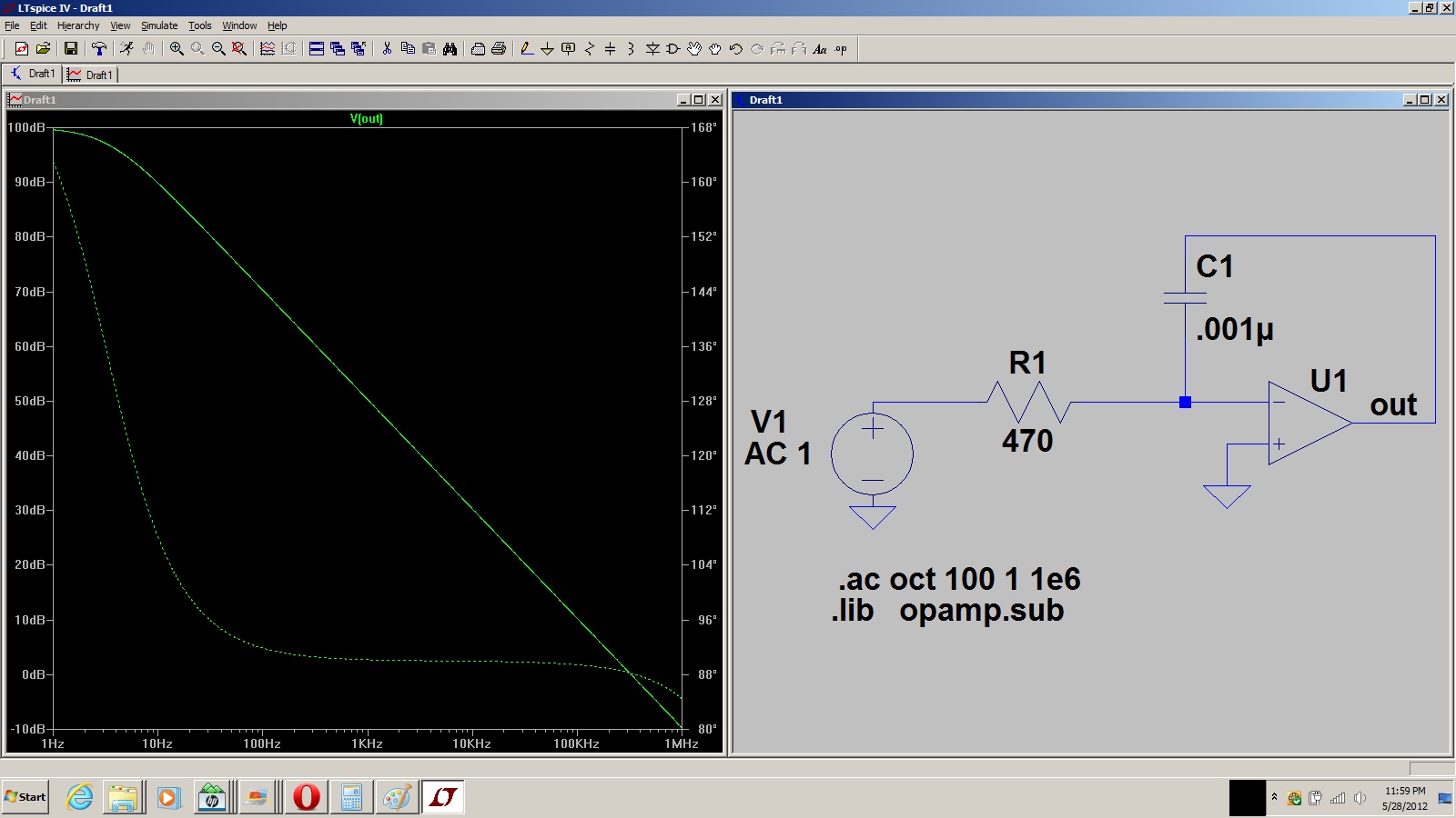

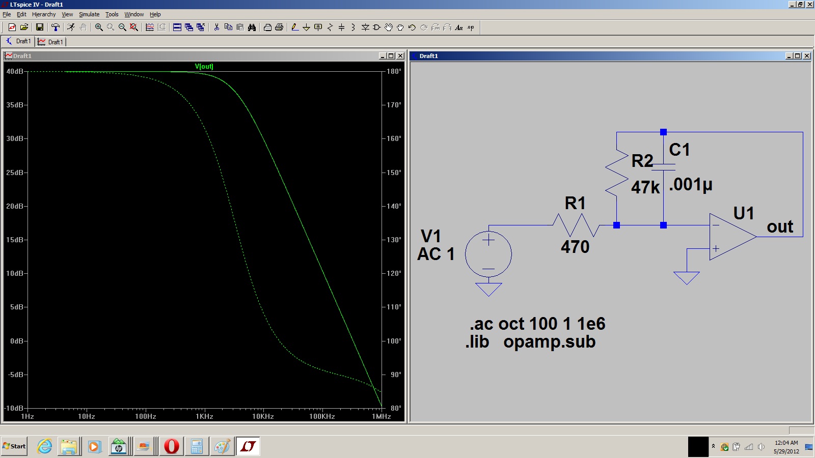

4) I still object to feeding back full carrier levels - but understand how it should work, just the same. Having said that - U2 is going to behave differently depending upon the source impedance of the audio (as others have pointed out). You'd be much better off adding a buffer amp at the input port. That will make the time-constant of U2 the same at all times, (R9 || R10) * C6.

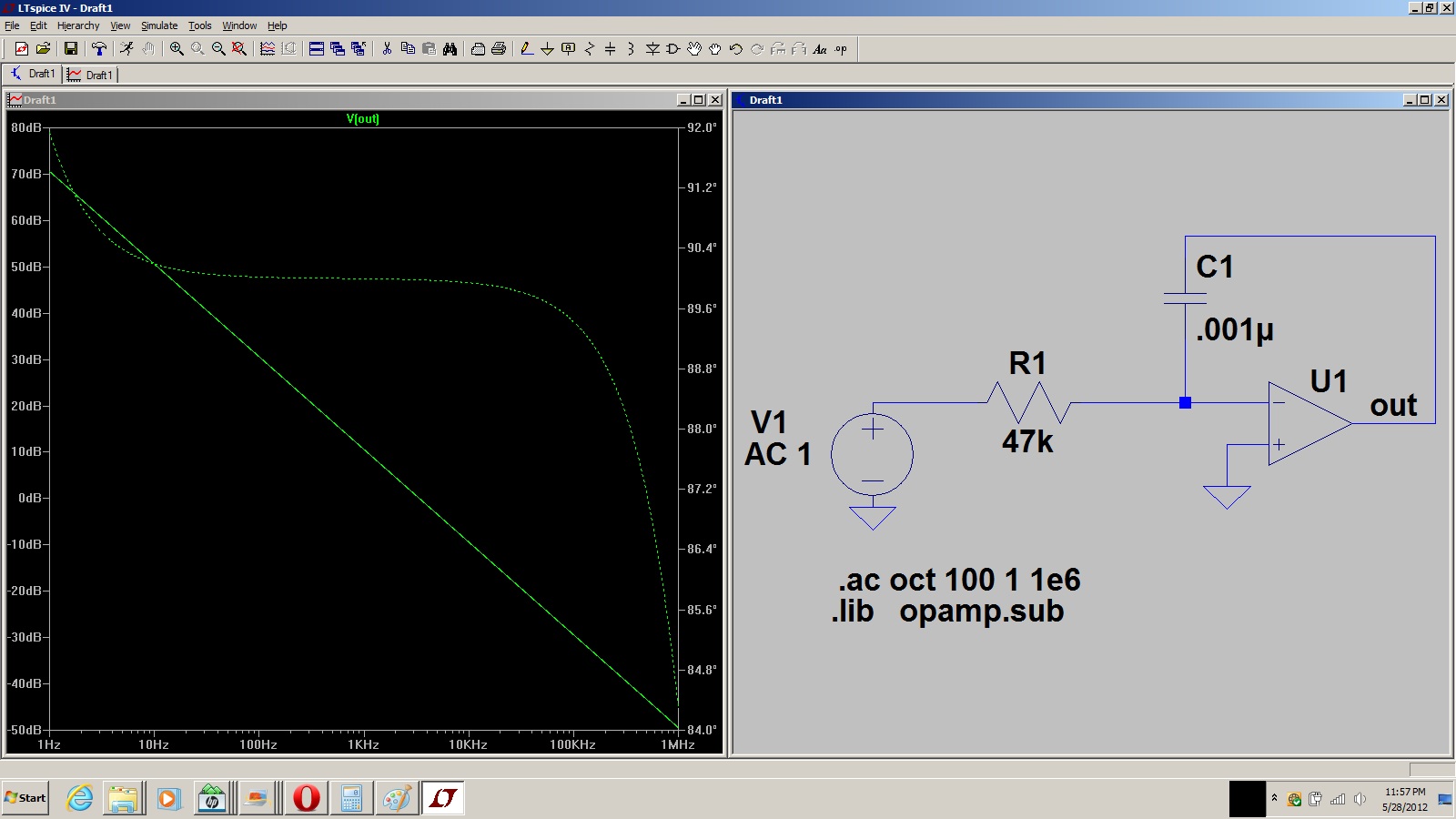

I noticed that the phase response of this, U2, depends heavily upon the source impedance of audio. If no input, i.e. open circuit, the time constant is R10*C6 ; pretty long. But check out the gain and phase plots. You've got roughly 90 degrees phase shift throughout the audio spectrum. I suspect you'd prefer 180 degrees.
If the input is low impedance, the phase response is changing from around 170 at DC to 90 at 20 kHz. Somewhat better.
If you use an input buffer, *and* add some resistance in parallel to C6, you move the pole frequency out a whole lot (wider bandwidth). I tried it with 47k, arbitrarily, and the phase shift is nearly 180 degrees throughout the whole audio band. Pretty much the same as Choco and you have already said, but with a slightly different explanation
This arrangement looks more predictable and repeatable.
Thank you for the time to the simulations. But in fact, full voltage appears in 3 15K resistors in place of 1 47K, and I use the circuit as the author made the article I posted. In fact, normally -I insist- the circuit works fine. It only goes blocked SOMETIMES it is ran without load. Inserting a 1K as output, it continues working fine and doesn´t block.
