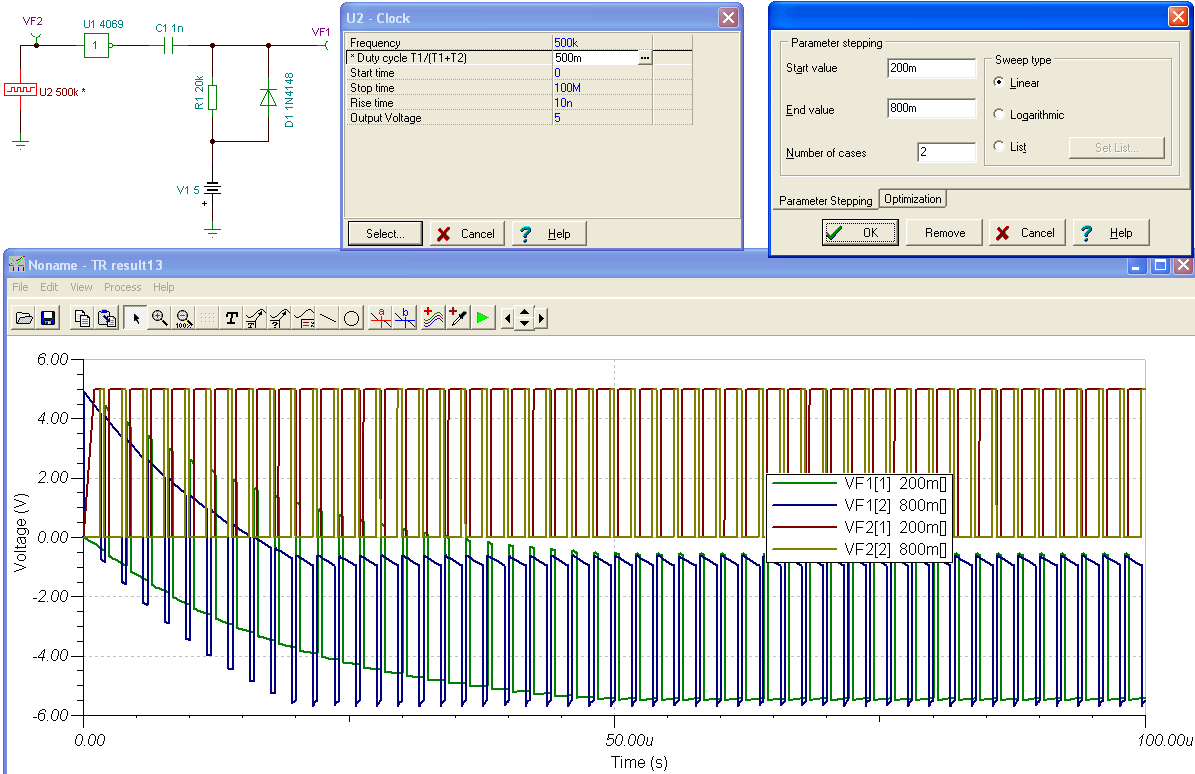

And here we have an AC coupled feedback loop.
Not really. AC coupling of PWM signal does carry DC information, as long as duty cycle is more than 0 and less then 100 %.
And that AC coupling is not exactly AC coupling, because input of the IR2110 contains a clamping diode to GND, which restores the bottom of the PWM pulses (therefore automatically restores the rising edge of the next pulse). (In analog base-band video signal transmission the same trick is done. It can be AC coupled, still the DC can be restored, it works amasingly good!)
The problem is the fact that at start the duty cycle can reach 0 or 100 %. Only at this state the feedback loop breaks. (Or during a long overload. But then the next cycle can turn back the amp.)
Without that the circuit is begging for phase reversal of U2.

The results of the simulation. I reduced the additional elements (10n, 2M2) to achieve shorter settling time, otherwise the simulation lasted too long.
The triangle is little round because I've set 100 ns rise/fall time.

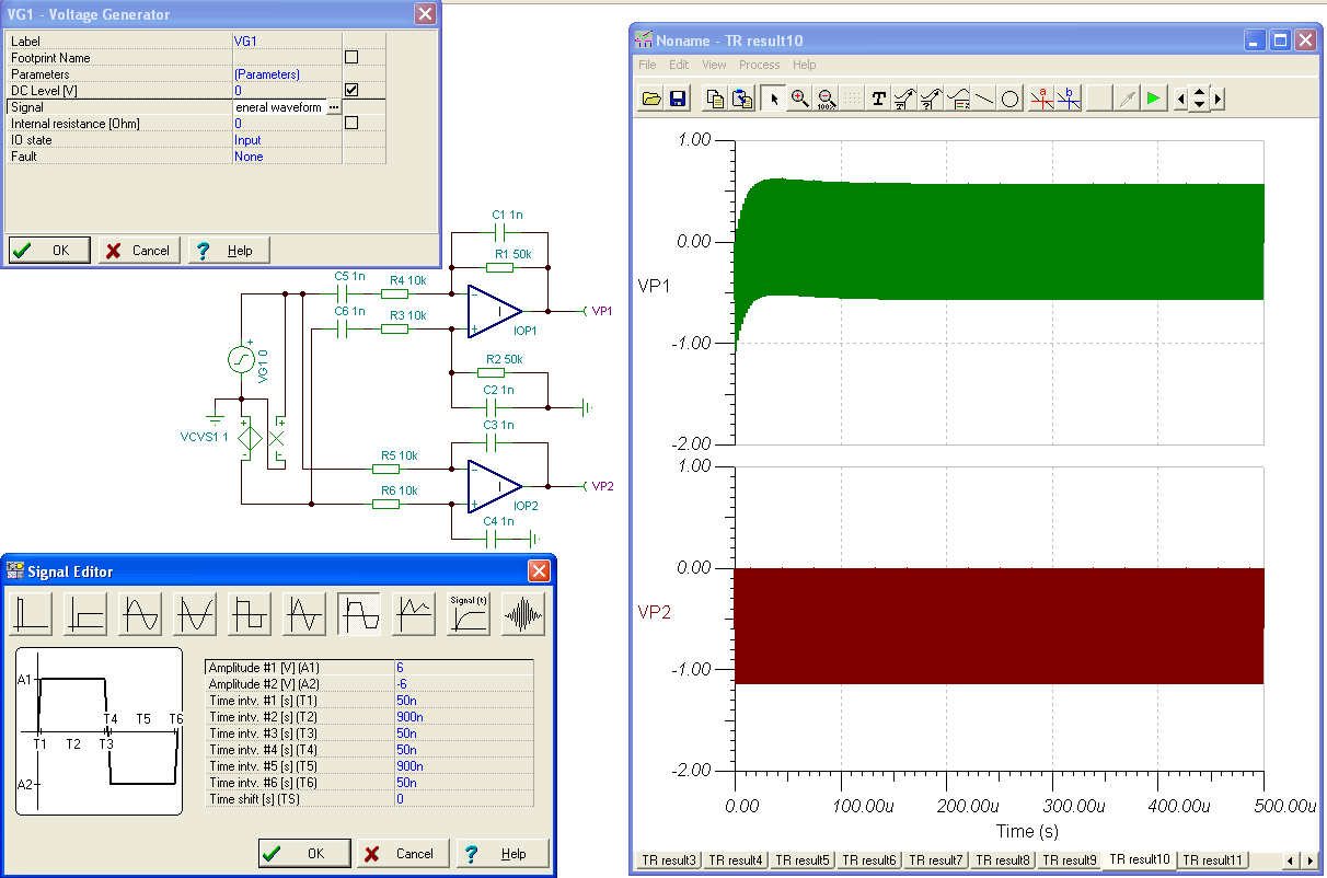

As far as the triangle oscillator goes, if the analysis is based on the single ended flavor (presumably the differential version is similar) then the output is not really triangle - it's exponential.
I am ignoring the DC blocking caps on the input because they represent only a small offset at 500 kHz, compared with the 10K input resistor.
There is more than one way to do this but, for an inverting opamp, V1=V2 and in this example, V1 is grounded (0 volts)
Vo(t) = -i(s) * Z(s)
where
i(s) = Vin(s) / R1
Zf = R2 || C
Zf = R2 / (S*R2*C) (in Laplace)
let a = 1/R2*C and plug it into the Zf
Zf = 1/C * [1/(S+a)]
Vo(s) = [-Vin(s) / R1] * [1/C *[1/(S+a)]]
Vo(s) = [-Vin(S) / (R1*C1)] * [1/(S+a)]
a little reverse lookup, and you find the equation in the time-domain is
V(t) = -Vin(t) / (R1*C1) * e^-t/(R2*C)
Mathematically speaking, this is an exponential rise/fall output (depending if the drive is + or -). The reason the simulation, and real-life appears triangular is because over a short enough time, the curvature is not visible. I tried it in simulator to satisfy my curiosity (exaggerate the period, like 10 seconds on, 20 seconds off) - but have not posted it yet.
An integrator circuit with just the capacitor is a true ramp. That equation is
Vo = -Vin/RC * dT (not going to derive it here). Mathematically, this is truly a straight line ramp up and down.
