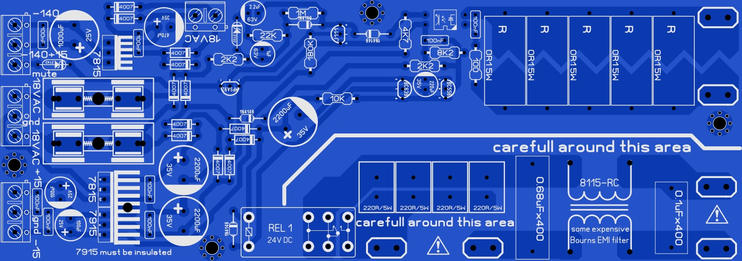

I've made psu layout, nothing fancy, anyone willing to check? I will post sprint file too when it has a go.
Also included softstart, I designed it some time ago and worked, I don't remember exactly schematic. It's resetting on power loss.Or should do.
Amplifier board could fit T200 if output filter cap is shifted 90 degrees and moved in right corner, and coil centered between side caps. I'm not going to build this amp, i made it for good practice, so don't ask what i'm going to use;)

Nice pcb, thank you.

Nice work c08bm
Yes, but it's single led, on schematic there is dual antiparalel led opto.
Sprint file with both psu and amp uploaded.

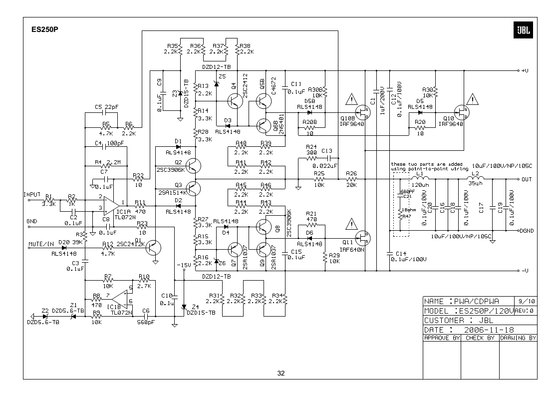

Sorry for this off topic post because I hope someone can help me to fix this amp. Its form a JBL subwoofer module which gives a hum like a siren horn. When I give a signal the output is not clear and very cracky. oscillate at 77KHz at +/- 50v. It normally runs +/- 65V which gives higher frequency but both results the same issue. Anybody can help me out?

I think i've spoted some mistakes on the left LM311:
out(7) is not connected to emiter 5401,
missing connection left LM311 IN-(3) to OUT2(7) of right mc33078,
pins inverted on schematic, OUT2(7) of U1B it's connected to IN+ of LM311(2) but shows pin 3, and IN- (3) show 2, so maybe connections wrong, mr, Mile could tell us.
Good job for first try, keep practice, use zone instead of track when you want to fill area, route tracks between pins and can ditch straps
