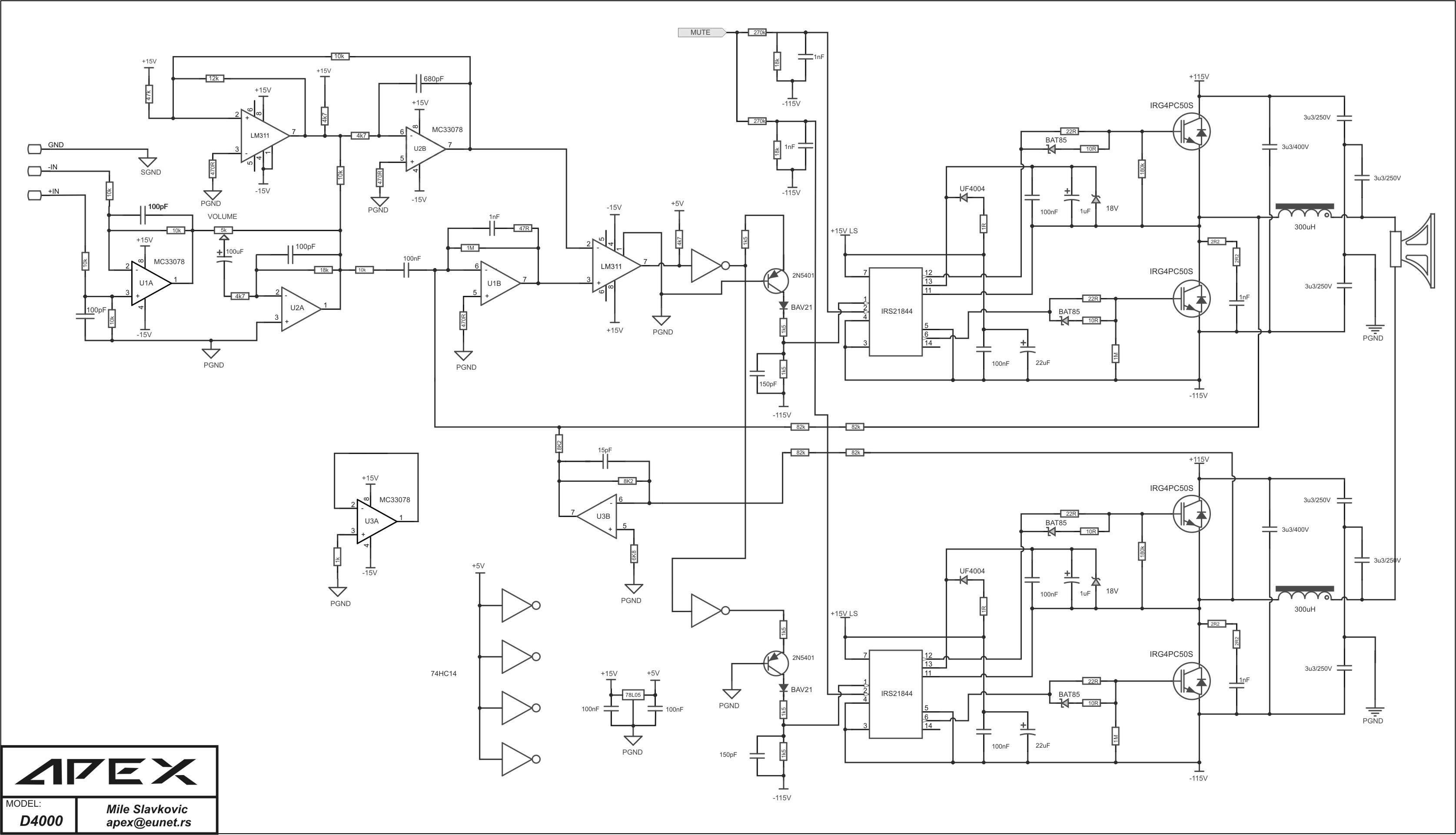

Maybe because the idea of a 2 KW half bridge is totally crazy, specially when i have the same amount of power with two half bridge configured in bridge, lower tension, lower stress for component, no bus-pumping, higher damping factor, higher sound quality cause higher switching frequency.
There is full bridge D4000
Assuming that a common class d amplifier have 90% efficiency, obviously a 2kw class D with Fsw of 40khz have much worse efficiency, a lot of car amplifier chinese board have this Fsw and have 70-80% efficiency, then we expect 400-600 watt of dissipation, in my opinion too much for two component

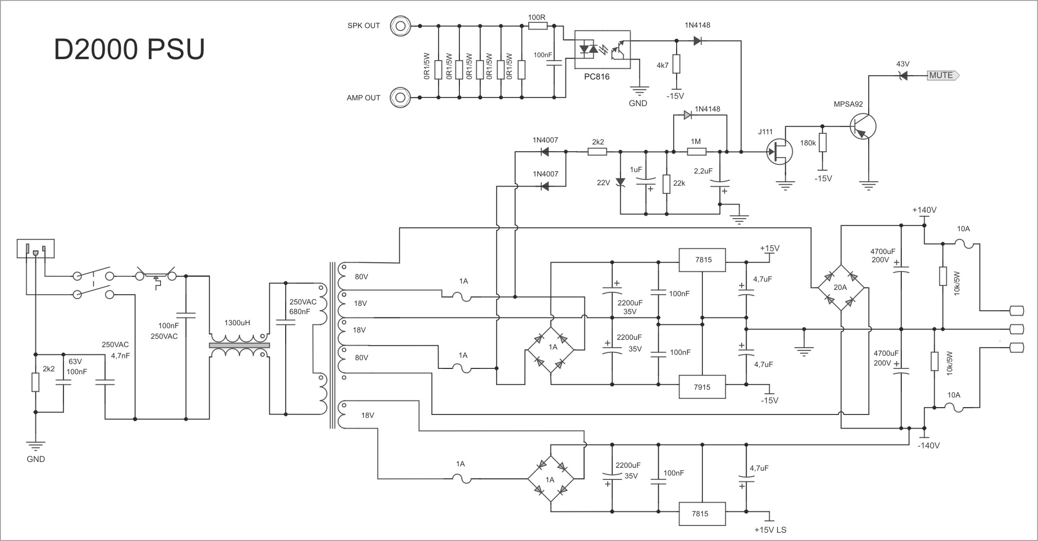

What does +15 LS mean? It's 15V referred to negative rail?
Yes, it's 15V referred to negative rail?
I will share PSU and Protect for this amps.

So, a 4R7 5W could replace those 2 resistors, with "same should be on other igbt" you mean there should be 4r7-1nF on high side IGBT?
Nice work, use 4R7 2W instead 2x2R2/1W resistors.

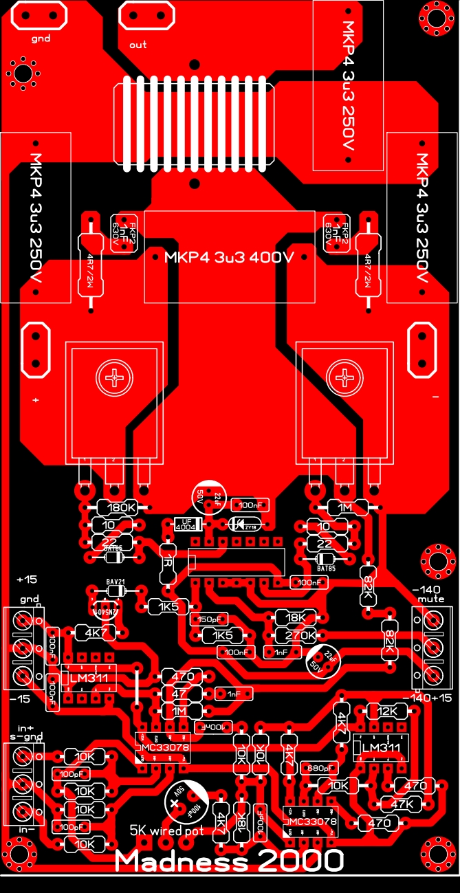

LM311 and MC33078 must have decoupling caps 100nF from +15V and +15V to gnd (not on schematic).
Regards

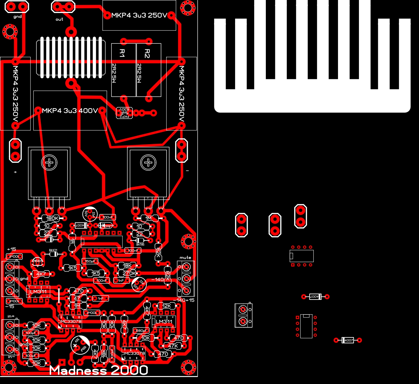

Like this?
Sprint layout file attached
Nice work, all LM311 and MC33078 need separate 2 x 100nF decoupling from +/-15V rails to gnd.
