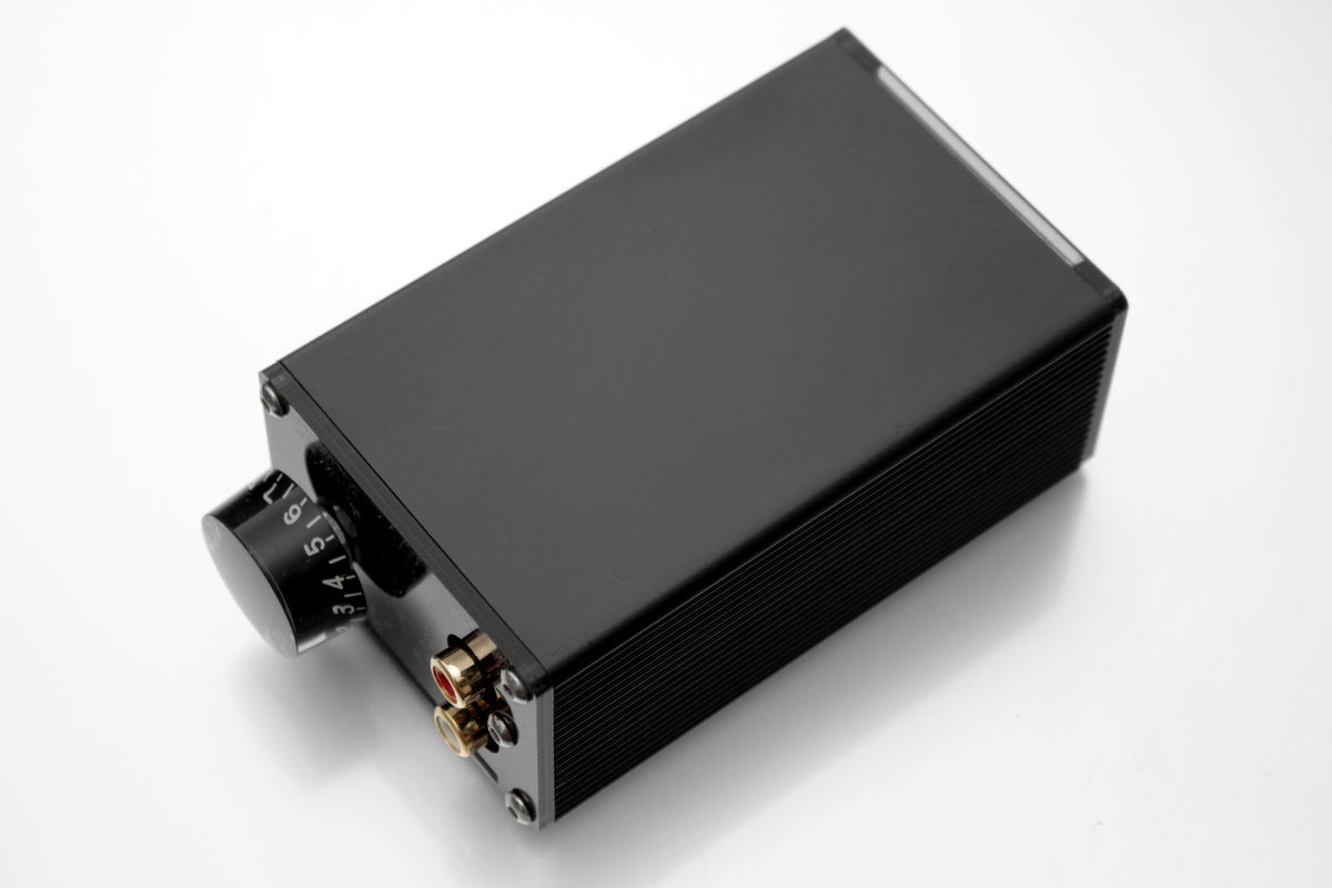

Finally managed to get my case done.

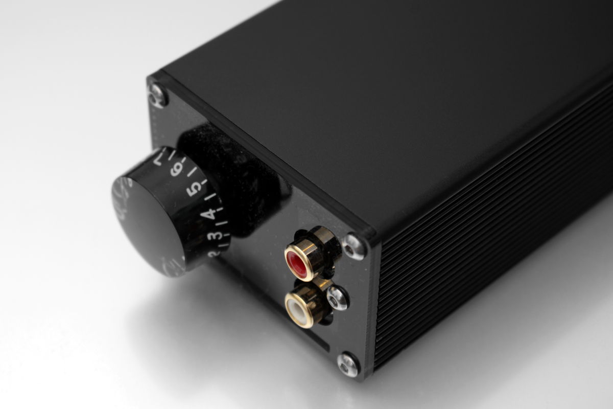

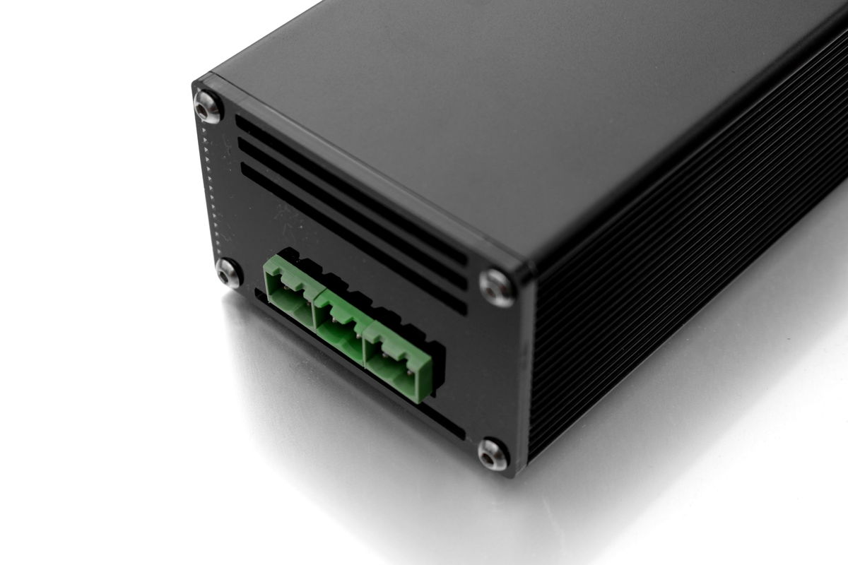

TPA3251 (TPA3255) aka ?Model Tiny? in Aluminiumgehäuse ? #360customs
TPA3251 "Model Tiny":

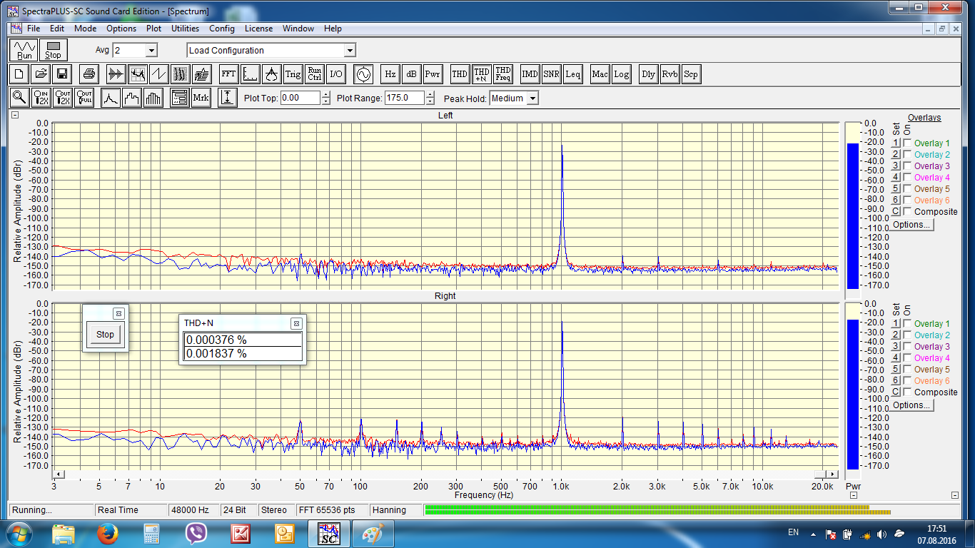

THD+N (1W-P/2) < 0.003% 20Hz-20kHz (AES17)Specs?
right channel - amp, left - audiocard only. Load 3.3 Ohm. 20W

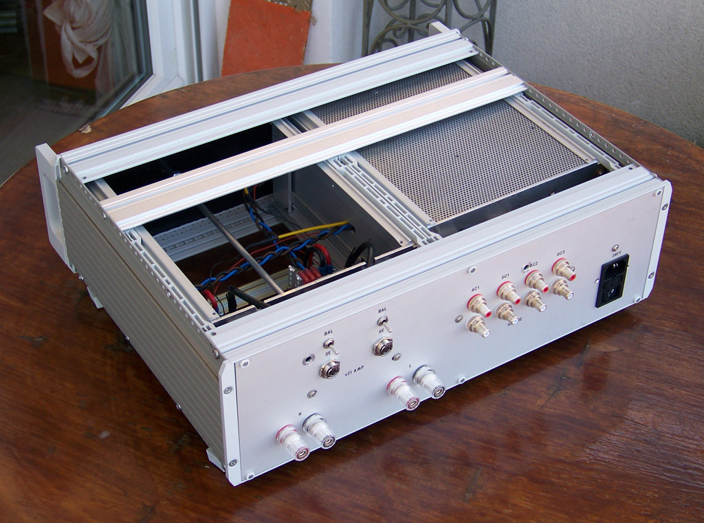

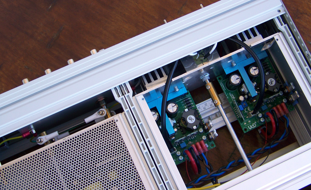

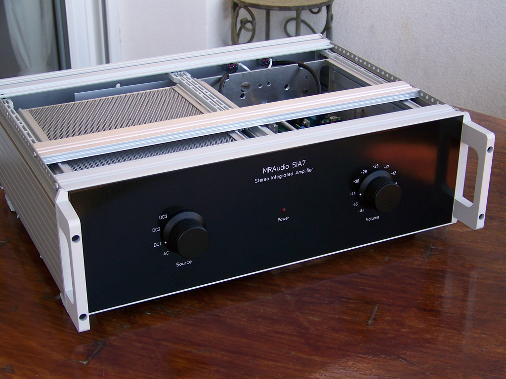

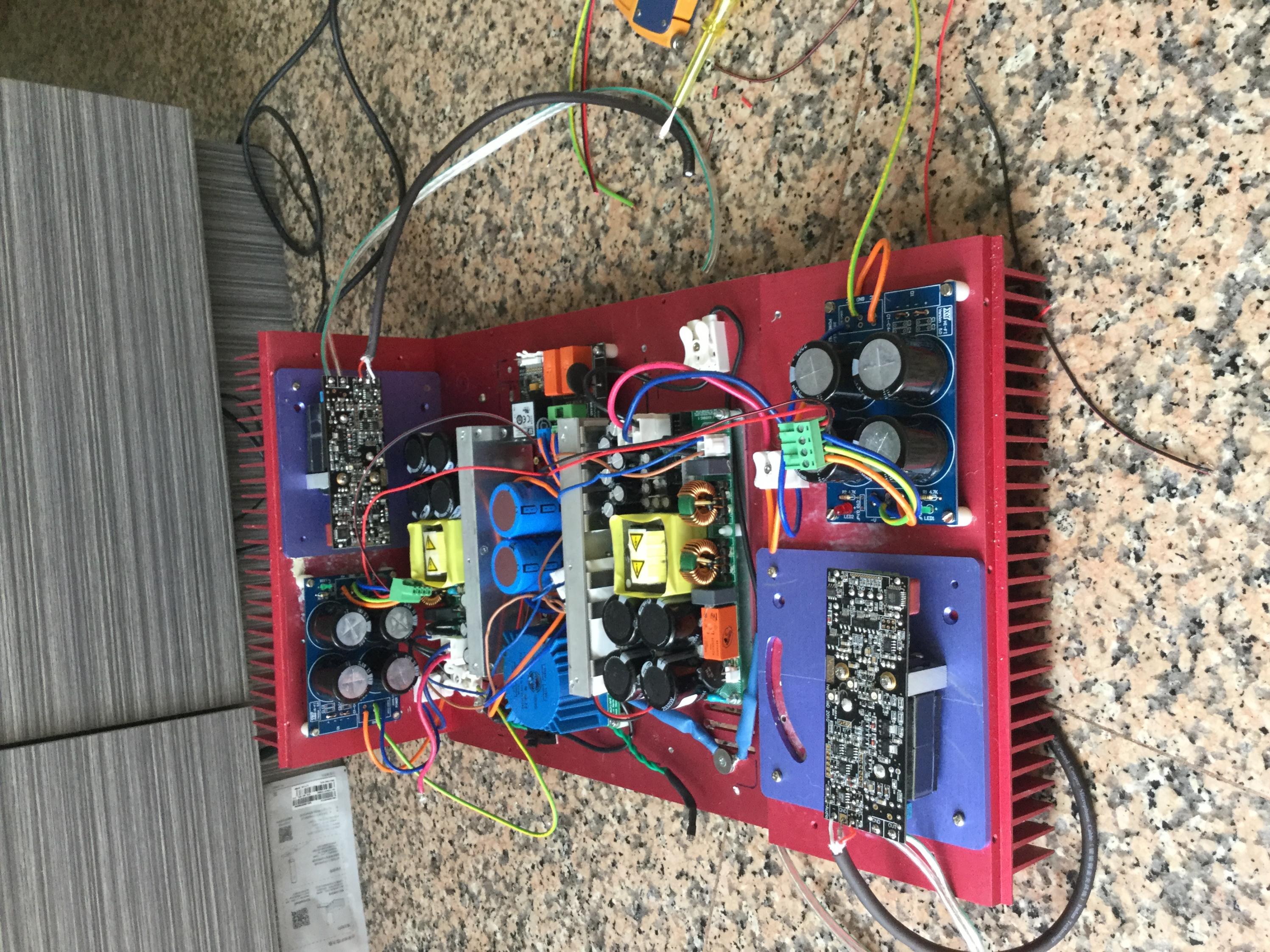

Hi there,
after years I've finished mine, UCD400HG HxR and Hypex SMPS for each, input caps removed (but one input at SE passive pre).
If someone will build one my advise is to add a balanced input, who knows what will come in future...
First version: http://www.diyaudio.com/forums/class-d/87913-class-d-amp-photo-gallery-95.html#post4209011

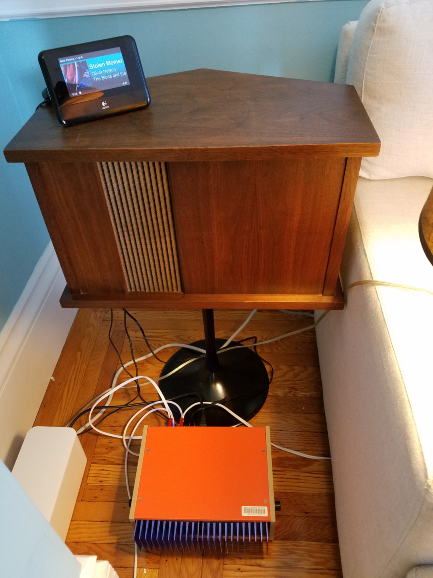

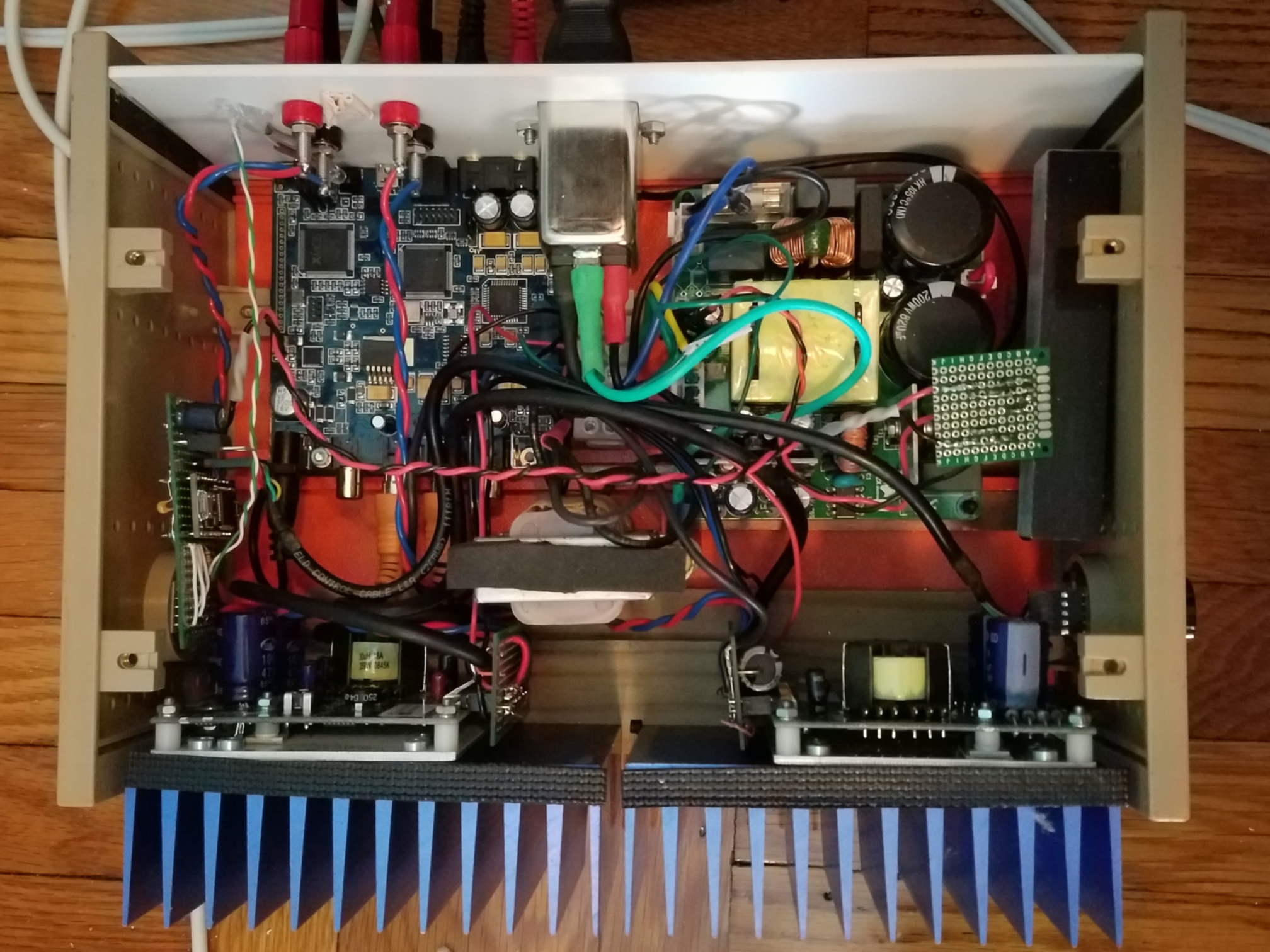

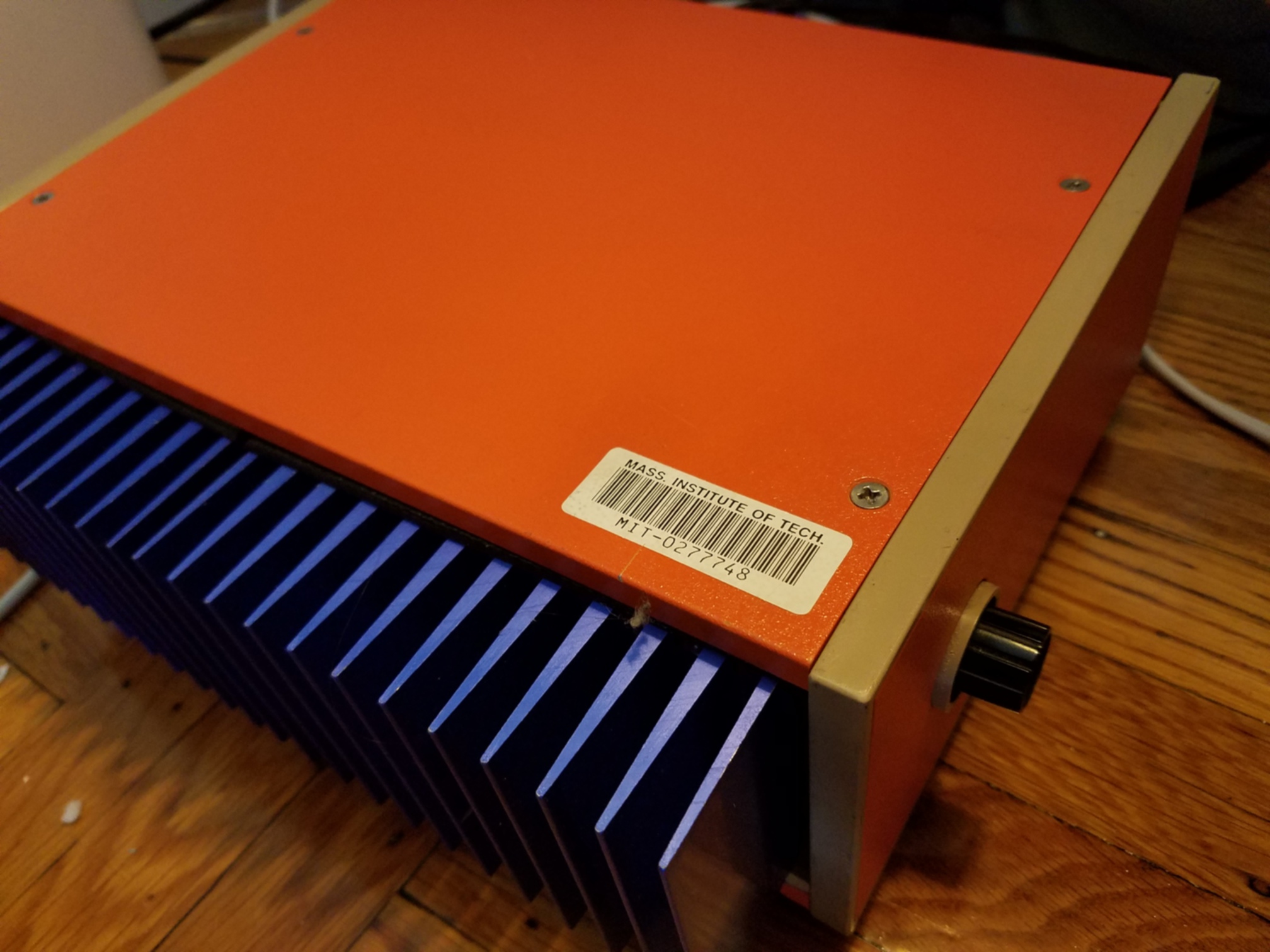

Here's my build with
- 2x Hypex UCD400oem
- SMPS400
- MiniDSP 2x4HD
Choke-filtered power to the UCDs just because my workbench is overflowing with spare Hammond chokes right now.
The MiniDSP implements EQ curves required by the speakers: Bose 901 Series II (1974-ish). And I think the orange/blue color scheme is good for a seventies retread, right?
MiniDSP doesn't currently have hardware volume or input-select, only software and infrared control, so there's a Teensy 3.1 providing these IR functions. It's controlled by two rotary hex encoders. The script is here:
https://gist.github.com/hughpyle/d4013d27f9b426fca082088b99b7288f
Power for the Teensy and the MiniDSP is derived from the SMPS400 "aux power", via 12v and 5v regulators.
Sounds mighty

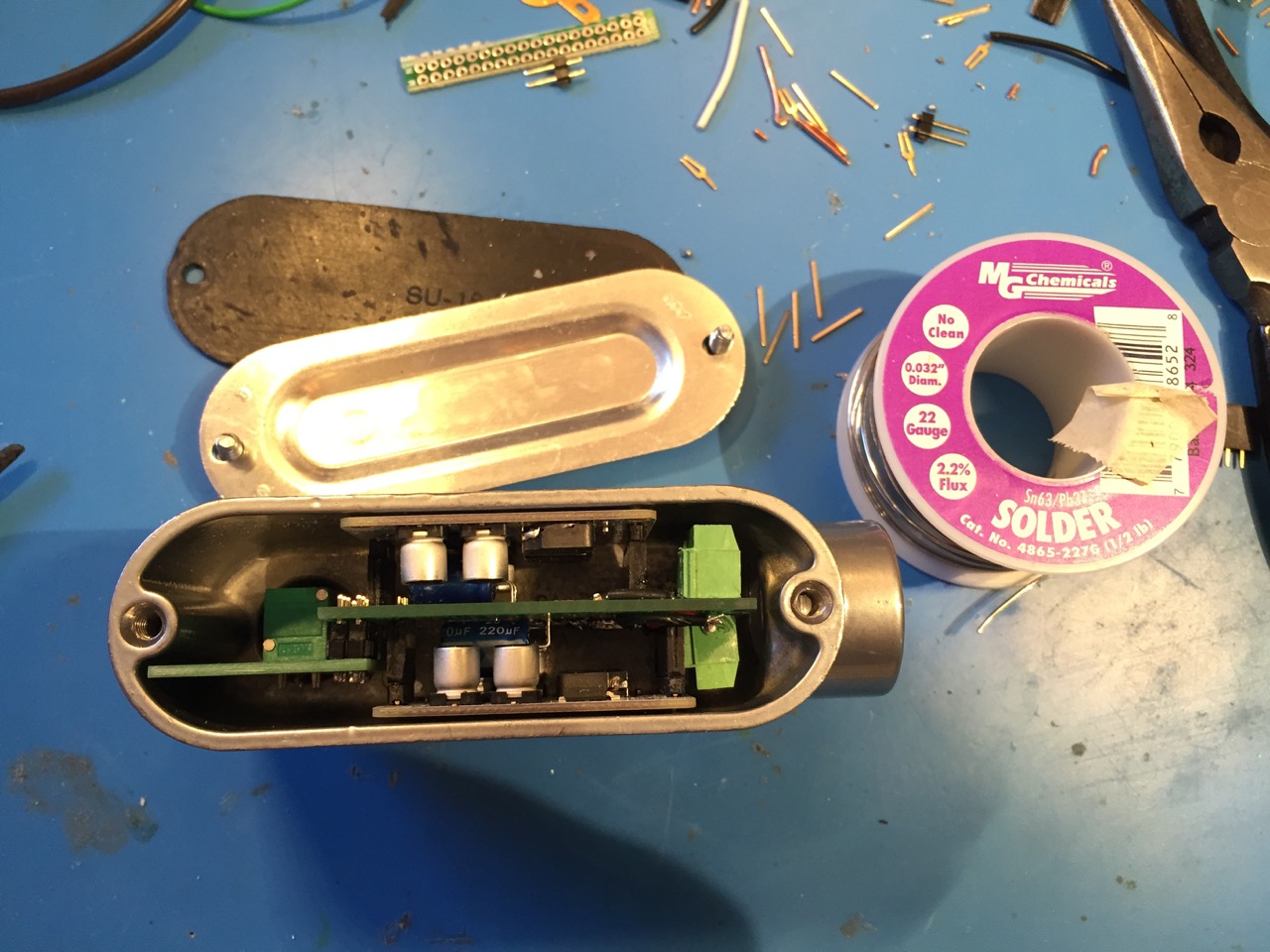

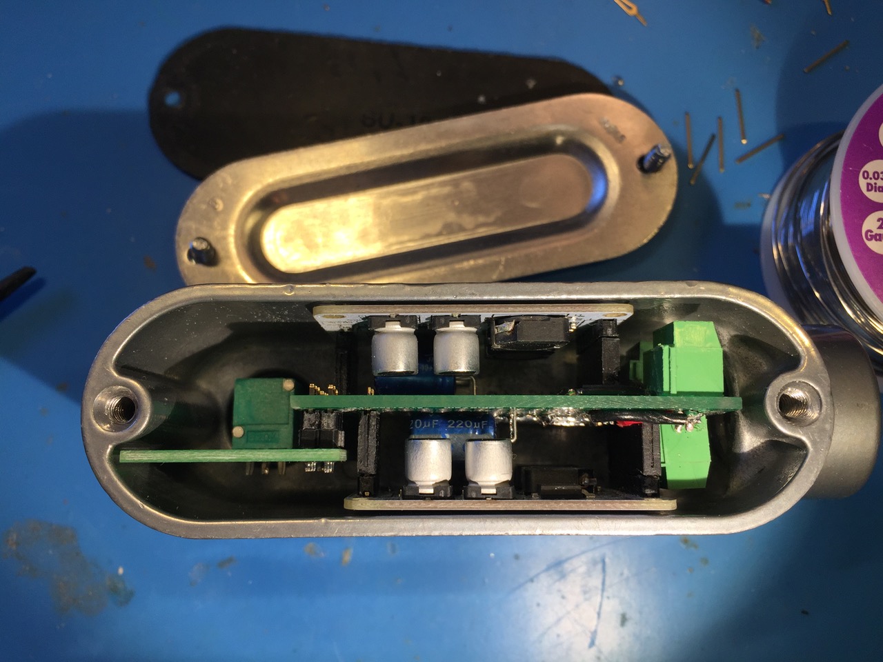

photo libreCramplifier, in progress.
I made a bunch of progress this weekend assembling a small, portable, amp using two white , knockoffs of the Sanwu PBTL TPA3110 boards.
I still have to add PCB terminals for the input, hook up the volume control, and make up pigtail cables for the inputs and outputs. Oh, and I'll probably need to rebuild it. I suspect that my routing choices are going to bite me.
