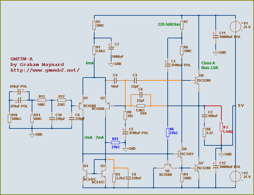

Graham Maynard 25 Watt Class-A JLH based amplifier
Hi, Greg Guru.
I am still not convinced enough to begin to replace
my Class-A discrete pre amplifiers and power amplifiers.
And if I will build myself a new pre/power amp ( in case I have ANY USE for another amp )
I certainly will go 100% Class-A, push-pull complementary or quasi-complementary.
Like for example Graham Maynard Class-A (based on work of JLH, John L. Hood ).
See my ATTACHED SCHEMATIC
This is in my Lineup Audio book,
how a good Audio Amplifier should be!
Audio Regards to Australia, all kangaroos and amplifierguru
lineup
More info, background and description at Graham Maynard
website
http://www.gmweb2.net/
Latest published version of GM25W Class-A is 2007-01-26
Cheers & have some bears. Russian Bear is great & big!

B.VDBOS skectch for biasing monolithic op amps class A wasn't too far off
I've acutally built a monolithic op amp headphone amp that is biased Class A for up to 400+ mA ~ 5W into 60 Ohms
http://www.head-fi.org/forums/showthread.php?p=2276512#post2276512
scroll around that thread for my (jcx) posts showing a rather extreme implementaiton
basic principle:
basic principle:
Class A IC-Chip op-amps do not exist.
At least not manufactured in any quantity and so commonly found for us.
To single end bias the output stage of one Class AB op-amp
will not give you one Class A op-amp.
Because the op-amp was designed & calculated for a specific output stage operation
= Symmetrical Class B / Class AB, in 90% of all known cases.
If you want Class A op-amp, you must go discrete.
There are plenty of discrete transistor operational amplifiers in Class A.
In fact, it is more The Rule than the exception.
all sorts of, JFET or BJT input, complementary or one LTP differential pair inputs.
Because when a good designer is left with the choice,
he will go Class A all the time, if there is no special thing against it.
And most often is not. Except for Power Op-Amps applications.

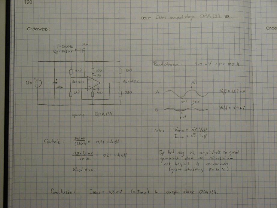

Measurement bias current final stage OPA134
I add a picture with this post, but I doubt whether it will be placed. What I did is measured the current in the positive and negative supply pins of the OPA134. The supply was +10.5V -10.5V. I used a harmonic signal of 200 Hz and 34.6mV effective voltage. The output was shorted with a resistance of 165Ohm.
I visualized the current through the supply pins with an oscilloscope. I increased the signal amplitude till the harmonic current signal in the supply pins begins to look distorted.
The maximal current (amplitude of harmonic current) turns out to be 0.3mA. So I conclude that the bias current in the final stage of the OPA134 is about 0.3 mA.
If you want to know more details, let me know.
The actually question must be follow: How much is the DC current (bias) through each stages?Hi everyone, Has anybody came across Class-A opamps?. Do they really exist.
Does there is a way in which a regular class-AB opamp could be converted to Class-A opamp. waiting for replies....... Regards, Kanwar
Most opamp datasheets offer only the whole DC current so as sometimes the spread aera. But most op-amps contain basically two voltage gain stages so as SE/PP-BUF (top quality opamps uses only one voltage gain stage - mostly as folded cascode like AD797 or OPA2604/2134).
I want to know the idle current of each stage.
BTW - each stage of all OP-Amps works always in pure class A (also the output stage), if the used AC/DC output current is below the quiescent current.
The idea from post #72 and #73 is very good (thank you therefore), but I would like it, when the manufacturer-datasheet would be offer accurate data in this matter.
