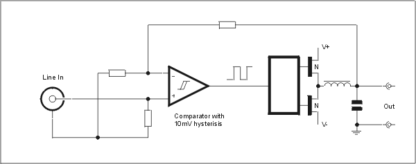

Hi Charles
Your description of my amplifier is mostly accurate.
I don't use a D-flip flop to control timing, since it would add rounding errors to my timing. (Quantization noise).
The topology that sigma-1 (one for you Guido T) people refer to as Class D, uses a triangular wave for input to the comparator. This allows for the comparator's CMRR (in dB) to be translated into harmonic distortion.
Assuming the comparator, operates at 0 mV on both input terminals, the CMRR can not translate into distortions, but only the noise will modulate with the amplified signal.
This is what i mean, in real life - depending on the type of comparator and integrator used - you may of course get HD anyway. That is why my claim is that
'SOME types of PWM amplifiers don't produce HD, but instead random noise'.

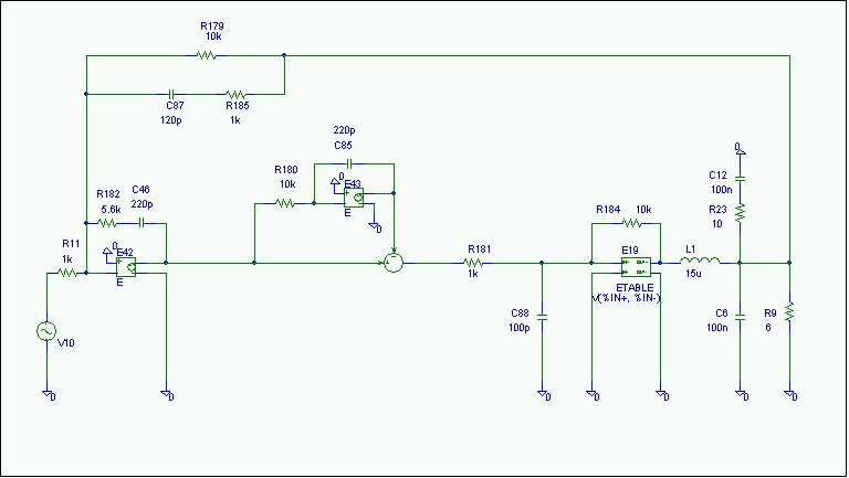

couldn't resist to simulate a self-oscillating switching amp with a double-integrator feedback loop.
I furthermore couldn't resist to take feedback from the output filter. So the first integrator is in fact a PID. I didn't fiddle around with the time-constants or gains very much. In fact when the thingie didn't want to oscillate after a few tries, I boldly added some hysteresis to the switching stage, although I know it schould be doable otherwise.
Anyway, the simulation results look quite promising.
Here is the circuit diagram.
