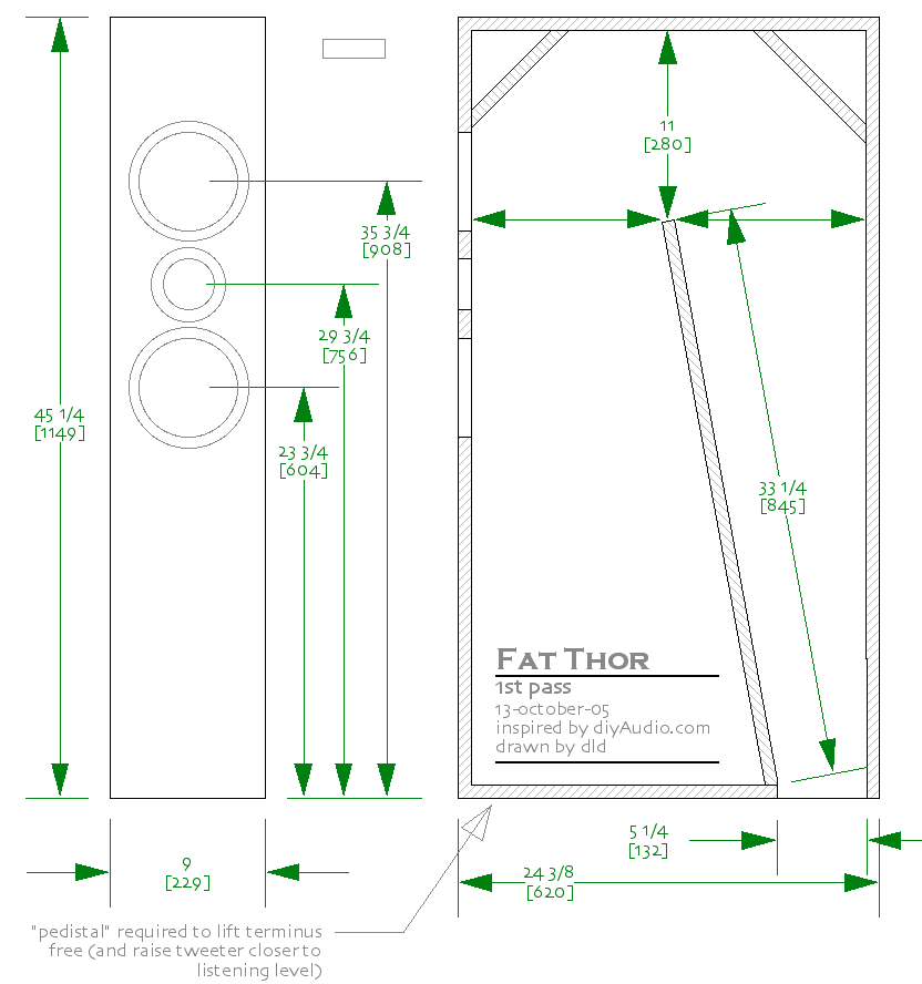

I wonder if some appropriate offset could be added, flip the box over (allowing a floor exit) and still get the drivers at an appropriate height?
quick & nasty -- 0.336 offset from Martin's tables... about 2.05 metre line ... ~690 mm from the bottom of (upside down) box, add 140 for the FatThor, and say another 50 for a stand to allow bottom exit -- 880 mm ~ 35" tweeter height.

1st pass plans for the "Fat Thor" inspired by this thread. There may be some room for further optimization (ie can it be a bit smaller?)
Twice the cross-section, drivers offset as per MJK tables for a 3:1 taper ratio, terminus out the bottom.

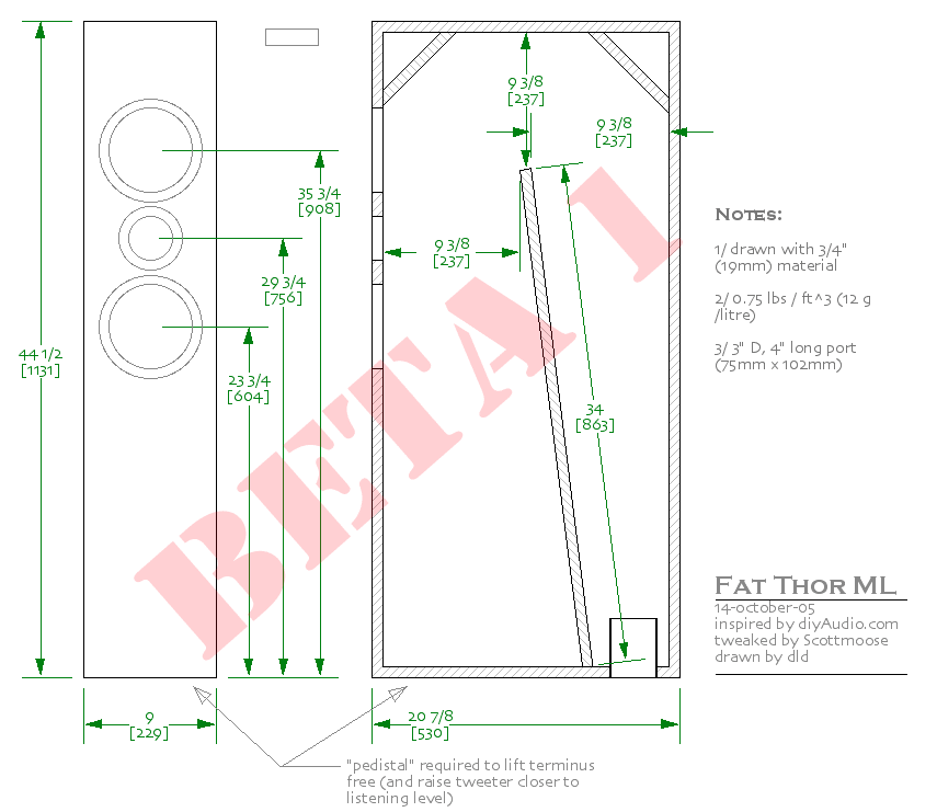

Okay, after playing around with the dimensions, here's my final offering for these drivers, based on Dave's FatThor:
Line length, geometry and driver positions remain as per the FatThor CAD drawing above.
So = 2.5 Sd (just under actually: 13.5"x7.5"). This will make for a cabinet that's around 3.25" shallower than the FatThor overall, which is useful, though it's never going to be a small cab!
Keep Sm as per Dave's diagram, which is an area of 1Sd. Now, mass-load the cabinet a la Martin's proceedure by installing a 3"x4" (WxL) port near the base of the rear panel (my choice), or on the base itself. Stuffing remains the same as the original Thor at 0.78 lbs to the cubic foot -these drivers in a TL of any type appear to need it, though you can reduce to taste if you don't mind sacrificing an increased level of ripple. As per usual, remember to add 6 db for the paralleled drivers, and remember to take baffle step loss into consideration.
These are big cabinets, but as they're built from MDF (potentially), they should be cheap enough to construct -there's nothing fancy about them, so I'd encourage any existing Thor owners to spend £30 on some more MDF and a couple of ports and rough up a pair of these, or the FatThor cabs I based them on that Dave has drawn. Either would be worth it, of that I'm sure, and both will do justice to these drivers.

Sorry if I wasn't clear. No, it means that the end furthest from the drivers is sealed, not open, but has a 3"x4" port in it, or just above. This is the mass-loading technique suggested by Martin -the constricted area and air-mass in the port provides additional loading to the quarter-waves in the cabinet. It's unusual to employ it with a traditional TL geometry, I admit, but not unknown.
Ouch. I didn't know MDF was so expensive over there an 8'x4' 3/4" sheet is circa £10 - £12 in the UK. My apologies. Then again, as these are hardly cheap drivers etc, I assume that few people on the average monthly wage would be able to build Thors? I know I can't afford them (at present...;-)!
I'm with Dave on the low-mounted port / vent. They couple better with the floor and room boundaries than high-mounted vents. It's quite an interesting effect I find: speakers with a vent high up often sound more strained than an otherwise identical design with it mounted lower down. Every little helps. And mounting it as Dave has done in his FatThor means it will drive the rooms vertical resonant mode too, which can give quite a clean and fast boost with fewer of the drawbacks to driving the horizontal mode -there's less in the way for example.

beta 1 attached. To keep the bend consistent, the partition is a bit longer & the box a bit shorter (18mm & 18mm). Once up on pedistals it is going to be even more imposing...

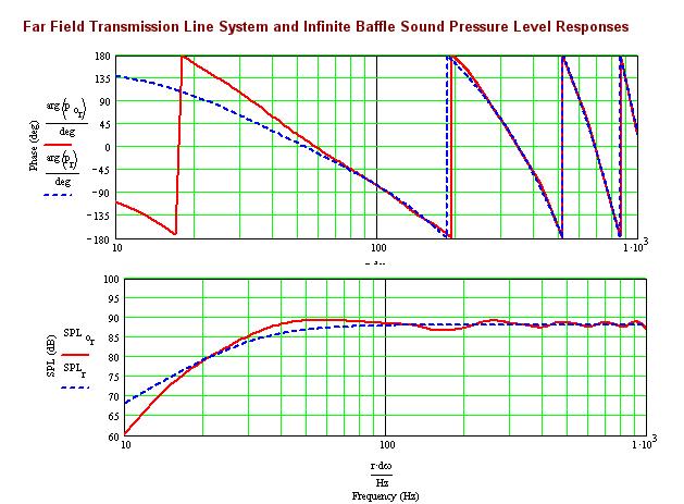

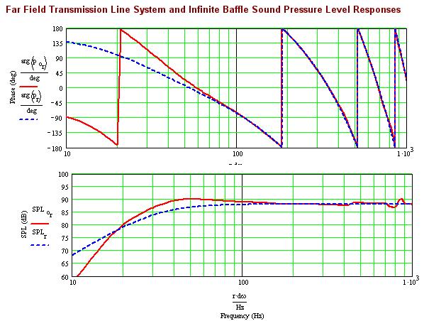

I said the above was my last -well, OK, I couldn't resist. Sorry Dave! Final thoughts: a straight pipe is at last possibly on. So & Sm = 3.5Sd. 45" pipe length. Tweeter centred at 0.35% pipe length from top. Vent is circular and 3"x6" (WxL). Close to a BR box, but not quite -it's still a TL. Stuffing density 0.5lbs to the cubic foot. Stuff from the top to the half-way mark, or just beyond.
The response is rising slightly below 100Hz -that isn't going to be too much of a problem however, and I doubt boom will be an issue, bacause we'll loose that rise through baffle-step loss. It should be pretty flat overall. And, it's a simple build. I prefer the response of the FatThor variations above frankly (love those drawings Dave, especially that last one!), but this isn't that bad either.

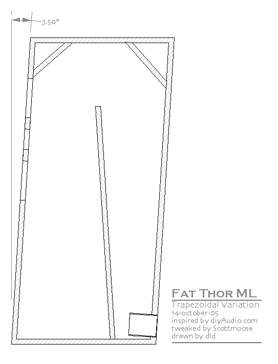

I though I would offer a few thoughts regarding the construction of these cabinets. The size of the baffles has me a little concerned. I think a significant amount of bracing should be included in the design. I recommend 1/2 in thick plywood that has been drilled out significantly to be mostly holes. I woould put this at the mid point across the front baffle for the top half of the cabinet then repeat it on the bottom half for the front section.
This brace could be easily cut out for the drivers to act as a driver brace as well.
I think Dave knows what I am suggesting, it worked very well on a set of WR125 bipoles I made. Perhaps Dave can comment.
Bracing is really going to be needed the more the better!
I also recommend 1.5 in or so legs off of a slightly oversized base if the bottom vent design is chosen.
I have built with a slight lay back angle, it is a little tricky but definitely worth the effort.
Hope this helps

Not in the middle!! It needs to be offset enuff that the 1st bending mode is killed instead of enhanced.
I wouldn't have built the thors without adding bracing. This box is bigger.
