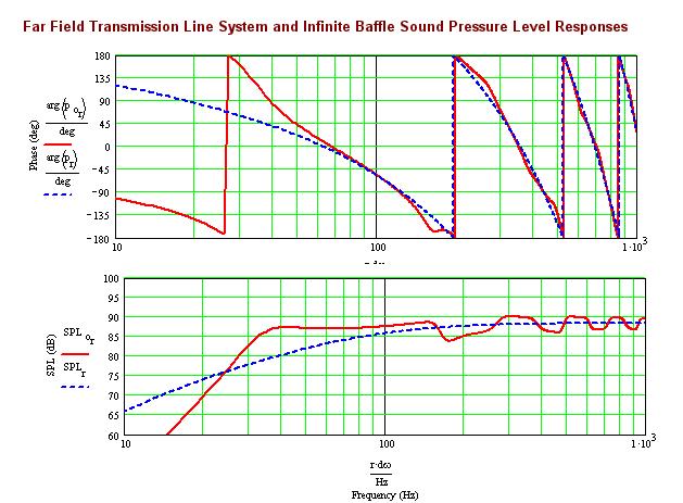

Compare the calculatued response plots in posts 13 and 57.
Post 13 - two drivers running together in the Thor enclosure. Rolled off bass as has been reported by a few people who have constructed the project. Also, closer to the SEAS measured response.
Post 57 - one driver running in the Thor enclosure. Nice deep flatter bass, closer to the measured plots presented in audioXpress.
Maybe both inputs are correct, calculations and measurements, for the conditions in which they were obtained. Unfortunately if this trail of logic is correct, the actual speaker response is closer to post 13 which is not that great for a TL enclosure.

It does look like this is the cause of the discrepency in measurements... putting too much driver in too small a TL decreases the bass.
Now someone needs to build a FatThor.
