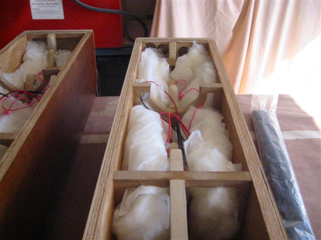

It appears he has used carpet pad for sound insulation.....hmmmm.........concidering the cost of the drivers and the price of labor involved, I'm not sure it's a good combination. The carpet pad is VERY dense and will absorb quite a bit of cabinet resonance (perhaps too much) and it takes up precious interior volume from the speaker. As to how to hold up the "stuffing", if you use long haired wool as I did, or polyfill (pillow stuffing) you could :
Hot melt glue it to the sides
Staple gun it to the insides
Use insulation "stabs" (stiff wire held in place like spring steel)
Use carpenters glue (lay cabinet on side while drying)
or use horizontal shelving for bracing support like I did.
You'll find a way that works for you.
Ron

I'm sure I'll do. :)
Spec says filling of 8 grams/liter. I got Dacron filling at 7 grams and sheeps wool at 9 grams so it'll be 50/50.
That's doing it by the numbers, folks! :D
The MDF is cut and ready, so I'll start putting it together tomorrow.
Thanks again for all support so far. :)

Speaking of MDF: Do you guys nail&glue, screw&glue, plug&glue...or just glue? :)
That MDF sure makes a dusty mess, we were cleaning up afterwards for weeks. Wife has banished my MDF cut to outside the garage from now on.
Your baffles look good, nice holes. Reminds me of "Whack-a-Mole":smash: ;)
For cabinet layup I used (with good results) Titebond 3 waterproof wood glue with 5/8" & 1" pin nails to hold things while the glue set overnight. Lots & Lots of clamps too. Mine were roundish so I had to use ratcheting straps on the curved parts. Use lots of glue and a moist to wet rag to clean up the mess when it ooses out. I think the glue bonds best with ~15lbs of pressure until set. Yours may be different.
As far as the Router Jig goes, Madisound will ship you one. Make sure it fits your router. Some don't and you'll end up redrilling your router base, Which is OK if you don't mind the extra work.
Keep us informed.....looking good.....thanks for the pics.

KarlXII said:
I just looked at greenie512's nice smallThors. They look great!
But one thing puzzles me: He seems to have added some kind of stuffing along all sides of the inside walls.
Karl - the underlay lining is just a habit I have. No scientific reason - just a feel good factor - for me.
