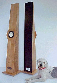

Circular Baffle for Voigt Pipes?
still sounding great...
I like the Decware modified FE206 drivers in a Voigt Pipe very much, they seem like a pretty good match with my K502 tube amp. The highs are plenty well rounded, the pipes seem plenty bright, and I don't feel the need to add a supertweeter at all. They sound pretty good off axis too, you dont have to be right at the sweet spot. They do have a tall soundstage, and a little wider than the speakers, with plenty of depth and separation. Some people have said they sound similar to electrostatics in some regards and I think thats a good comparison too. With a tube amp many instruments sound very real & live, especially piano, guitar, violins, cymbals and most voices too. Bass is pretty acceptable for much music, I havent really listened to much hard rock but they handle louder volumes well. I plan on testing the sound soon by varying the amount of stuffing inside and comparing various speaker wires - currently I am using RS magnet wire, and will test some Vampire CCC magnet wire next.
A round baffle is probably the absolute worst shape to use (like the centered little fostex's in the cane&cane ). :bigeyes: If it is mounted near the the center of the circle like the the above simple physics will tell you using a circular baffle is is a sure fire way to a sonic disaster.
If you do this anywayto spite the warning be sure and use a big baffle(maybe a baffle 30" or more in diameter to get some real gain) and offset the driver from the center by quite a bit.

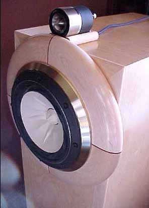

1st off, it is quite misleading calling Terry's baffle pod a circular baffle... it in in fact an oblate spheroid.
As Olson has shown, a sphere is a very good shape for diffraction effects. Collapse that into a 2 dimensional shape -- the circular baffle -- and it becomes one of the worst. An oblate spheroid is somewhere in between.
Without hearing Terry's speakers you cannot grok the amount of effort that has gone into getting a shape that works.

That fits my intention accurately. The width of the baffle is actually the center of the driver to whatever point you think it matters. That being a receding and negatively curved surface leaves only specualtion.
Adding mass, ridgidity and improving aesthetics were also high on the list. And departs from a -box-, something I myself, find great entertainment in.

The speakers are called Cain and Cain
planet10 said:
Huh... don't know what you are trying to show -- the picture isn't showing up -- but the shape i'm thinking of is only a circle is you laid the speaker on its back and did a cartoon drive-over with a steam roller.
dave
The circular baffle shows up fine with my PC.
http://www.enjoythemusic.com/magazine/equipment/0103/caincain1.jpg
The original poster also recognizes the baffle being circular. You seem to be one that doesn't see it.. The edges would need to be rounded at a 4" radius for the circular baffle to little edge effect. That is just a another problem with the TC speaker. You already identified another when you referred to Olson - the speaker is centered in a circular baffle. This will cause pronounced audible and measurable problems. - I think that's one reason why we don't see any measurments from this manufacture.
On another note I do however like the way it looks - but ..........

Yes, no doubt there are multiple problems here. The drivers. the circular baffle, and the edge effect from the entire front baffle.
These aren't open baffles, a speaker need not be open in back for the shape and size of the baffle to mangle the sound.

The point I'm trying to make is that the overall cabinet shape matters, not just the baffle shape.
For example, as has been mentioned, a sphere is a good shape to smoother response, as is an ovoid. A cylinder with the drivers in the circular end is about the worst. A rectangular prism isn't as bad as it looks....
From my point of view, the C & C speakers are a complicated shape. Yes they have a circular baffle around the driver, but there is a rectangular prism cabinet behind the baffle. There is the area on the front where there is no circular baffle, but just the front of the rectangular cabinet. There is the situation where the front of the cabinet is in contact with the floor- at this point the baffle is effectively very large. The driver isn't a tweeter, it is full range, so at higher frequencies might act as a tweeter in a waveguide (the tweeter being the whizzer cone or the part of the cone close to the voicecoil, the iwaveguide being the outer part of the cone. In this case the "tweeter" is recessed and inch or so into a cone shaped waveguide, NOT flush with the fron baffle. So the point is that IMHO it is overly simplistic of you to claim something similar to "the driver is in the center of a circular baffle so its bad"
