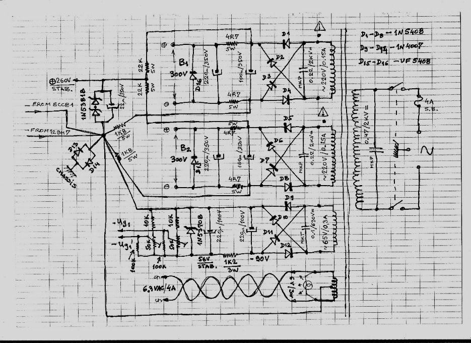

Hi Tinitus !
Just think that combination of ecc81 / 12bh7 will be better one .
Here is my proposed PSU schematic for your Circlotron Amp :
In this PSU configuration output power autotransformer CT dont have to be grounded at all , since all start/returnig low level DC current now pass trough two equal 1,8K/5w ground reference resistors , not anymore trough autoformer coil , with perfect equal biased output EL34 power tube in Circlotron output power bridge there will be now real 0 mA passing trough output autoformer coil under no signal condition .
Best Regards !

Well you can swap ecc81 with ecc82 anytime when you want and to listen the sonic difference ,since the tube pins arrangement is the same for both tubes , final choice will be personal choice of your ears , regardless to the some tube datasheet specs .
BTW in that Circlotron PSU schematic I forgot to scratch the PT electrostatic shield between primary and secondary coil , this shield have to be connected on the same main PSU ground star point .
Best Regards !

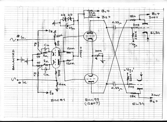

HI Tinitus !
Nothing against Mr.Pass BA-3 pre/driver ( SS single ended to balanced converter ) but in my attached schematic for SE operation it is enough to tie ecc81 (-) input via suitable switch or jumper to ground , since tube Ecc99 is allredy differencial amp (or phase splitter) .
Best Regards !
Best Regards !

Hi again !
My personal opinion is that tube 6c19n is not good for driver stage for many legitime reason , one of the reason is very variable tubes mutual characteristic .
BTW
If you have pre with relative high gain than you can discard first input stage tube ecc81 , balanced inputs will be connected than to grids of diff. driver stage tube ecc99 , some minor driver circuit modification is needed than for that amp configuration .
BTW

1) You have doubt of right performance for that BA-3 pre
2)You have problem to get components for that DIY BA-3 pre
1+2 = Maybe you need to just forget that BA-3 for DIY and implementation for this Circlotron project , sweet old tubes sounds much better than SS anyway
GU50 is just one perfect power tube in many ways , for this simple Circlotron power Amp design Ra is not the problem since you want GU50 to be connected pseudo-triode , but is limited G2 voltage/disipation and 12,6V filament supply .
I suggest you to stick with EL34 audio tube .
Anyway I well send you later modified schematic for Circlotron Amp with only one Ecc99 and 2x EL34 for your SS BA-3 high gain PreAmp .
