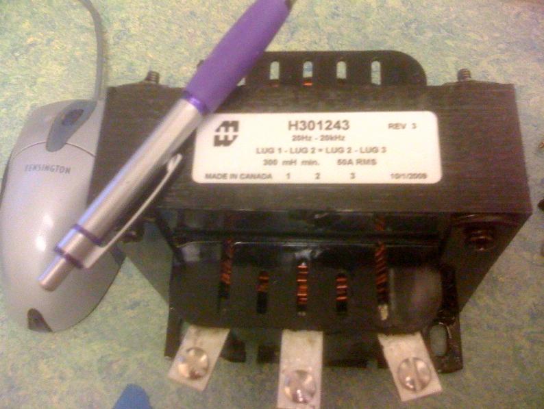

Hi Carpenter!I have some very nice custom, bifilar wound chokes manufactured by Hammond. They're rated at 300mH/50amp. DCR is extremely low: 0.018 ohms.
Could you show a picture about it?
I can't believe this specs! 300mH/50A with 0.018ohm DCR???

Hi Carpenter!
Tyimo
Here she is at about 14 lb or so:

Thanks Carpenter!
I am realy sorry, but I don't believe that such a small choke can operate with 50A RMS. Even not on 10A!
Its mean ca. 70A! As I seen the wire is too thin and the iron is too small. It will saturate soon. Heve you ever tested this Choke?? Has it enough airgap??
Tyimo
