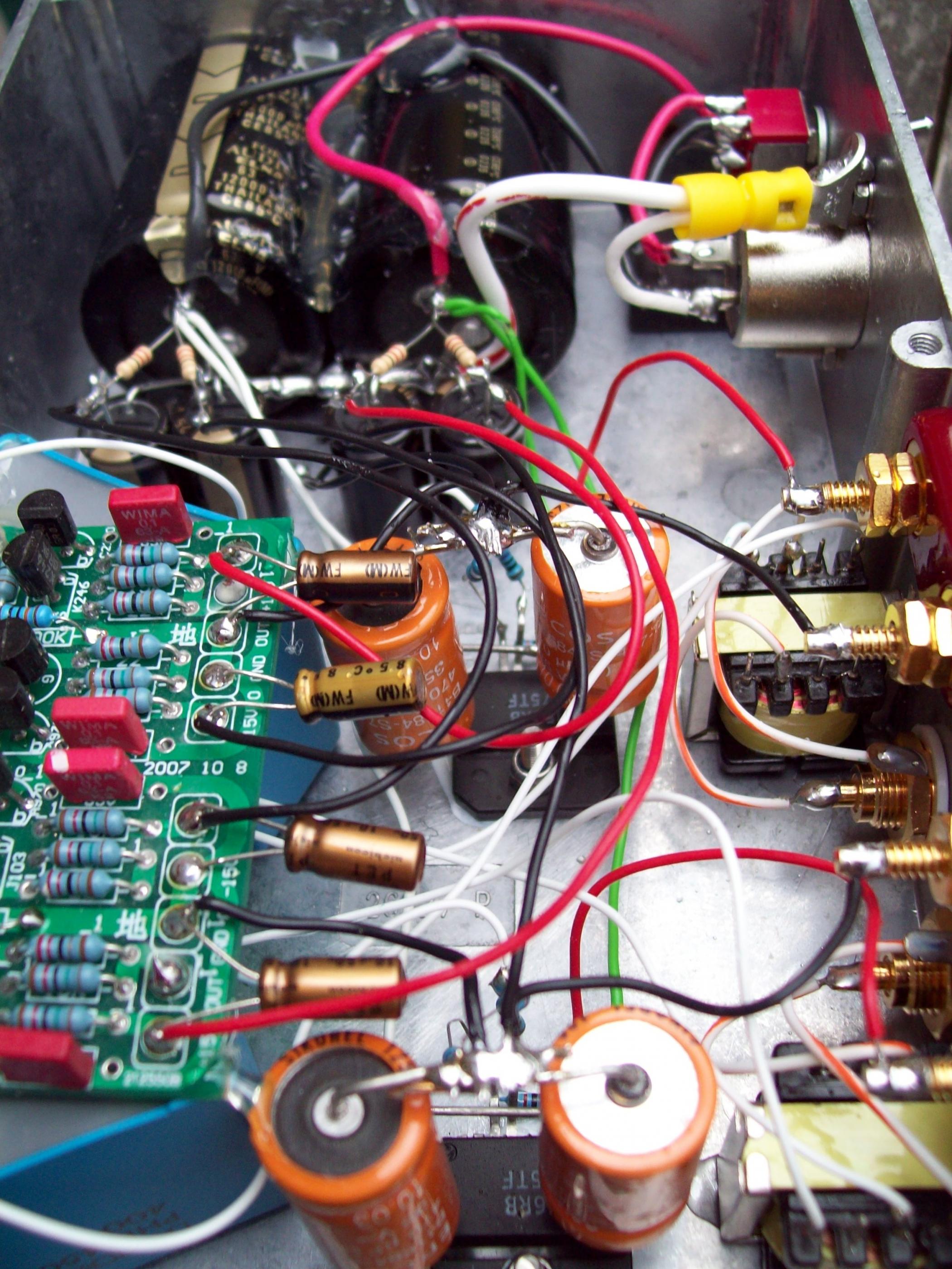

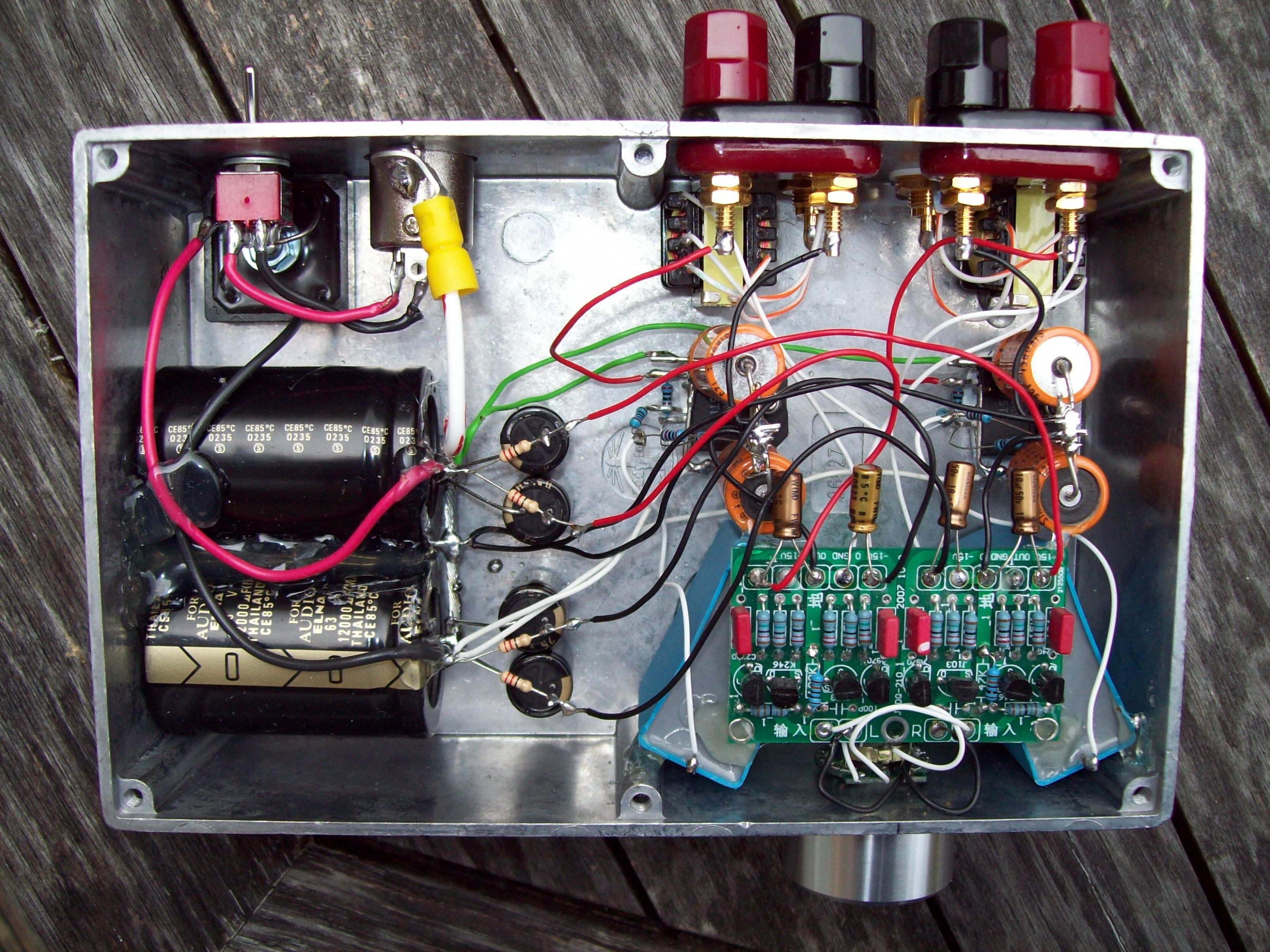

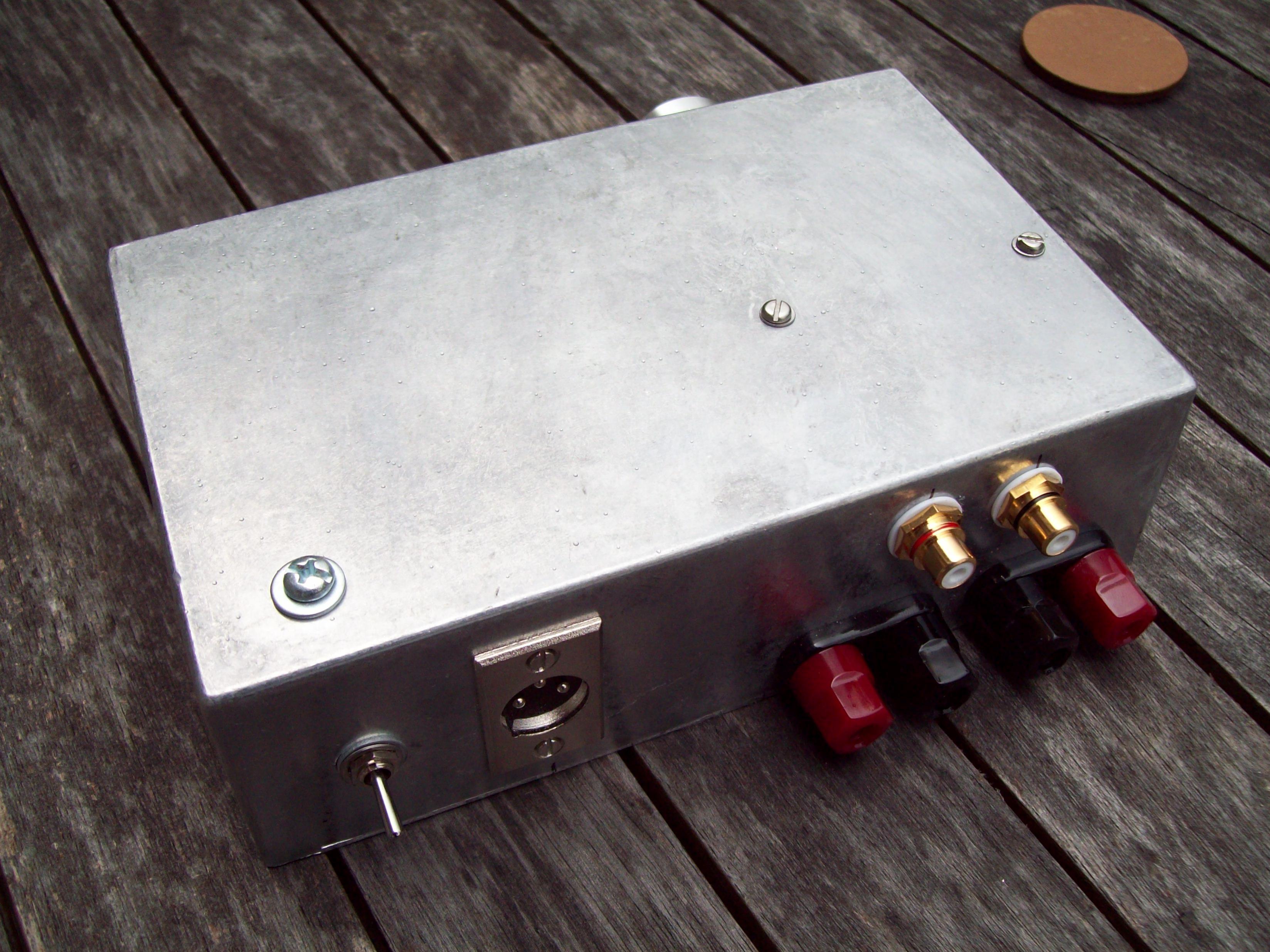

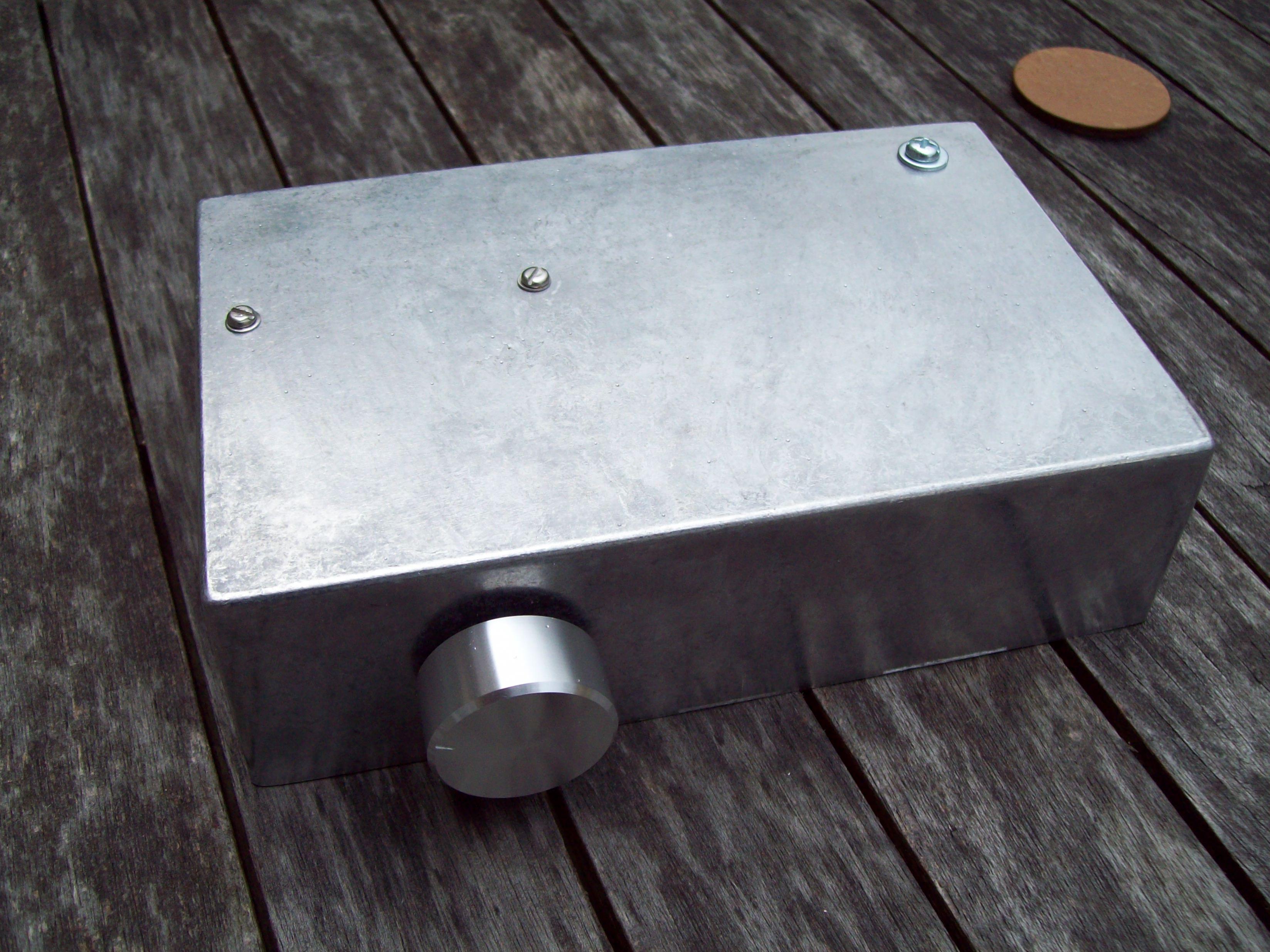

Buffered LM3875 mini amplifier
I made this amp for my desk at work. Input runs through monocor LTR-110 transformers to 50K smd attenuator, then a FET buffer board from ebay before the LM3875s. The input transformers are there because the amp will be used to test audio content on different laptops & other sources, and this solves the ground loop & noise issues you often get with laptops etc.
