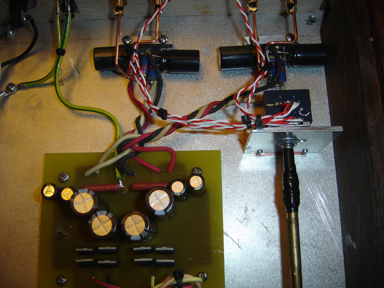

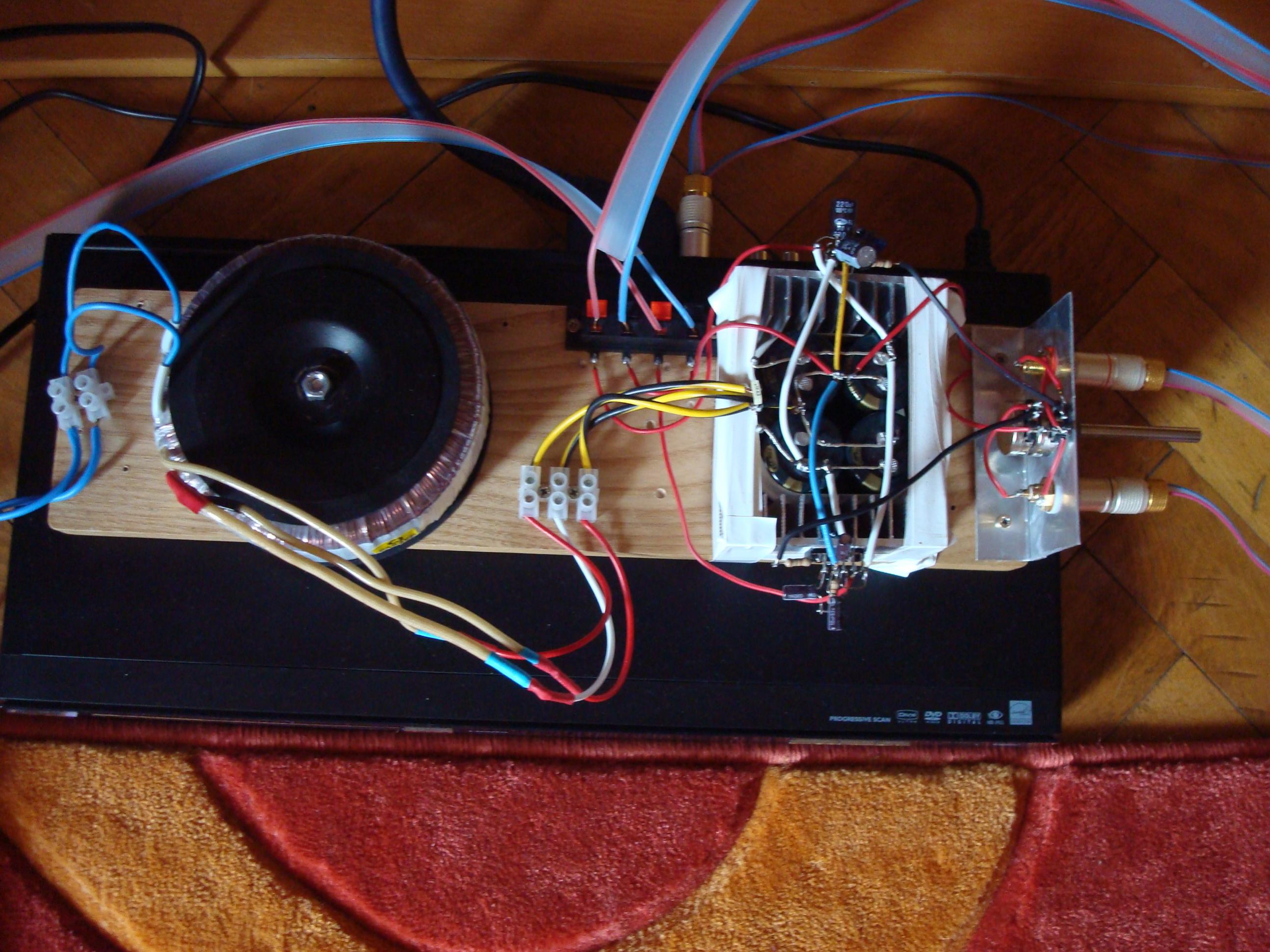

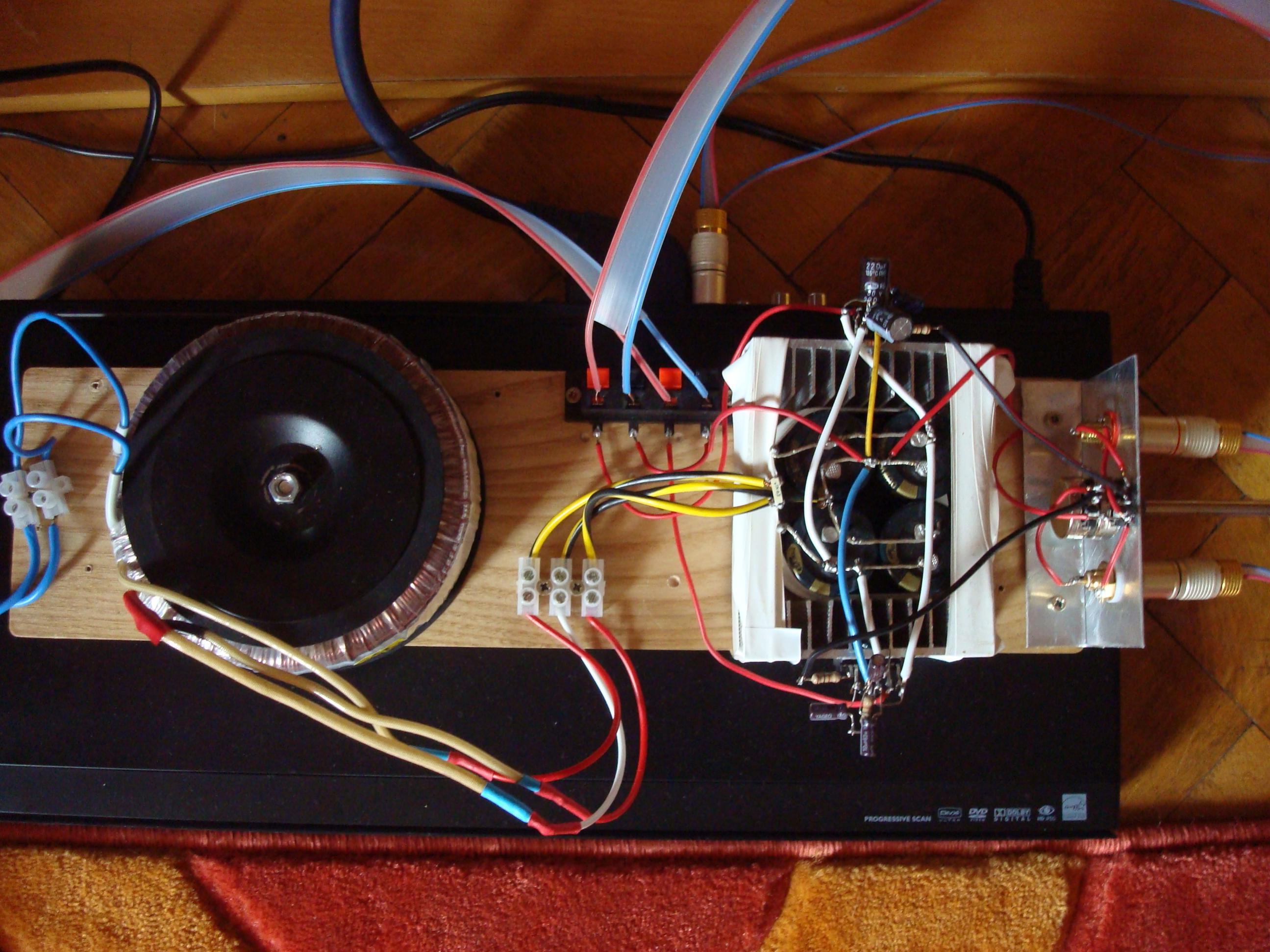

I understand perfectly your points of view, guys, because I was also worried about heat and that's why I performed the tests. 10W are WAY too loud for my ears. The heatsink will be moved outside for sure, but in the future. I lack some tools for wood work and I'm too lazy to go buy them.

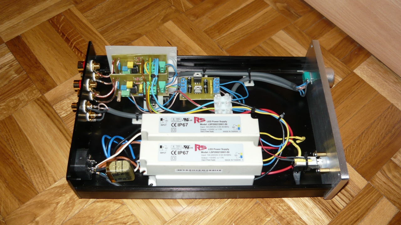

LM1875 with DC servo
I bought this case on e-bay, cost about 50€. Currently there is SMPS psu but I'm thinking to put in 80VA transformer with snubber, I have to decide in near future.
Regards Aleš
p.s. Also the wiring needs to be re-done.

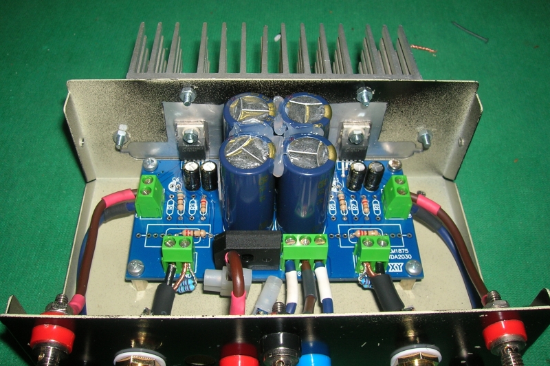

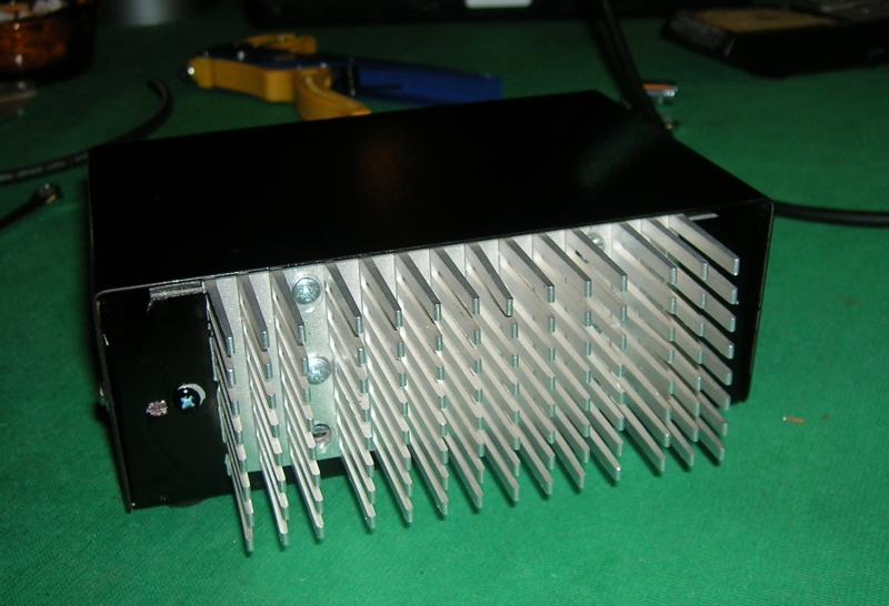

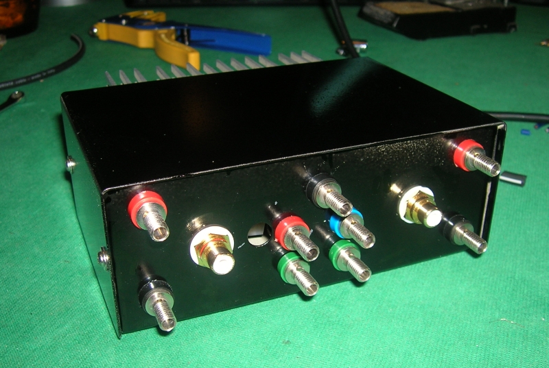

Minimal LM1875 with chinese eBay board
My latter chipamp, fitting into a parallel switch case..
no caps into signal path nor feedback,
and external connection for AC or DC power supply

saying the truth, it came from an ancient Celeron (Slot A) 300MHz..
(cooling enough for this 2xLM1875, but not enough for my former 2xLM3886 :( )

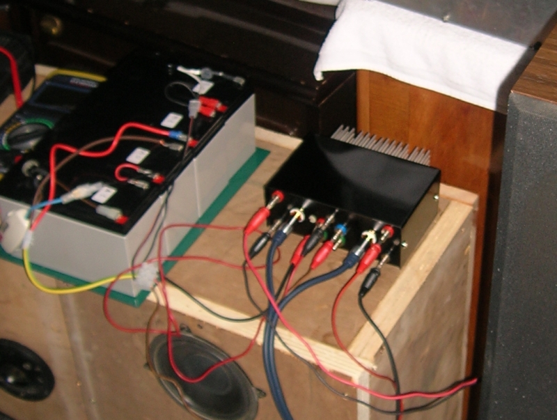

former photos showed you a no-cost recycling experiment, taking speakers and xover from an unused car audio setup.. :cool:

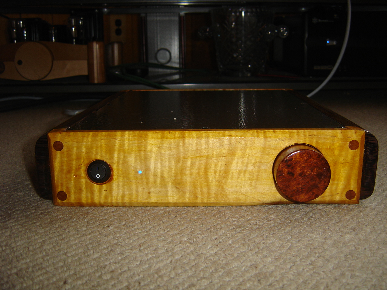

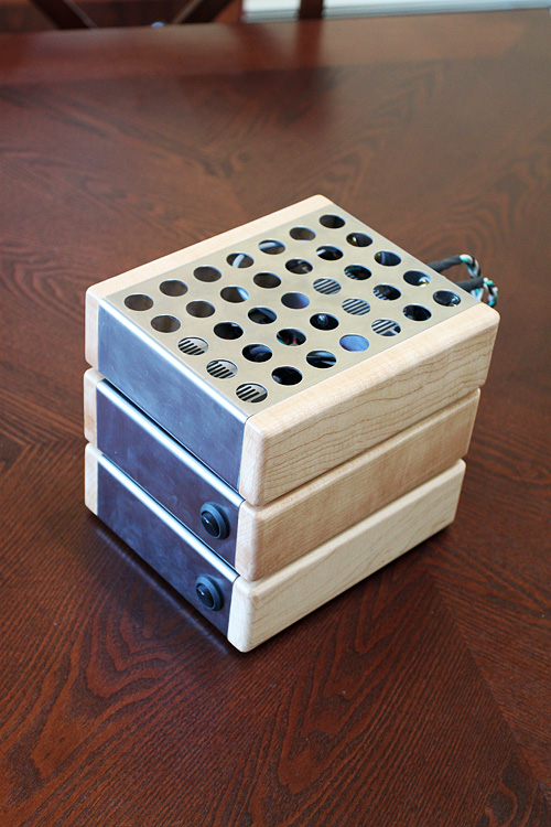

My new 3875T Chipamp

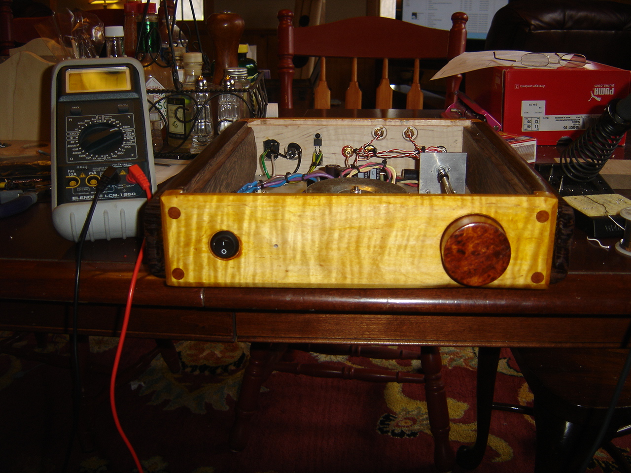

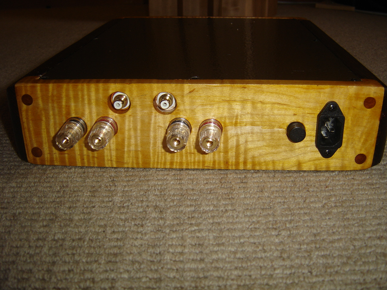

While I was waiting for some OPT's to arrive for another project, I decided to revisit my little chip amp and redo it. I built the orginal version about 8 years ago. Since then I have learned alot and decided to rebuild it into the form you see.
The LM3875 is operated in inverted mode and has +/- 25V rails with 4500uF on each rail. 1000uF of it is right at the chip. Had some HexFred diodes laying around so I threw them in as well. To put the mandatory Blue LED needed for a chip amp I wound an extra coil on the tranny. Used 8 wraps to get enough juice to light it properly.
The bottom plate is 1/2" thick aluminum plate. The chip is clamped to the plate and insulated with a mica insulator. Pretty pleased for a weekend worth of work to keep me out of trouble.
While it doesn't sound like my 300bSET it does sound good. Solid bass and good detail. Good enough to go to college with my son.
I have some spikes for feet to allow air to flow underneath, but need to get a M6-1 tap on Monday
