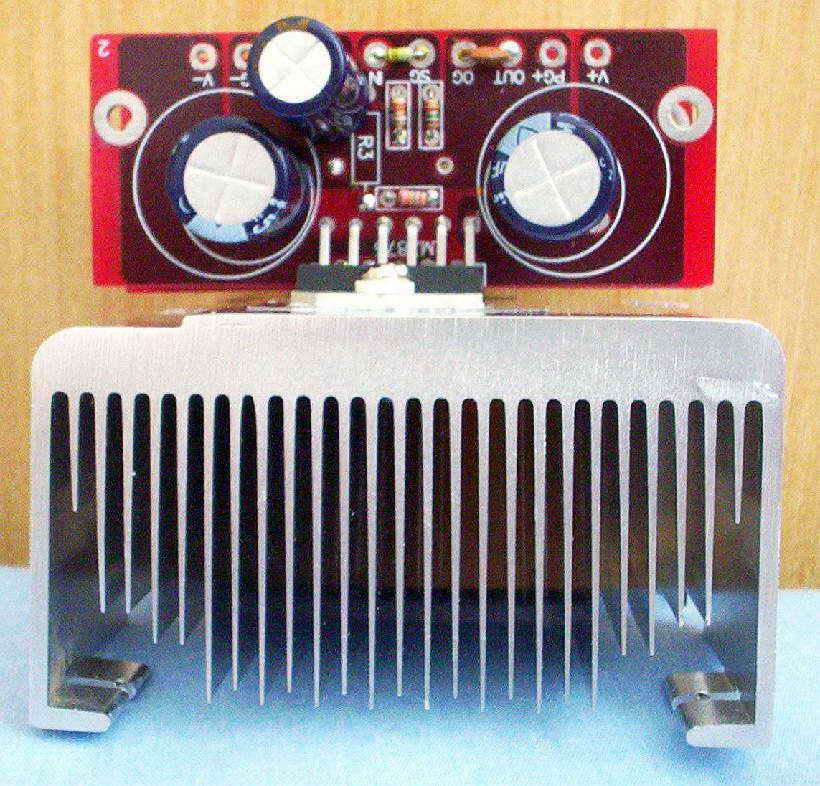

A couple of years ago i have assembled this one
And the unit sounded very good, gave me a lot of good moments listening to it.

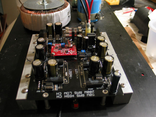

this is a pic of my amp since its finally 99% finished. finished building the crossover and tested it lastnite, at first it worked horrible, i couldnt figure out why but the level dropped off at 500Hz or so on the woofer. finally discovered i installed 10nf caps where i had ment to put 10UF caps. and instead planned on jumpering it. after jumpering the pads i had a flat response to 20Hz with a slight dropoff below it
tweeter is crossed at 1500Hz as per orignal spec. these will be bolted into the 1977 powered advents in restoring.

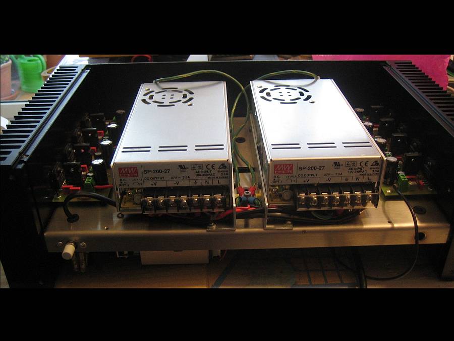

Thanks Lineup I think you have the same philosophy. First I was thinking about building a tube amp. But then I said to myself that the weekest part in the whole chain will be the loudspeaker. So what can you do to improve the performance of a loudspeaker?
I decided to go active with a 3 way "Gainclone" based amplifier. In the lower part of the case I am using the DSP Board from the DCX2496. That means I can control the crossover via RS232 from my notebook. The main reason to use a digital crossover: you can align the phase between high, mid and bass speakers and it is easy to make corrections depending on the room. It makes sense to use a digital input and to stay in the digital domain when you are using a digital crossover. In my system I have from the spdif input to the loudspeaker only one capacitor. I have spent allot of time to reduce the noise as far as possible. So I finaly changed my PCB design and used switch mode Power Supplys.
Here is a picture of the new design:

bridge-parrelle for the woofer amp actaully.
the crossover has 2 diff boards the one in the picture is a 12db\octave linkwitz riley. i also have a 24db/octave linkwitz riley.
the 12db one is for the advents, while i made the 24db ones for other speakers.
the boards can also be used without the crossover.

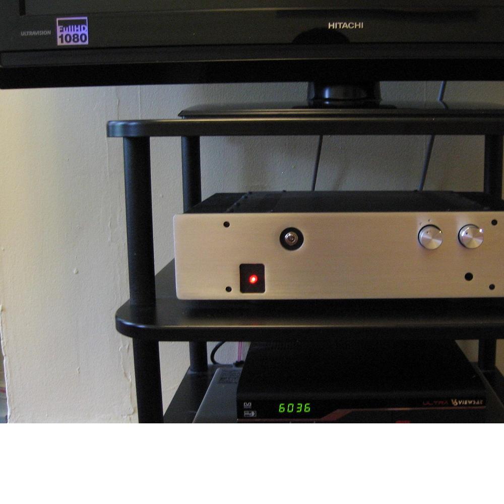

Noxon
Hello there! Well I just got a good product to clean and polish those wonderful aluminum chassis,the name is "NOXON" 7 metal polish.stainless steel,aluminum,chrome,pewter,brass,bronze and copper.it costs around $7 12fl.oz (354ml).I have used it in my integrated amp and it looks great now.take a look!.:smash:
